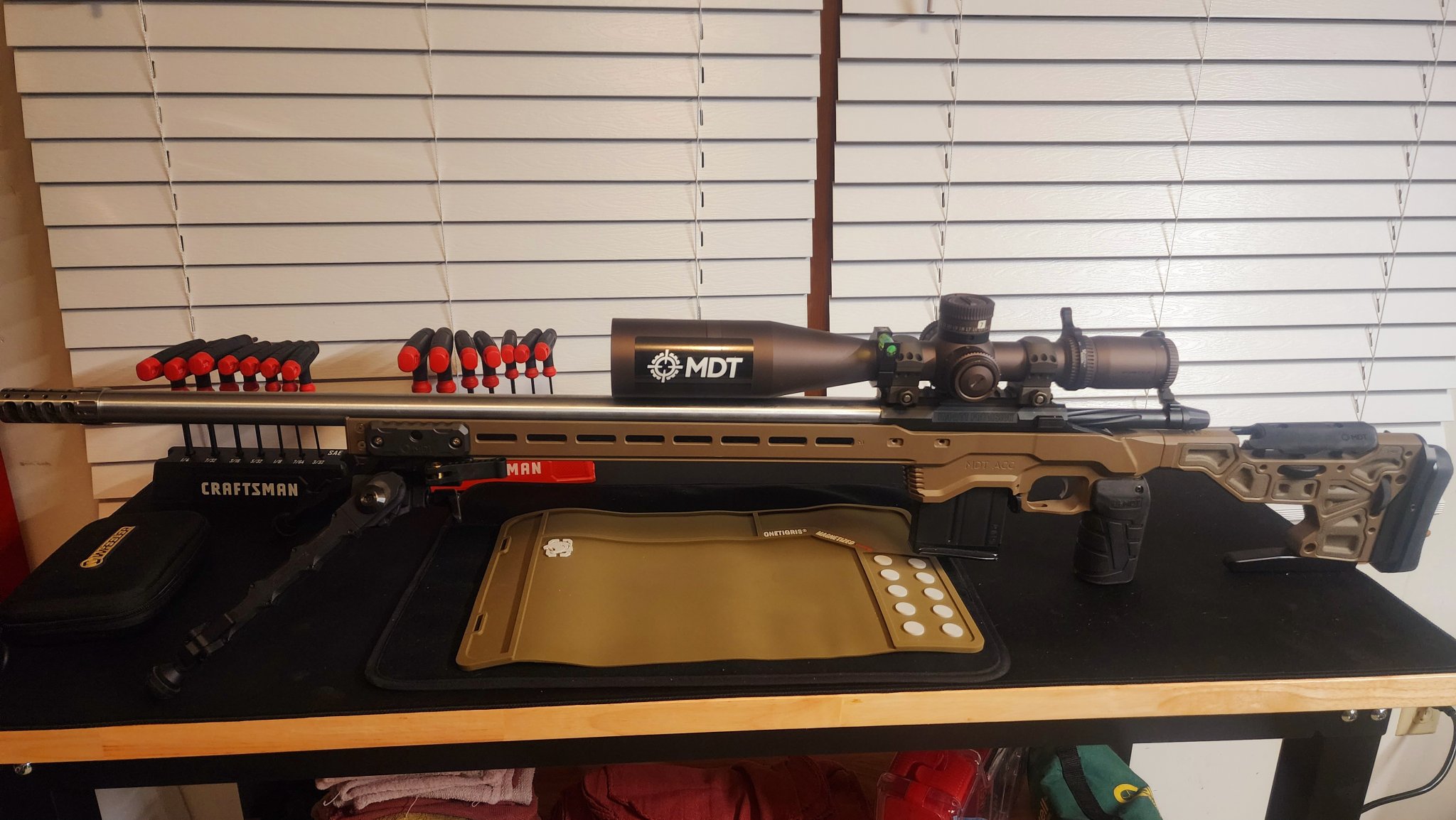

Today I changed out a barrel on a Impact Precision 737R with a new Proof Stainless 6 GT barrel. After torqueing the barrel to the action to 75 ft. lbs. I put a
Manson Go gauge in the chamber and closed the bolt. No problem. I then put the No-Go gauge in and the bolt closed easily. Problem! I put a .0015" piece of Scotch tape on the back of the No-Go gauge and the bolt would not close. I didn't force it, but there was resistance on the bolt handle. I then took the Go gauge and put 2 layers of Scotch tape (.003") on it. The bolt closed easily. When I added a third layer of Scotch tape (.0045") the bolt again would not close. I'm taking this to mean that I have approximately .004" of excess headspace.
I'm new to swapping prefit shouldered barrels. My question is, is this a problem?
I have not fired the barrel yet, but am thinking about it. I can call the gunshop where I purchased the barrel, but since it's Saturday, I guessing I won't be able to call Proof until Monday. What should I do, shoot it or return it?
TIA
Nimrodmar10

6GT's HS is 1.364" - .007". That means max headspace per SAAMI is 1.364" measured at the datum line (.375"). The Go gage should measure 1.357" and No-Go should measure 1.361". If you chambers measures smaller than 1.364" (which it sounds like it does) it is within SAAMI specification. Again, prefit only means it will meet maximum specification.
That may be my problem. My Manson Go gauge measures 1.3555". The Manson No-Go gauge measures 1.3585". The Scotch tape I used measures. 0015". With one layer on the No-Go gauge, the bolt would not close. So my chamber measures ~1.360" max.
Thanks for the help. I'll contact Manson Reamers tomorrow for reference, and I'll contact Proof for confirmation.
I intend to start breaking in the barrel tomorrow, along with a new 22 Creedmoor.
It's built on an Impact Precision 737R also, with a Stuteville Precision 20" Bartlien Carbon Fiber barrel, a Triggertech Diamond Trigger. It's on a loaner stock right now, but I intend to put it on a MDT Carbon Fiber stock.
