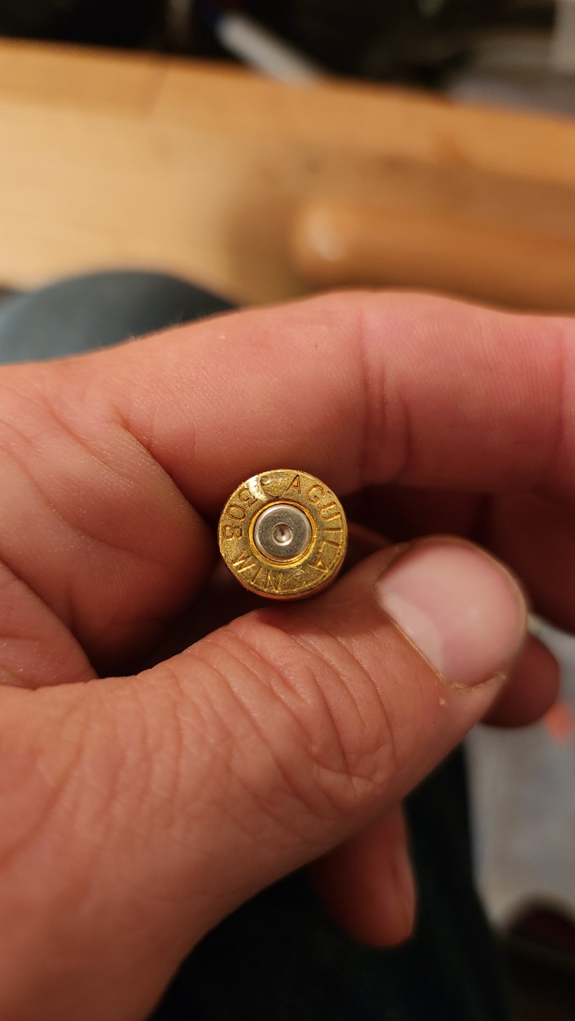

I am currently running a 20" Wilson Super Sniper in 308 Win lately. It been amazing and is absurdly accurate. I also shoot a Seekins PWS MK218 which is another excellent rifle. Something I have noticed with both as I develop loads for them: Even factory 147 gr FMJ tend to have substantial ejector swipes and flattened primers. I was running Aguila today and all the casing are non-reloadable due to ejector peel marks, from both rifles. I tried some handloads I was working up for a bolt gun, a minimum charge of Varget, same thing. Is this a common issue with AR10s? I will admit I do not shoot mine often, its usually a 300blk or one of my bolt action rifles. It seems a waste of good brass.

Here is the Aguila 147s
Assuming the case damage is rough treatment of the brass due to the gas system, and not actual pressure signs, run the case head across a file to knock down the burr and reload the brass.
As noted above, you can mitigate the worst of it with gas system tuning (gas block, buffer weight, buffer spring), but AR10s are harder on brass than bolt guns.

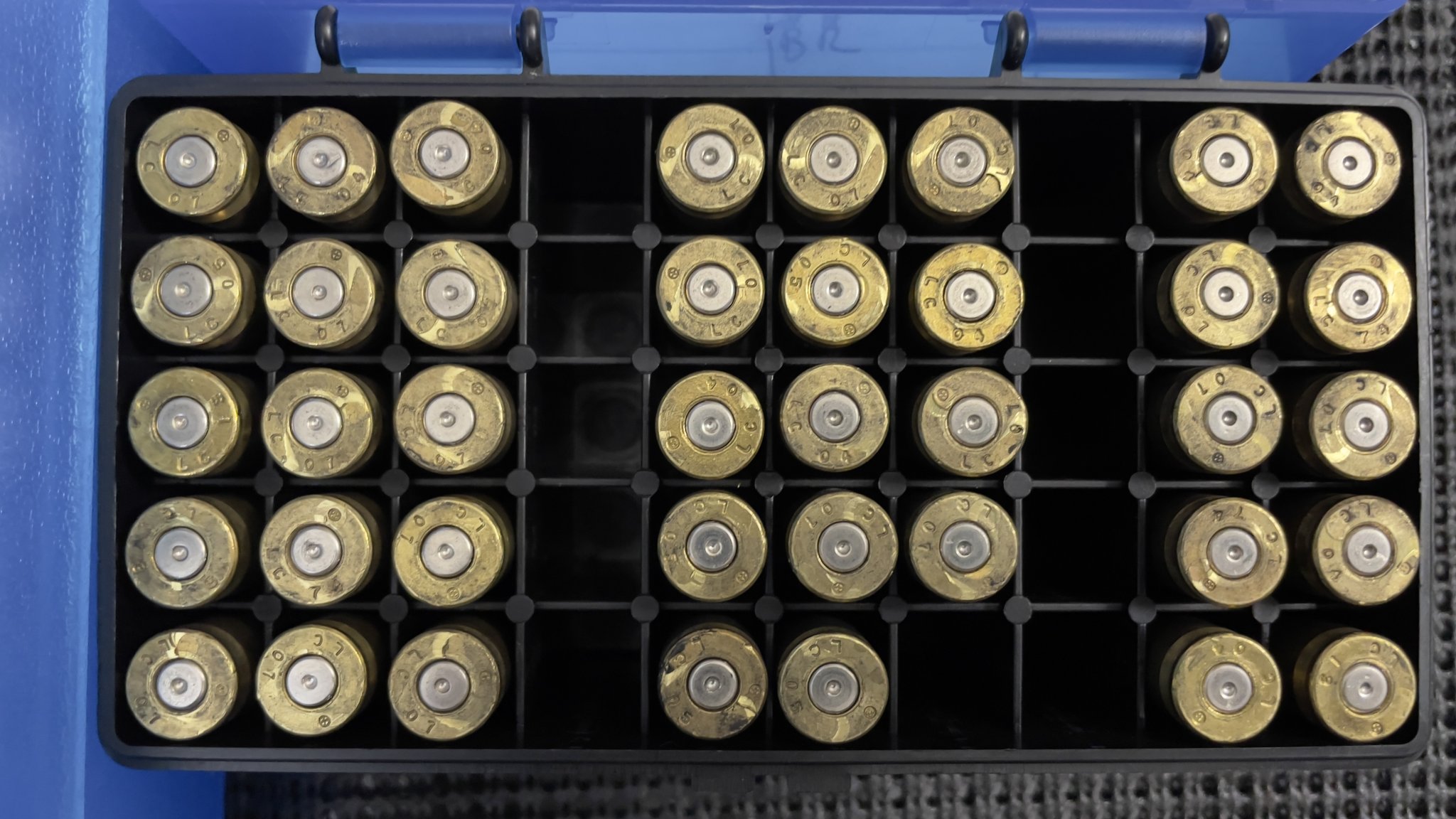

Yesterday. Some have the swipe marks, some don't. Each row of five is the same load, ladder test. So even the hotter loads don't always show swipe. It's consistently inconsistent. Was using a higher back pressure can this time around. She cycles 100% of the time now and is ejecting at 3 o'clock exactly. Locks back on empty mag. I may try a smidge more buffer weight and see what happens.

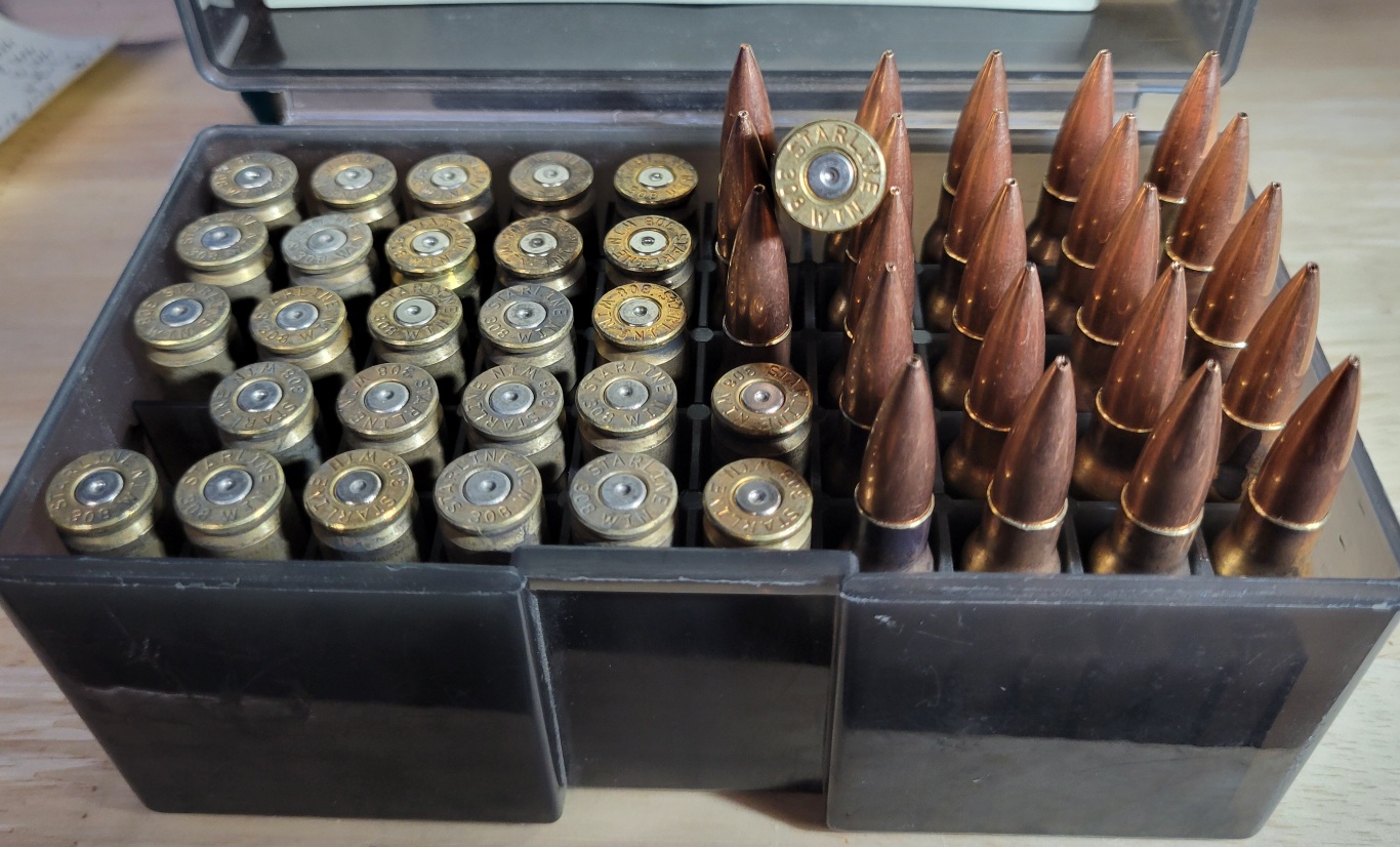

Good point on the LC brass, I should probably sort by year but I'm going mostly for practical accuracy out of the gas gun. I will say that it does it on mild loads, factory loads, pretty much anything. They aren't pressure signs though, it's the ejector making marks from the bolt unlocking early. It's always done this, three different bolts, two different barrels, numerous springs, buffer weights, charges, and on and on. A cold gun does it less. As the gun heats up, it sort of stabilizes and does it more frequently but still ejects a few pristine cases every now and again.
