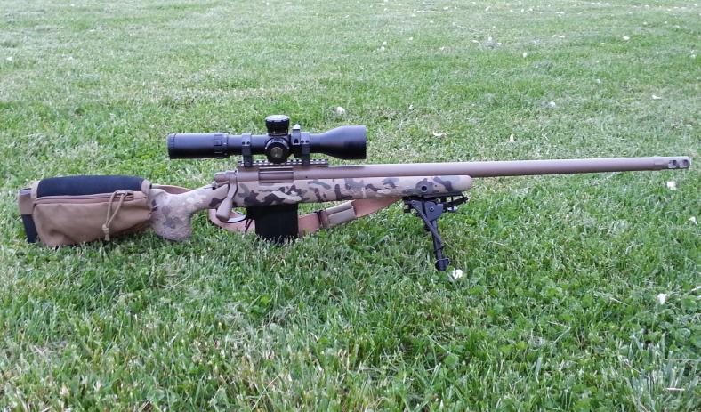

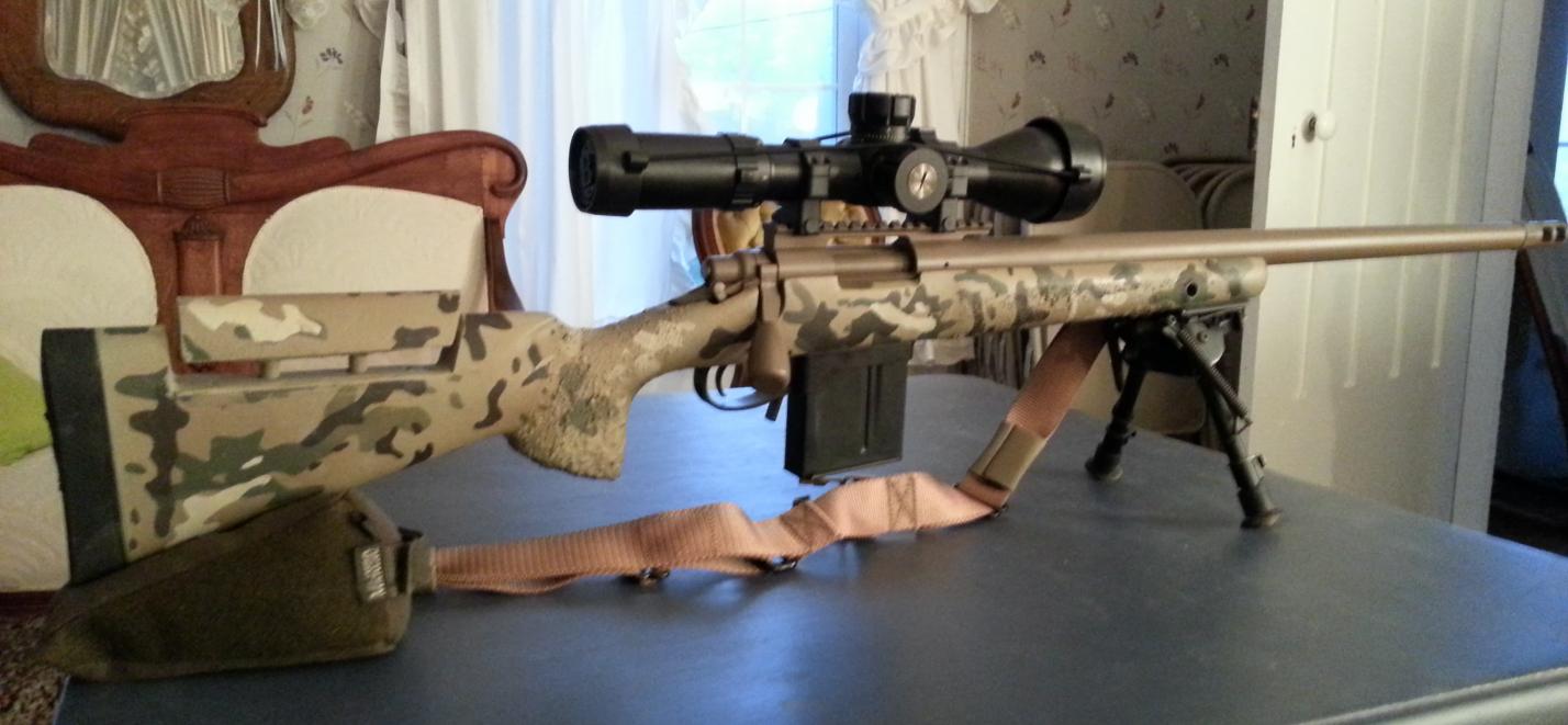

I realize HS Precision stocks aren't top of the line, but here is my attempt of making one more comfortable for me. Being a college student my budget is limited, so I have to make due until later on. The rifle is a Remington trued action, Krieger 1 in 8", BGW brake. Has anyone else made an attempt to make a HS fit them better?

Which stock did you start with before you added the cheek riser, flush cups, camo'd and textured? Did you also modify the grip besides textured?
The stock was just the Varmint Tactical model. Yea I added some epoxy to the front of the grip to give it a more vertical grip angle.
Nice job! Why do you think HS isn`t a good stock? I would rather have an HS than a Manners.
I think they are a great stock, they just seem to have a bad reputation here. I have 3 of them, and they work just fine for me.
Doesn't look bad to me.
did you do the cheek rest and sling mounts on the side?
Yea I made the cheek rest hardware, cut, and installed it. I installed the flush cups as well. The rear of the stock is hollow so I filled it with epoxy putty after I cut the riser section out.
I think you did a pretty dang good job, and if it is a shooter, who really cares? If you are still struggling with fitment, looks like you could go with much lower rings.
I agree on the rings. I couldn't find any low rings in stock, so I jumped the gun and bought medium. I'm going to replace them eventually.

Thanks for all the compliments! Don't get me wrong, I think these are great stocks. I just couldn't get it to fit me properly without making the adjustments. It feels great now when laying behind it. The gun was shooting sub moa prior to the barrel set-back. I'll see what she'll do this round later this week. The new chamber is with the 260 tactical match reamer, but the original was just the standard 260.
I have an hs on my build since its its in my budget and I'm going to do the same with my stock, with epoxy mixed with fiberglass powder and with a pvc pipe so I can take it out if I want
I made that cheek rest using all-thread and some lock rings that press over the threads and hold it at the desired position. It can be adjusted as well as removed. I cut a couple pieces of light metal and drilled holes in them to align it.
