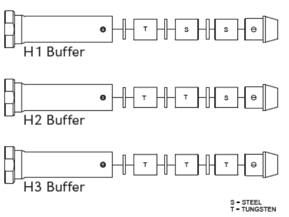

From there, add weights as needed. For example, we sell the individual tungsten weights: Carbine Tungsten weights If you see below, the Heavy weights are a function of how many weights are steel v. tungsten. There are three weights inside a carbine buffer. The standard H0 is 3 steel, and H3 is 3 tungsten:
From this, you can see how you can configure your own buffer, just by buying a few weights and opening up the buffer with a punch. There is a lateral pin that holds the rubber stopper in. If you punch it out, the weights and spacers are accessible.
I would try this first.
