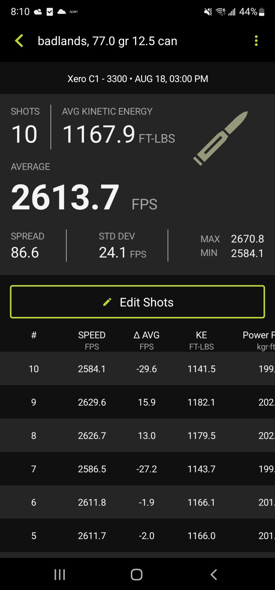

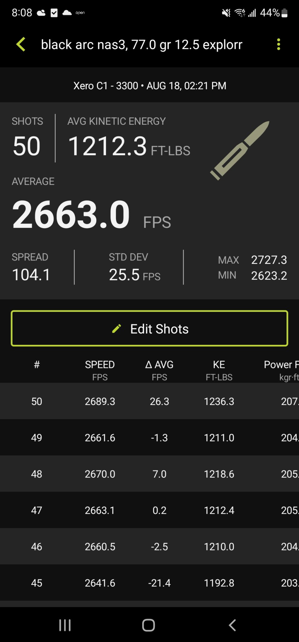

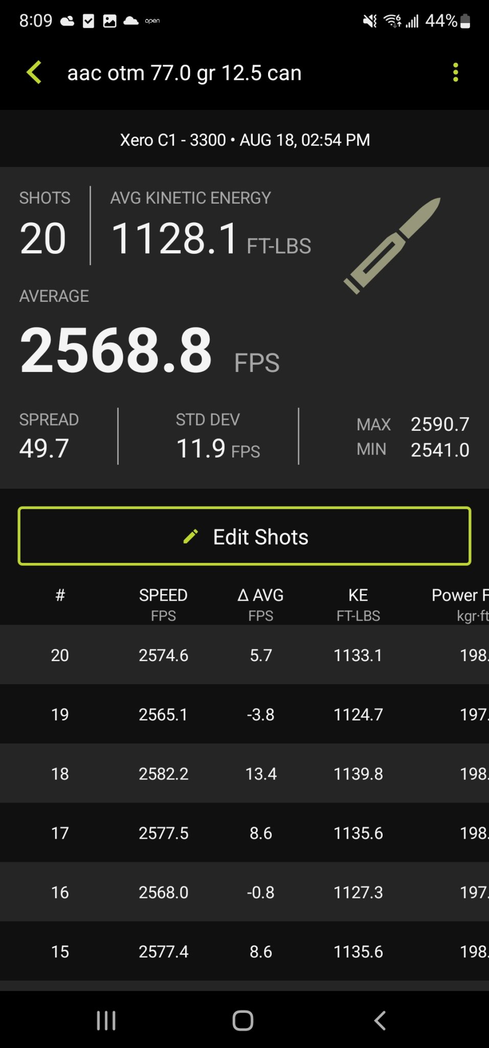

The bad news-i forgot to charge my garmin and it didn't make it through all the ammo. If was also very windy so I didn't get an accuracy test in.
Good velocities but a rather large ES from these for me.
A little on the slow side but really good stats
*sigh* the 77gr load performs poorly for me from them

I'm not knocking the speed-its the ES that makes it not worth it to me. I'm getting very similar with black hills red box 77's (about 2640 in similar conditions) but half the es for a cheaper price.
For your high of 2727fps with 77gr, you’re...
300yds 1.1 / 0.8
400yds 2.1 / 1.2
500yds 3.3 / 1.5
600yds 4.7 / 1.9
700yds 6.3 / 2.4
800yds 8.3 / 2.9 right at supersonic threshold
For your low of 2623fps...
300yds 1.2 / 0.9
400yds 2.3 / 1.2
500yds 3.6 / 1.6
600yds 5.1 / 2.1
700yds 7.0 / 2.5
800yds 9.2/ 3.1
I was going to say it might not matter much, so I ran the numbers and it actually does. Won’t matter much within 400yds, but after that, you’re looking at vertical dispersion of .2 to .9 mils, which is no bueno.

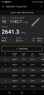

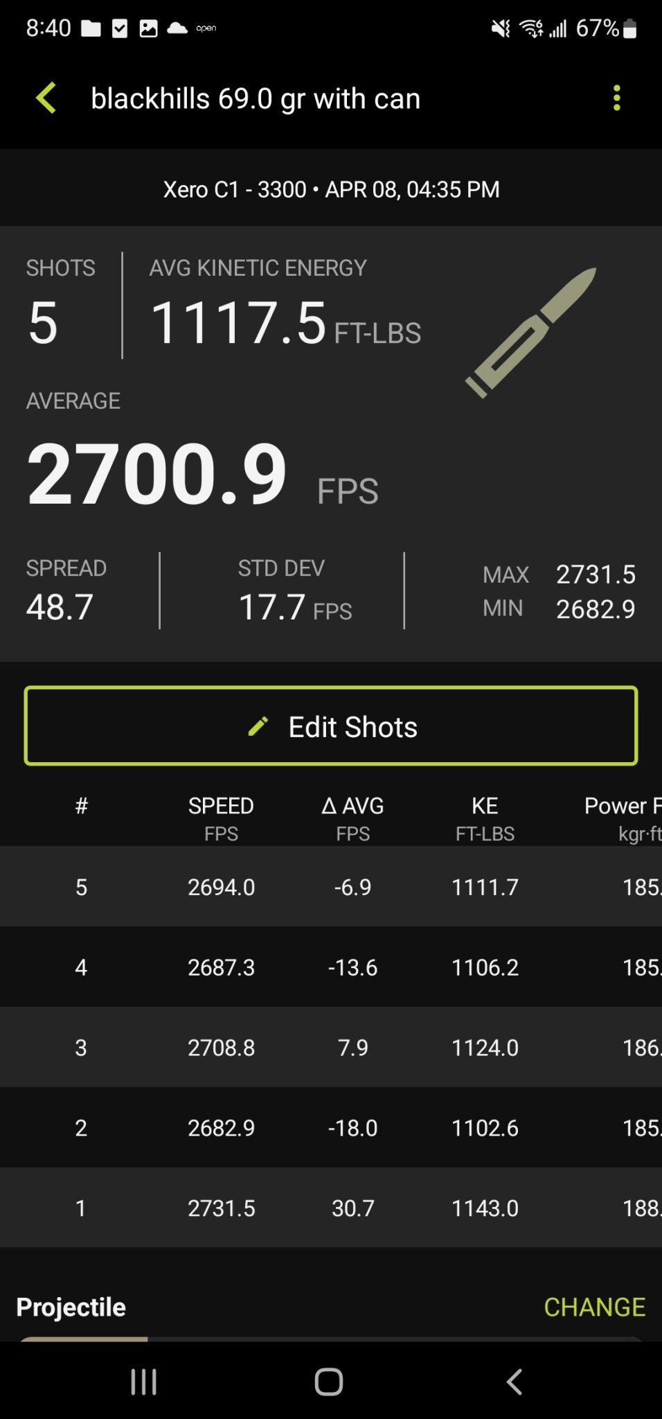

I dont reload
That being said I'm getting 2650 from black hills red box with a low 20's sd and around a 60 es.
69 tmk's are around 2700 with a high teens SD and 50 ES
I said it earlier in the thread but the SD of all the tested loads doesn't bother me, it's that ES creating fliers (like you pointed out)
