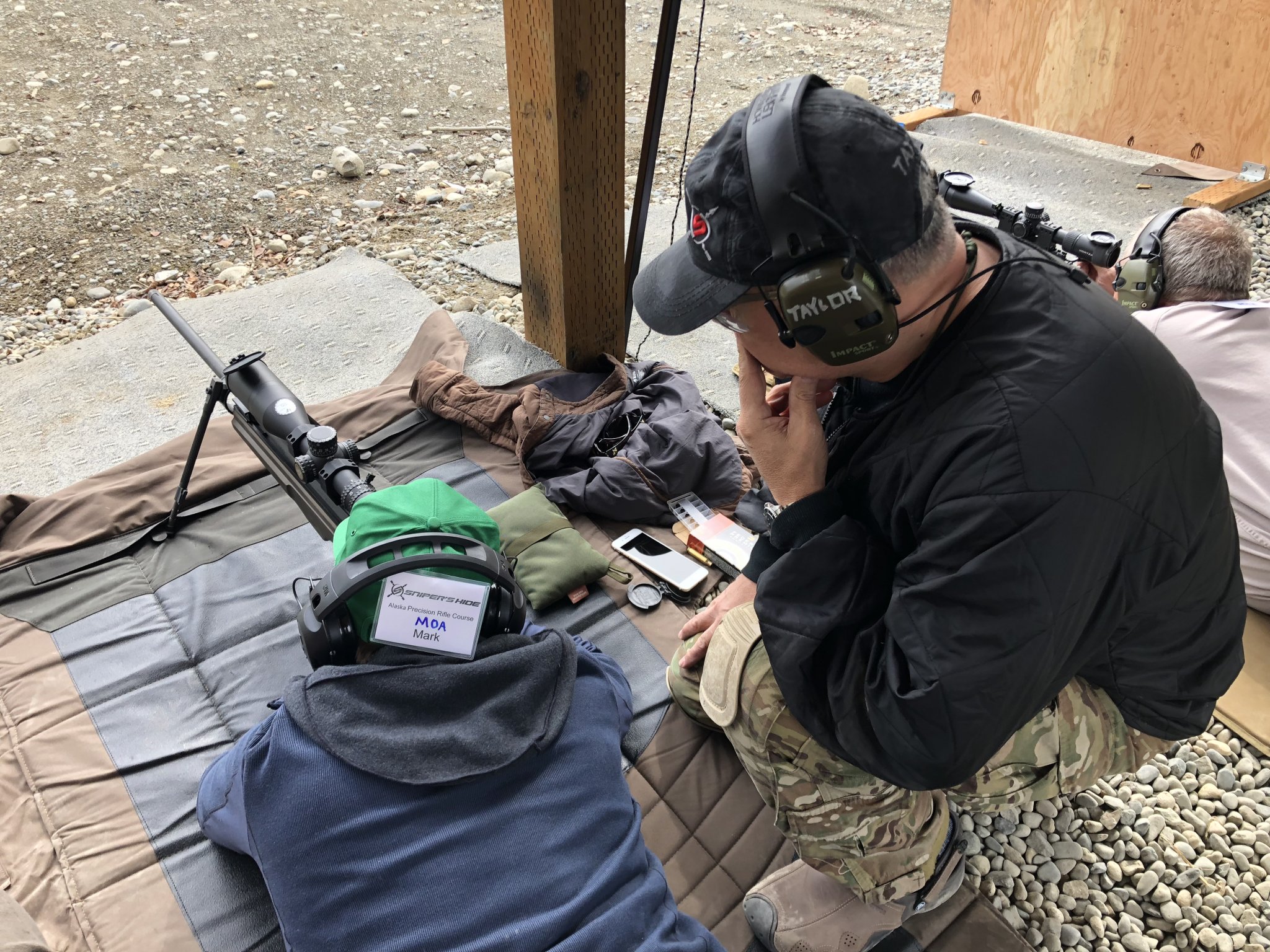

Just for reference the answer wasn’t to short for the guy between Frank & Mark. If your scope is slammed down tight you may want to consider at least bringing a higher set of rings or mount to the class. They’ll be removing the scope anyways and they will get you straightened out.
Now if your taller than that guy you may need Taylor to custom Taylor you a bag.

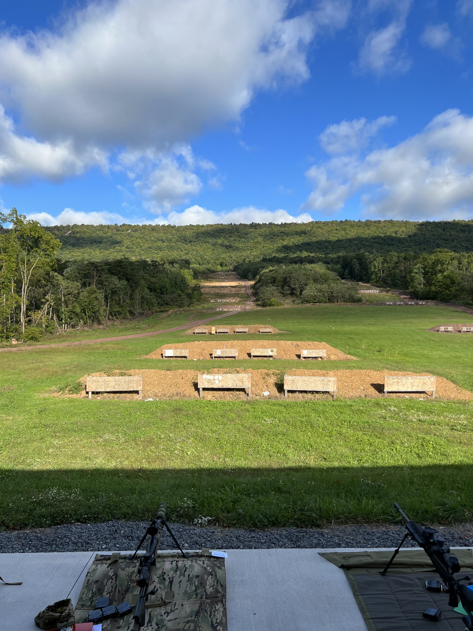

That's a nice view of the terrain what range is that

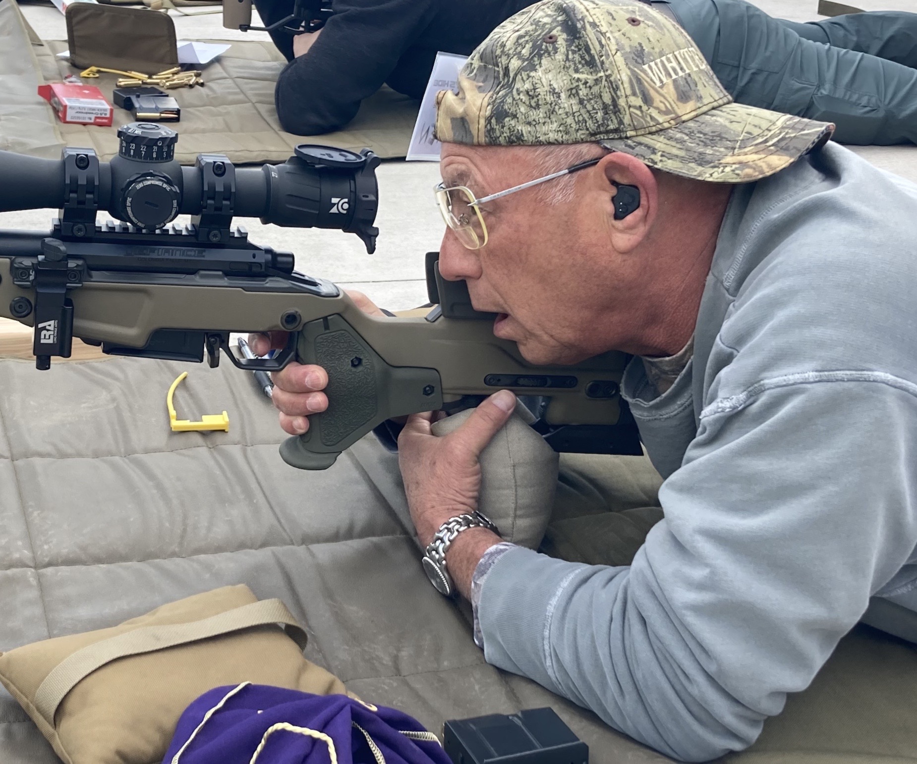

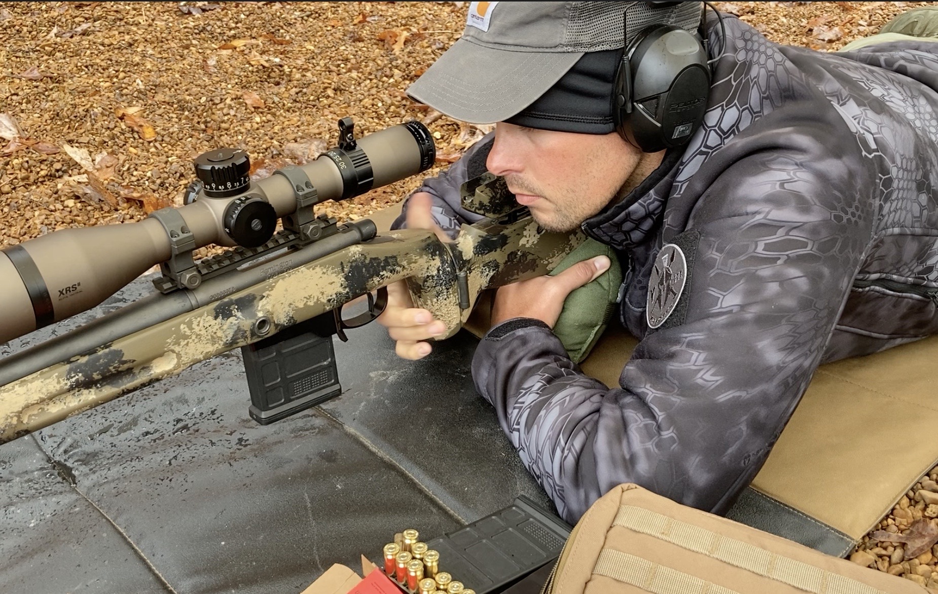

Getting lots of PM's this weekend about position height. Well, this is what you are seeking. Comfortable position, head erect, buttstock biting into the shoulder pocket not pushing under it.
Note the notches being used on the bipods in this photo taken on a break at a Course in PA. If your goal is a string of fire at similar ranges and elevations, seek the perfect bipod height, not a compromising one.
Shooters WRONGLY just sink in the bag instead of raising the bipod. WRONG. It's PRECISION RIFLE, not compromise rifle shooting.
