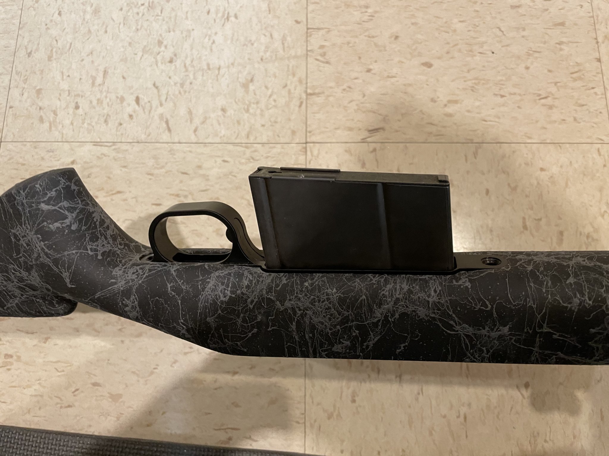

So I see straight up contradictory info on putting M5 bottom metal in BDL inlets.
Some places say, "Nope, requires inletting". Then you have some gunsmiths who post videos, showing that they straight dropped in the M5 bottom metal. Thing is, they talk about the subject with full knowledge, and assume that everyone knows the problem areas. (I'm familiar with Rem 700s, but not quite sure how to compare info that I don't have)
What the actual hell? Why, or why does it not, fit? That's the one thing that I can't get a straight answer about. I've even tried contacting several manufacturers, to understand what the compatibility issues are. But I don't have a pile of stocks, actions, and bottom metal, lying around (haven't been a gunsmith for 20+ years). I'm looking at obtaining a Hawkins DBM trigger guard. I really don't want to do any stock work. So if there's a trick, I'm listening...

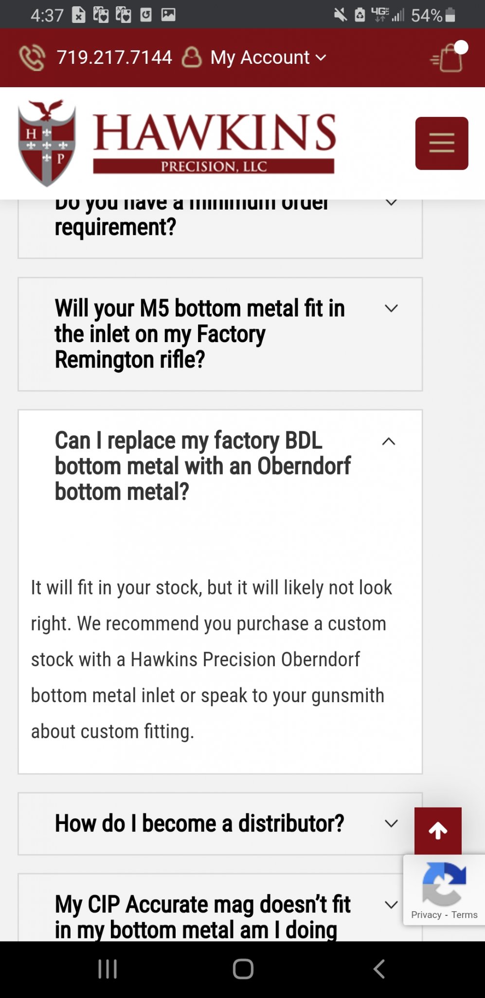

The devil is in the details. The hawkins page says their DBM fits M5 inlets, no reason to believe thats not true. You need to order a stock with the m5 inlet, or alter what you have to an m5 inlet. One thing is for certain, a true Badger M5 is way bigger in every dimension than a remington BDL inlet. You never even mentioned what stock you wanted to use. Details bro!

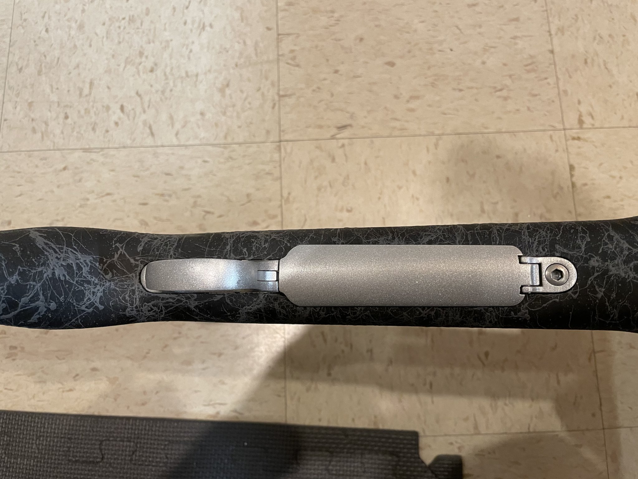

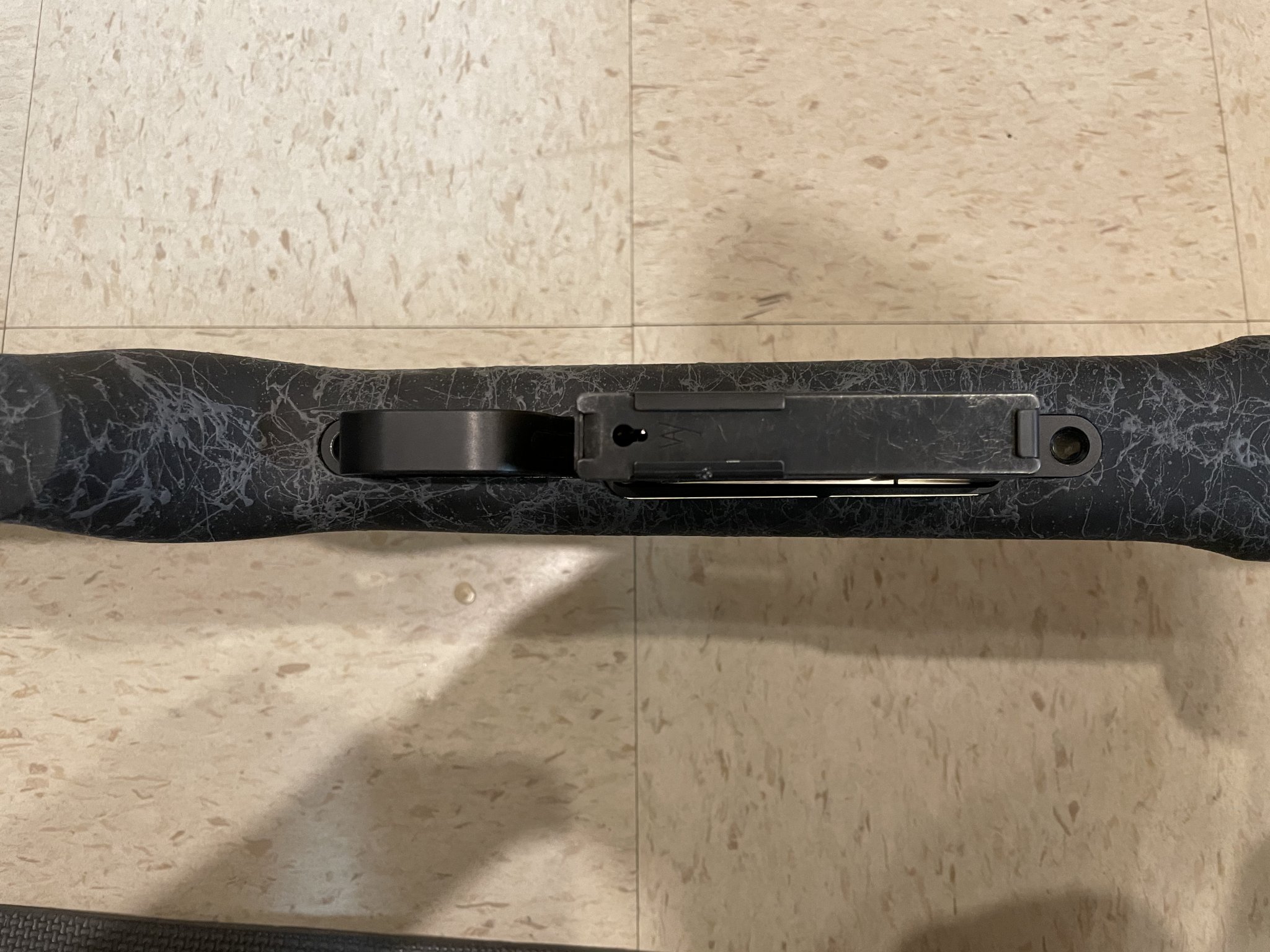

Well, the detail that I know, is the BDL inlet. But for what it's worth, it's... wait for it... a "BDL" stock! :eek:

First 2 photos are a REM 700 long action HS Sendero stock, with a BDL opening and a BDL set-up...
The last 2 photos are the same HS Sendero long action stock but with a Wyatt’s DBM
The Wyatt’s DBM uses proprietary
magazines. Only Wyatt’s mags will fit in the Wyatt’s DBM

Op, I did a little digging and suspect I have found where your confusion comes from.
Web search shows videos of guys doing something similar but not exactly what you are referring to I think. Part of the problem is I think they are incorrectly identifying their components or don't know. Also I pulled this off of hawkins site.
Thank you for taking your time to post that for my edification. I definitely want to stay away from proprietary mags. Going with the AI. Pics are worth a thousand words, to a person who hasn't seen the issue in question, firsthand.
Reactions: Earnhardt
The Wyatt’s DBM and mag are good quality.
The max COAL in the Wyatt’s mag is 3.72”, and the max in my CIP mag is 3.75”, I think.
But ya, you will only be using the Wyatt’s mags in the Wyatt’s DBM
