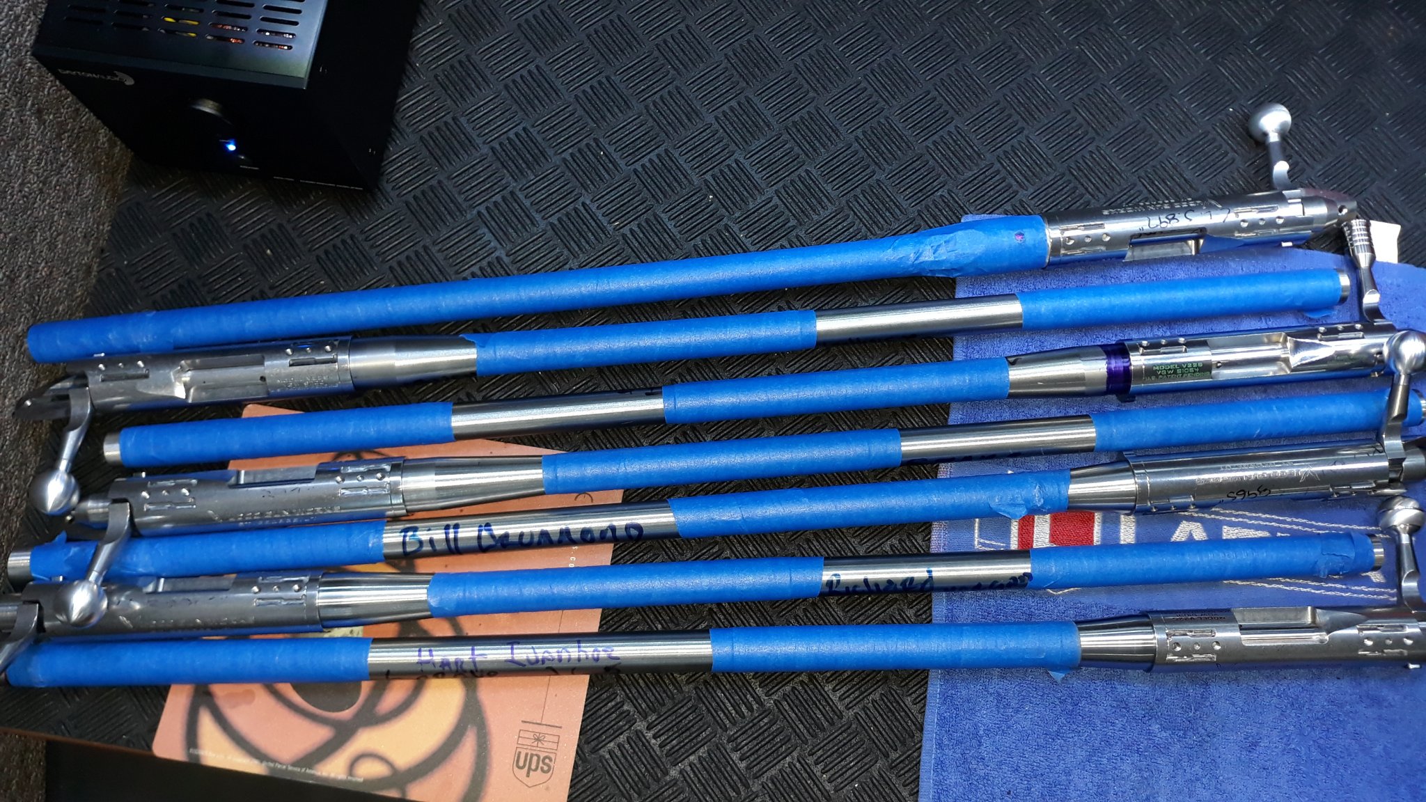

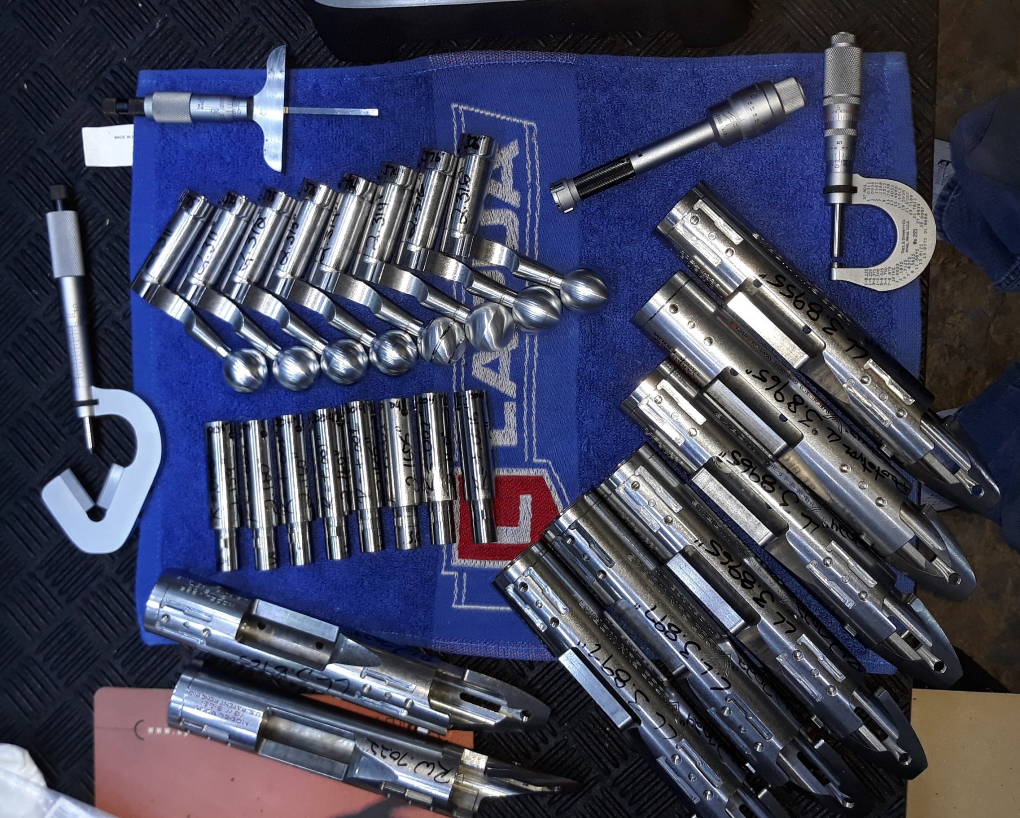

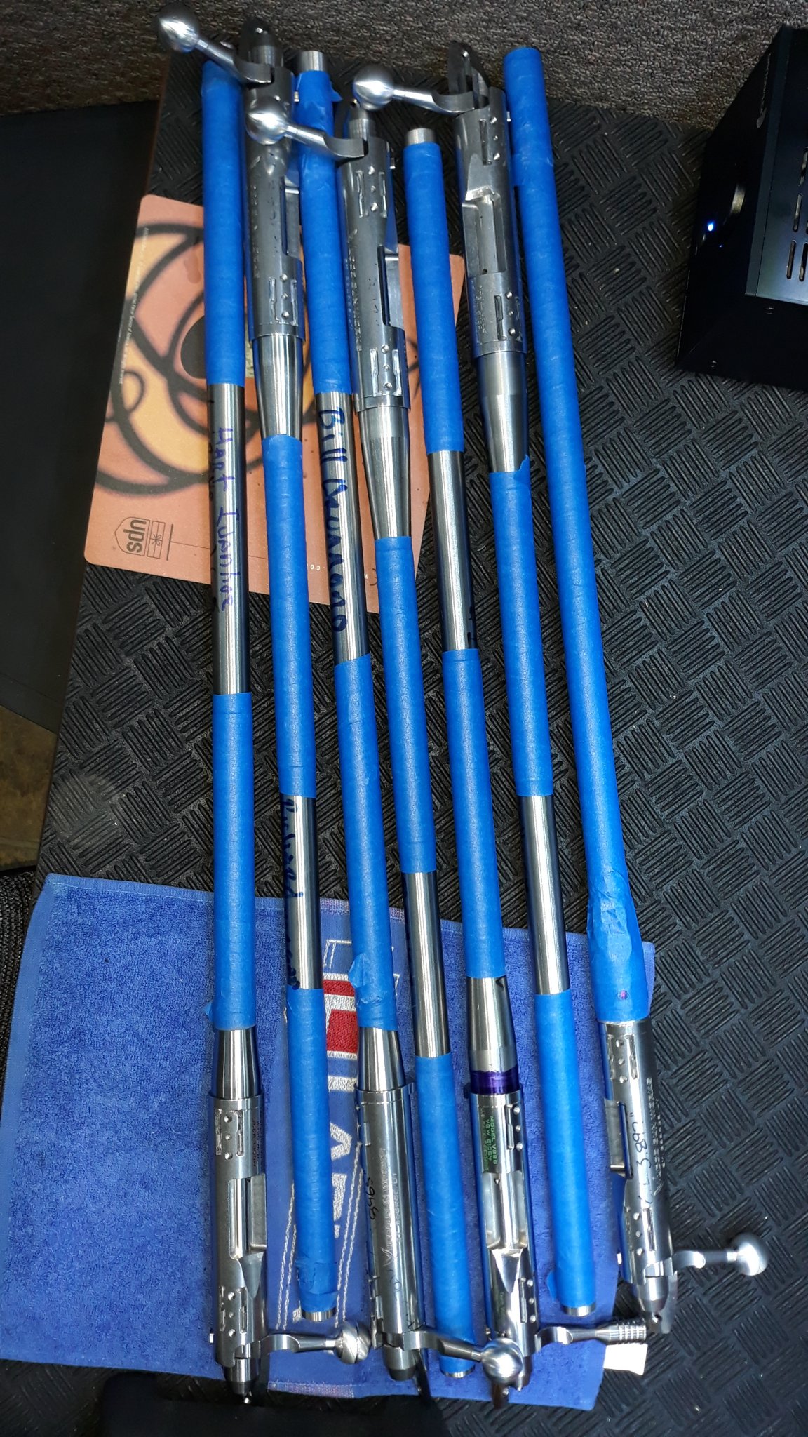

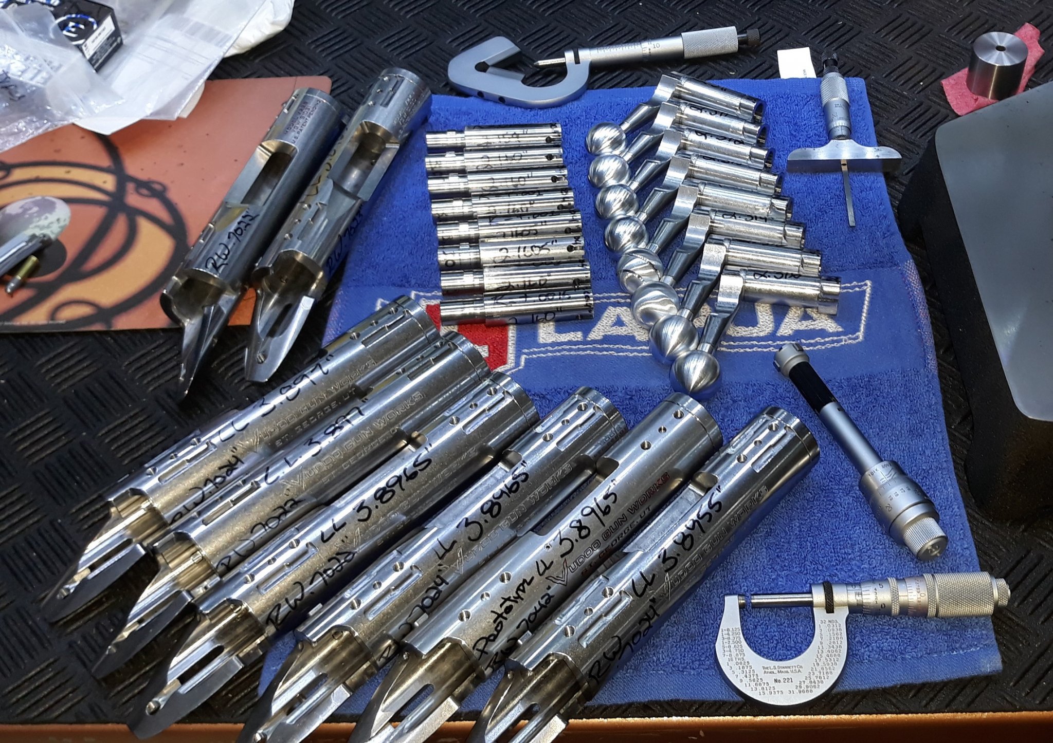

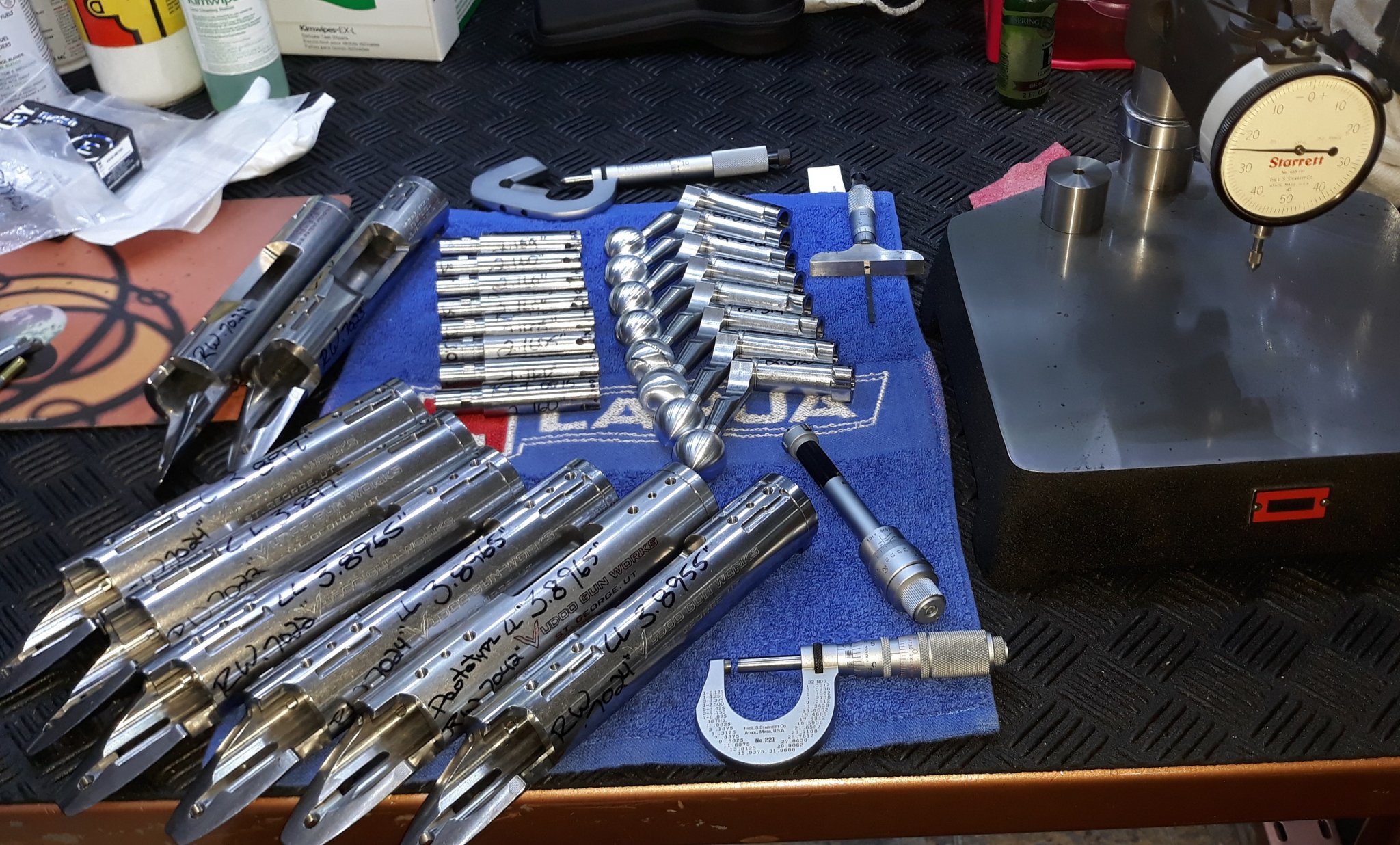

For those who have been anxiously awaiting developments in BP-150 ... like "how can I buy targets?" ... "or how can I sanction my club for BP-150 benchrest matches? ... or "where can I find BP-150 benchrest matches to shoot?" you can now access the Bullet Pro 150 website.
Go to: www.bulletpro150.com
The website is still under construction but it is up and running for the basics. Still no rules but "Coming Soon...in the works!" is on the page where the rules will be published.
Hope this helps Ivan spread the word!!!!!
It's not fair Mike's on vacation.
Ivanhoe
I'm really curious about the back story for Ivan's photos ... that's a lot of actions and all those measurement tools.
I'd love to know the mission associated with these photos?
Well norm it looks as if Ivan is doing what he is paid to do. That would be giving Mike bush additional information from his perspective about the V22s action and how it translates to rimfire accuracy.
Interesting question. I just assumed that these were the normal parts (or prototypes) coming off the line at Vudoo, measured, and then mixed and matched by Ivan to see if there is a better than average combination. If so, then I would assume a spec tightening aligned to replicate those preferred combo's in the manufacturing environment. Now, that is probably a long stretch from just looking at those photos, but my intuition and manufacturing background took over....
RFS99
RFS99
Yessir, your assumption is correct, they're typical of what's produced everyday and Ivan is cataloging info which is a common practice before building a rifle. Through the process, we share info that leads to minor revisions and in some cases, really cool ideas.

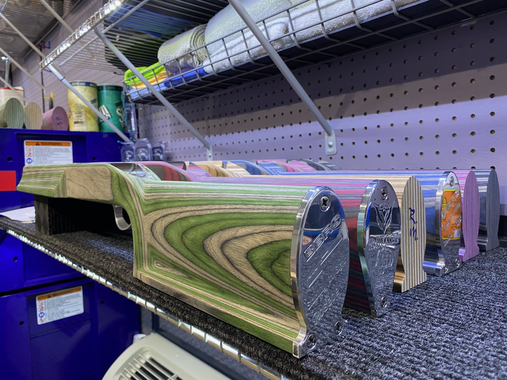

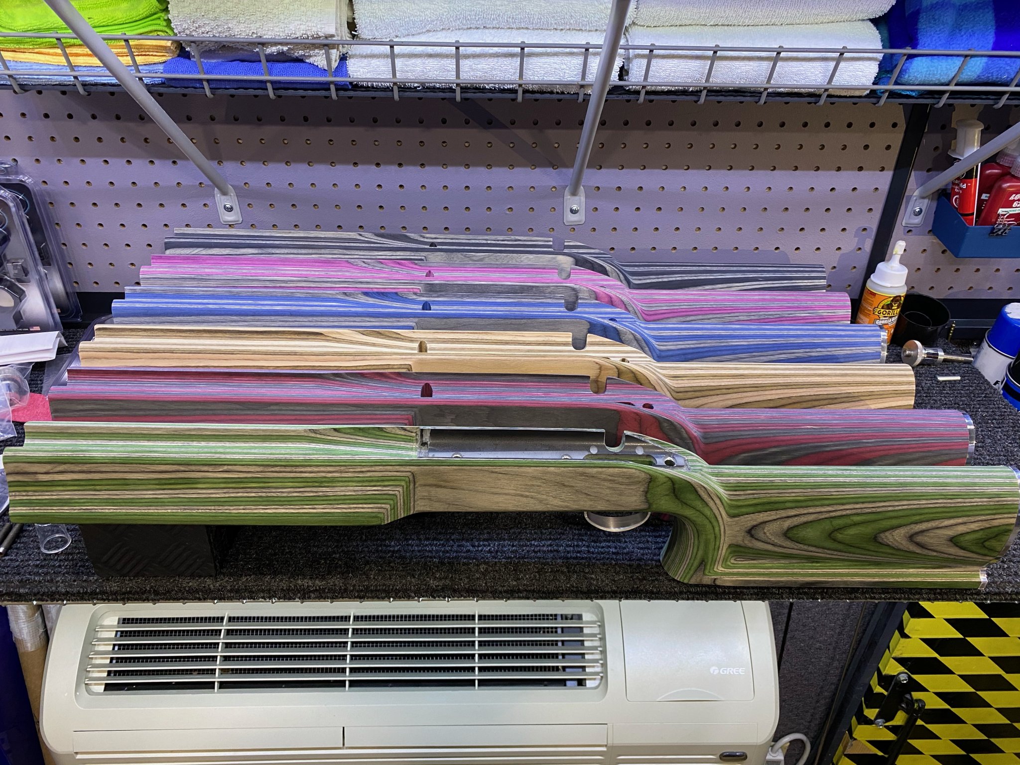

A little update!!
V.L.P. No wine until it's time.

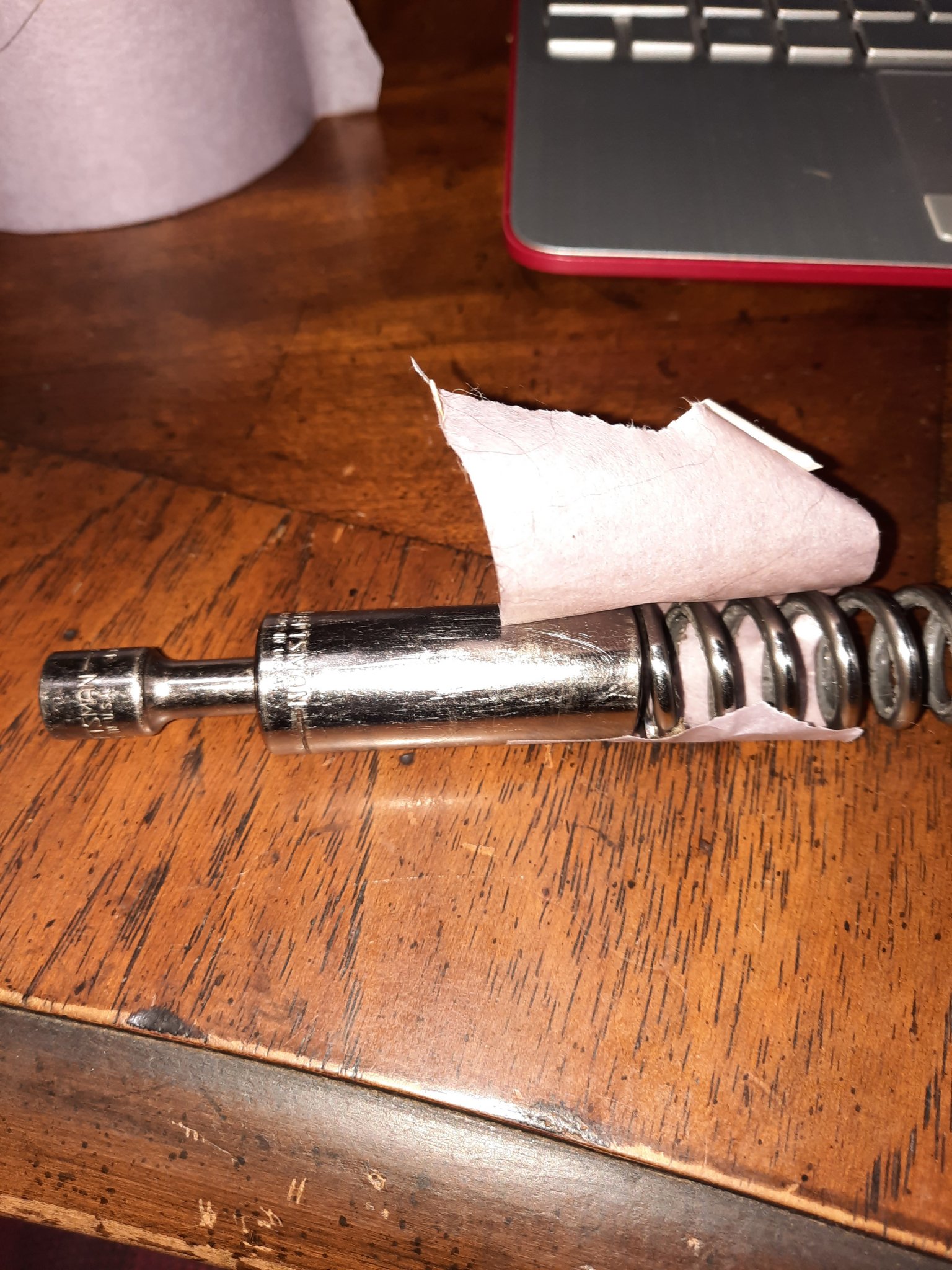

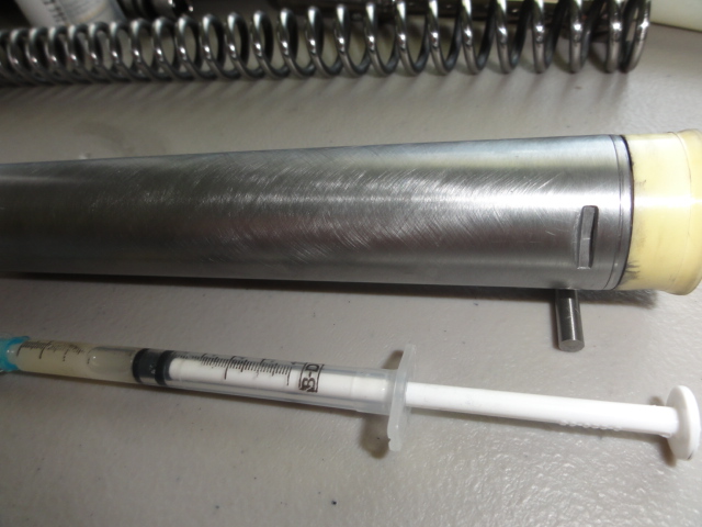

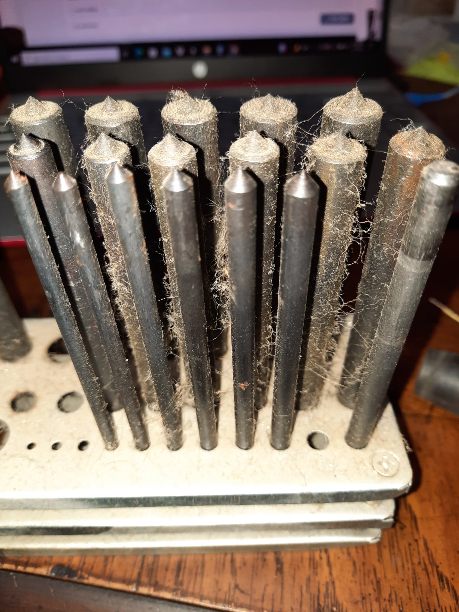

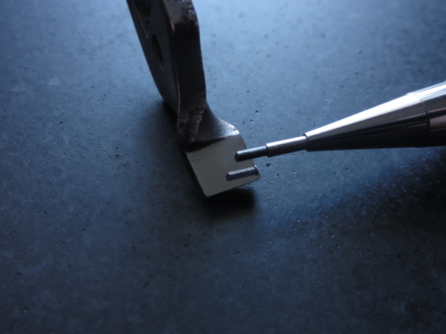

Ivan what is the best way to remove paint on firing pin? What is best way to polish spring inside and out?
Reactions: 10ring1
Stephen,
Why would you want to do that in any case?? Can you polish and round the sharp corners of the FP that slide
through the spring or in it's guide slot? What is your perceived gain in this venture?
Ivan will likely remove paint and polish it in ways you cant because you don't have his tools or life experience.

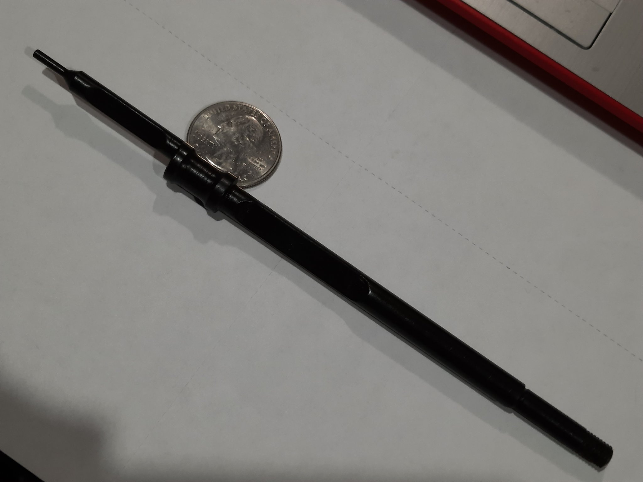

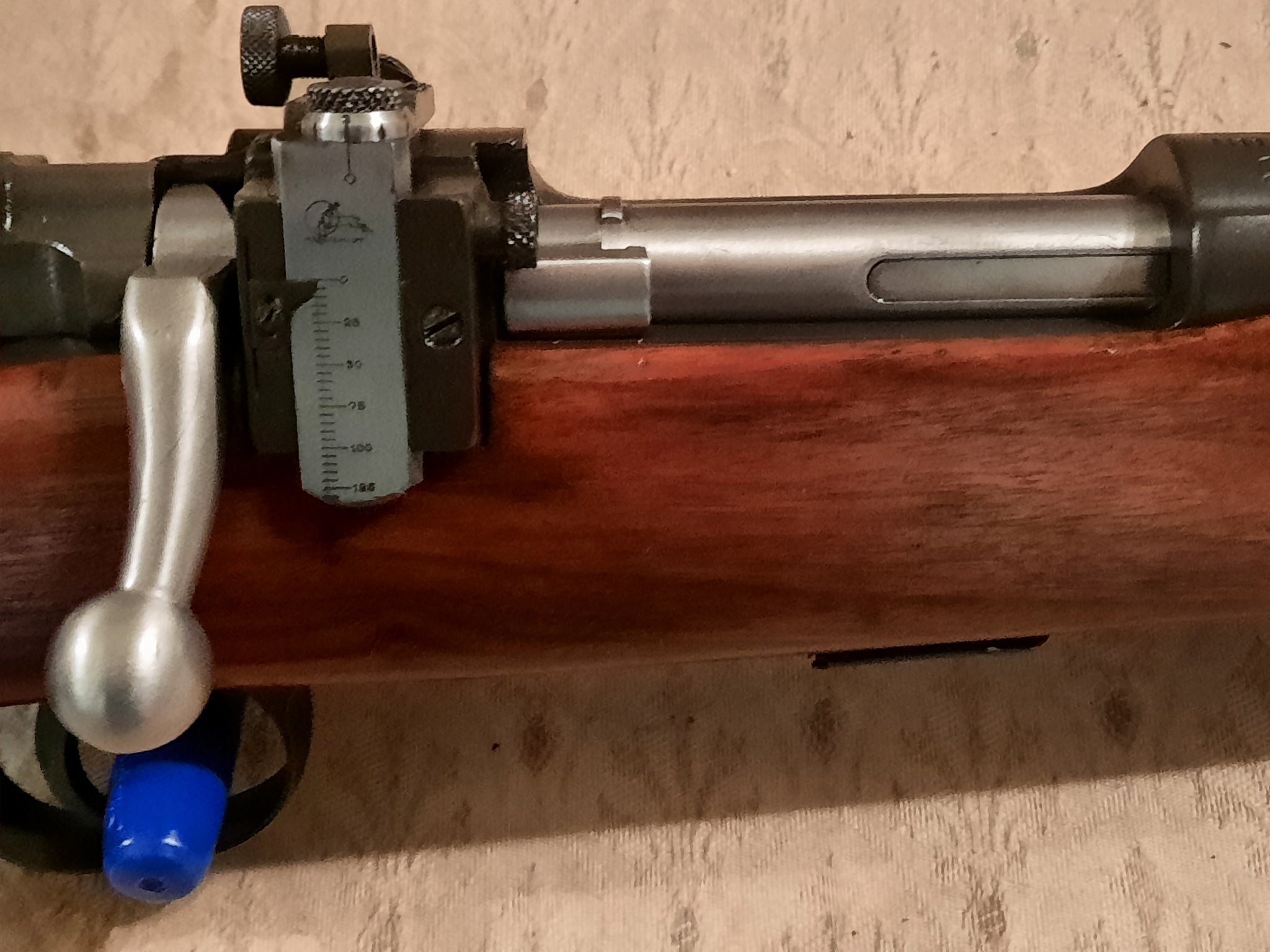

I recently bought this firing pin for my Springfield 1922 M2 and it was covered in crap. I cleaned the grease from it and
then had it sand blasted. I could have skipped the blasting but it was available and fast and got into every corner.
Then I chucked it up in my 1/2" battery drill and sanded it with some 220 wet / dry.
Then it got a bath in some cold blue. If your talking about a small spring like one that is in a Vudoo, you
can probably chuck that in your drill as well. You could use a screw extractor to get a bite on the inside of the small
springs.

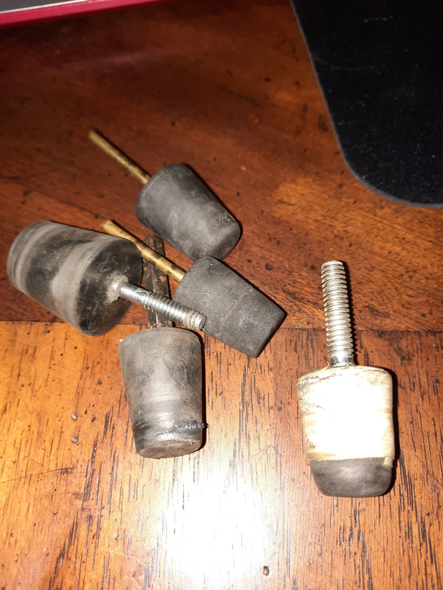

You can also get cork or rubber stoppers and put a spindle in them. The flanged type are best. Mine were hooks that had flanges
and I cut the hook from them. One of them shown is a square screw extractor that doesn't have a tendency to screw itself inward while
using it. .

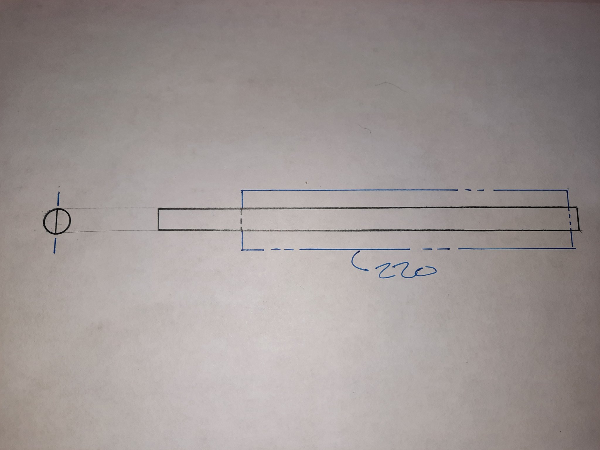

You can find a socket that nearly matches the OD of the spring and tape it to the spring. If your stopper is too small,
you can make it a little larger with tape. For the ID of the spring you can wrap or barber pole a transfer punch or other
small diameter with 220 and polish it. It really comes down to what tools you have and how creative you can be.
Me telling you to use a tool that only I have is a waste of our time. You could cut a small wood dowel lengthwise
and put a strip of 220 in it. Or you could use some double sided carpet tape to attach the wet / dry to the spindle or you
choice.

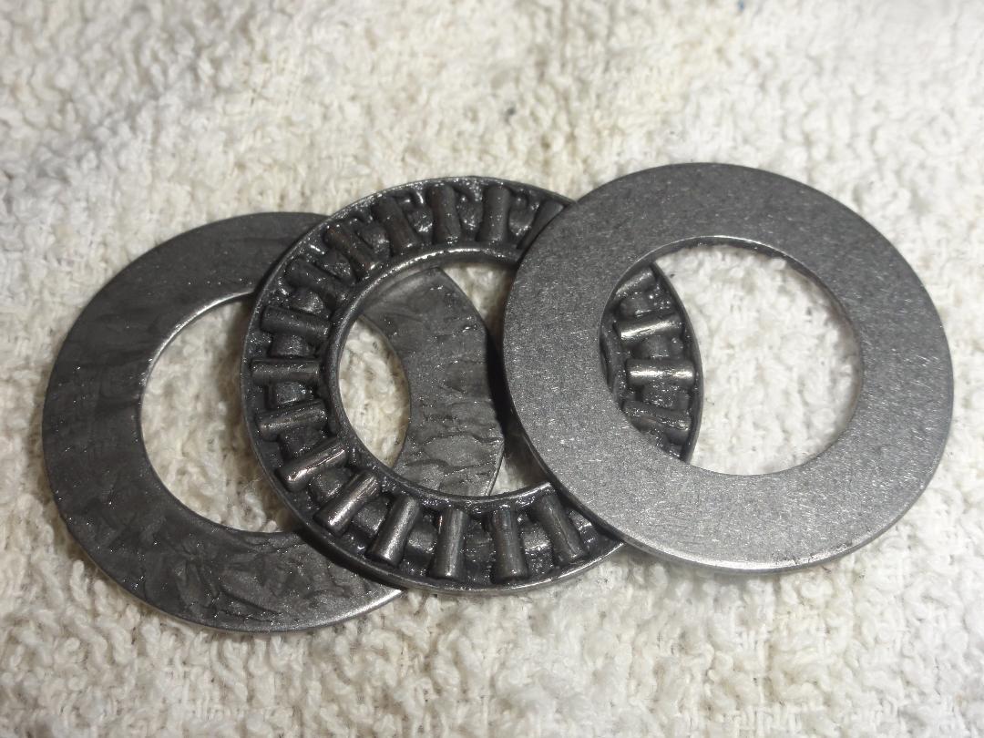

I should have offered up that I'm not polishing springs in .22LRs. The springs that I polish are in a HW 97K air rifles
and run inside of a Teflon or UHMW liner and around the same type of bushing.
I was simply offering ideas for poster #28s question.
Personally, I remove the rear polymer thrust bearing and replace it with needle bearings.
Trigger sears are polished with 9 and then 3 micron AO PSA backed lapping film.
I will look up Evielo McDonalds comments as I have my reservations if you mean Failure to fire.

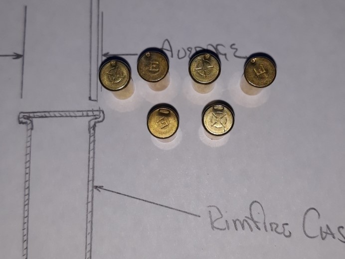

Ivan does the pin strike .015-.021” from outer edge include crescent and chisel point pins?
That is a reference, what ever firing pin shape you may have compressing the metal on the outer edge does nothing more than waste kinetic energy. Hitting inside the reference .103" radius or less you are compressing nothing inside the case. (RIMFIRE)
Hope this Helps!!
