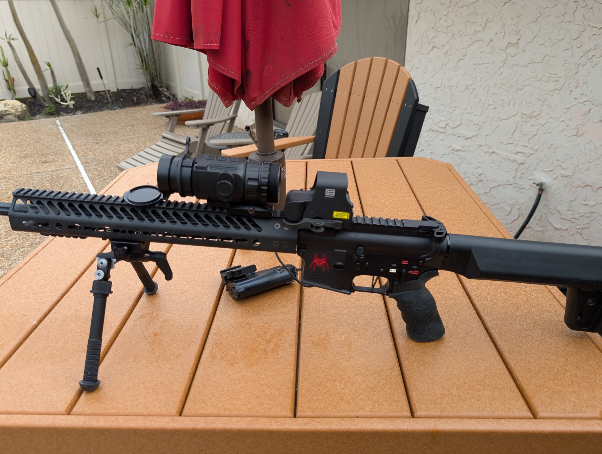

I can say I just got my first thermal from @tam4511 at SOK, check the specs
I haven't had time to look through it at range but inside a house looking at an old electric wall heater on 1x digital zoom behind my Athlon Talos 4-14 it's pretty amazing. I bumped digital zoom up to 2x and it's even better and pixelation isn't very noticeable.
Again I haven't had this out in the field yet.
What I can say is it's REALLY impressive for the price.

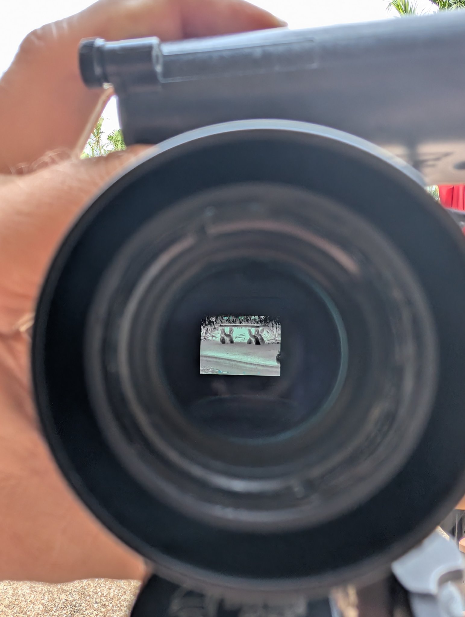

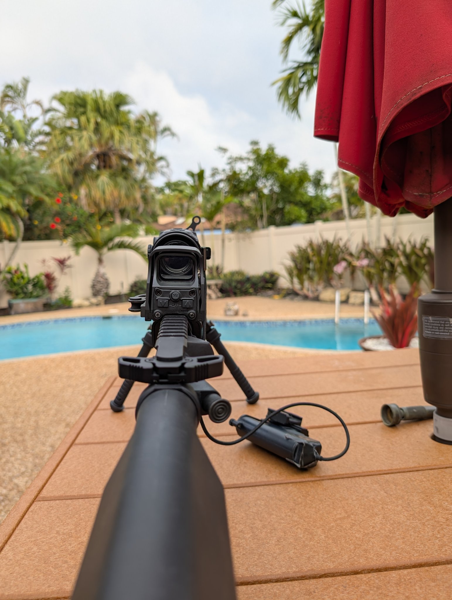

You may need to worry about 1x if it is not a variable scope that goes higher. The screen is a tiny FOV by itself.
I'm not following what you mean, sir. A traditional red dot or 1x prism (my only 1x prism is a Primary Arms GLX on an 11.3" AR) might not work well?
It kind of works, you can see the screen, but FOV may be very disappointing if you put the dot and Clip-on close to your eye and the screen image can be very hard to see if further away - small.
My Clip-on comes with a magnifying eye piece you screw on to use as a hand held monocular. Without it the screen is like looking at a TV the size of a postage stamp.
