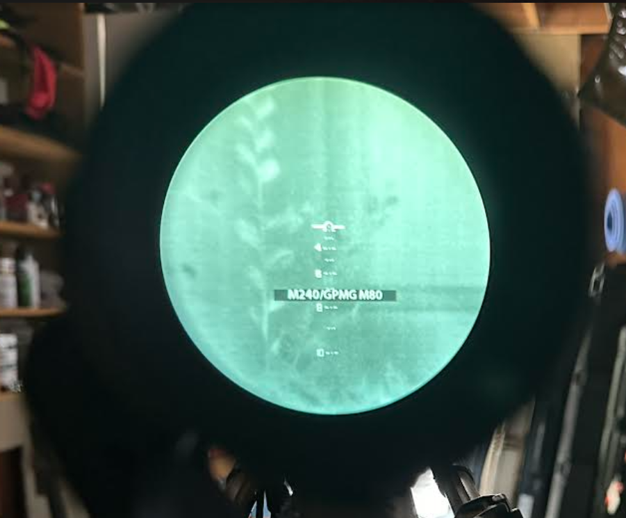

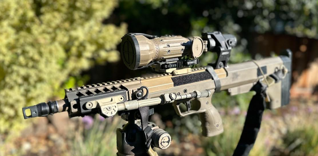

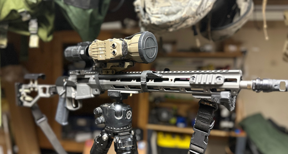

Been running the Voodoo-ML through various rifle setups as a thermal clip-on, but thought I'd play around with the built-in reticles to use in standalone mode. Obviously with the demag it's kind of difficult to use without any magnification, but a simple pop-up magnifier does the trick, making the rig work as a 5x thermal scope. Obviously it's best used as a clip-on, as it can handle up to about 15x magnification on a day optic, but that takes a quite a bit more real estate and increased weight. I'm surprised how well it works in this case.

Image quality is outstanding, but I've only been shooting paper so far and spotting critters at night - night steel shoot is still a couple weeks away. Where the Voodoo seems to stand out with other BAE-core devices is the image processing software (and optical quality to a degree). 2x digital zoom is impressively clean - hence the 5x standalone mode is a very usable 10x with 2x digital zoom. Like the Oaysis devices, and unlike the NOX 35, the brightness can go low enough to use on a really dark night. Also, the built-in MARS/RAPTAR integration is really plug & play.
