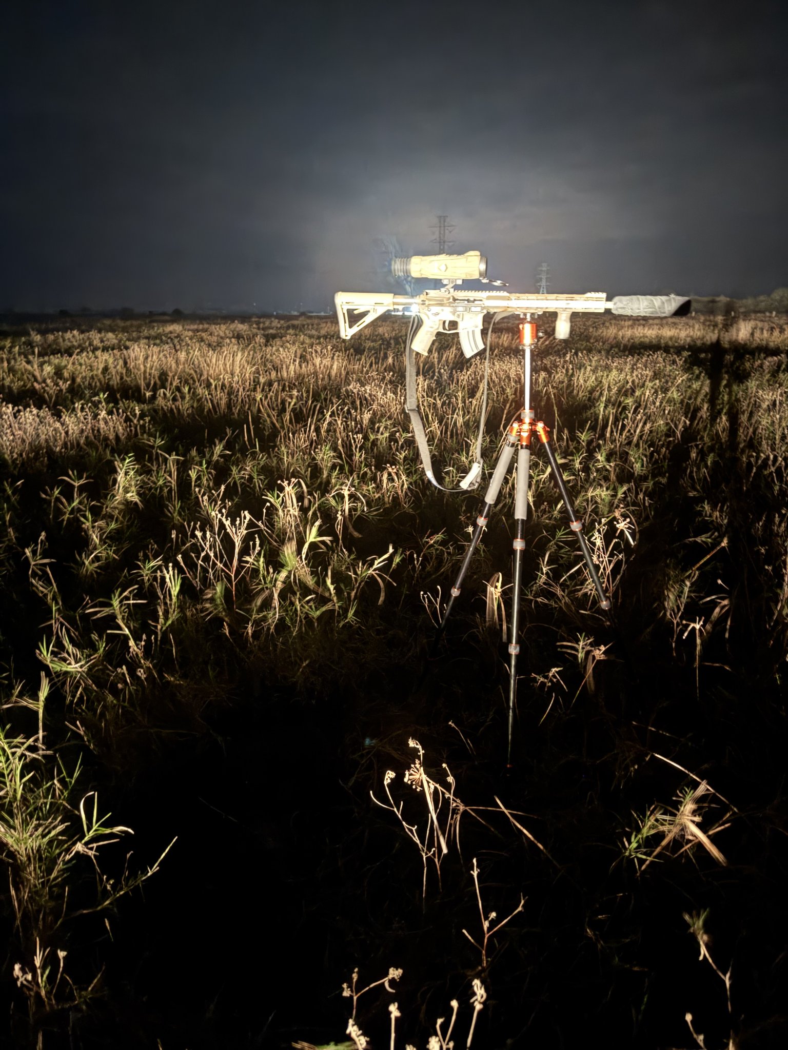

I use AR 223 20", TBAC ULTRA and Federal 53 gr VMAX, aiming with an Nvision HALO-XRF. Zero runners, instant death.
