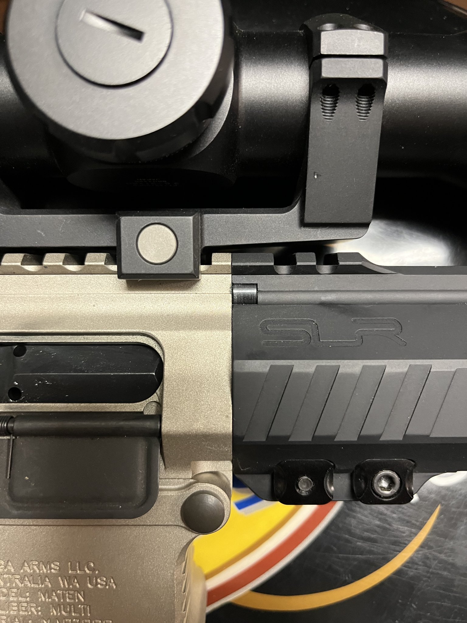

    Thanks for replies. Considering there will be somewhat limited shot strings, and the spare variety of alternate handguards with desired features, we decided to put off installing the TD for now and pick up an SLR. If desired in the future, will modify a TD to fit selected HG. My friend is pretty excited to get build moving after doing his first longer range foray at the ranch. Should be a solid build with a selected component list. Appreciate replies.

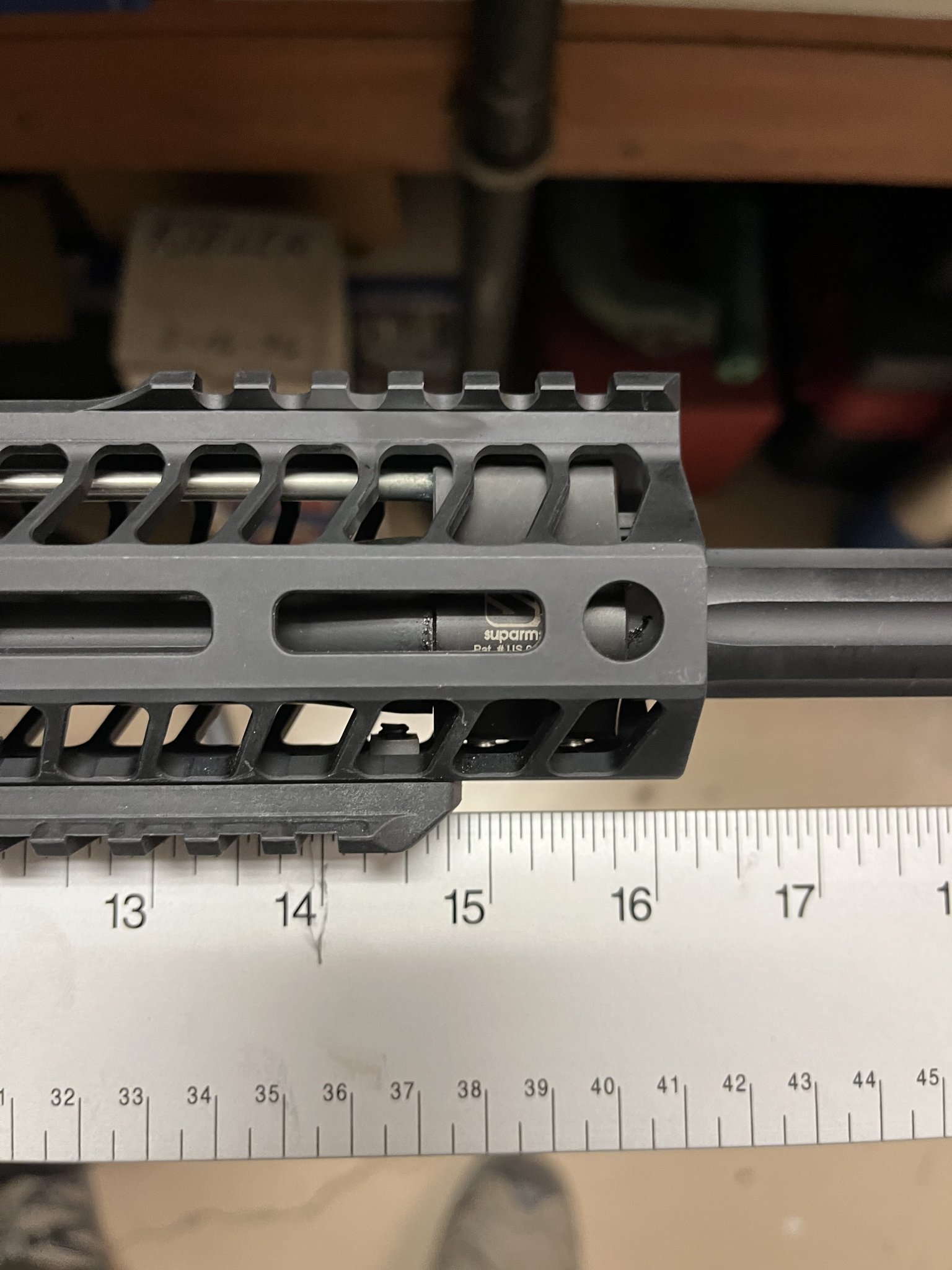

    If you intend on covering a +2 gas block under the handguard, it will need to be over 16" long. Also, if you intend on using the anti-rotation pin with a non-Zev handguard, there's a couple of other considerations.
    Think this is a SLR Helix, but 16” on +2 gas Krieger from Keystone. Superlative AGB adjustment screw right at flush with front of handguard, on a MATEN build of my own. What other considerations am I missing, respectfully?

    Ordered the balance of build opponents yesterday. Have 22” +2 JP 6.5 CM barrel-absent dissipator, Superlative set screw AGB and SLR Ion Ultra Lite handguard. They all fit on my personal builds and should work well for my buddy’s project.
