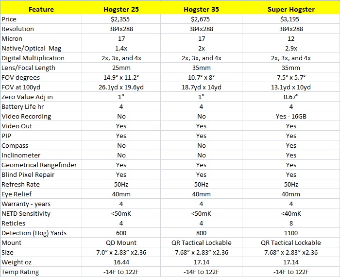

There are only a few options in this price range. For this price, the Hogster series from Bering Optics is the best value in the thermal game. It has become our hottest seller at Night Goggles. Many of the other more affordable options become almost worthless when the humidity gets high. The Hogsters still perform really well. There are 3 models. 25mm, 35mm, and Super Hogster. The table below gives you the differences between them.
For what you described, I would probably recommend the Hogster 35. It falls in the sweet spot for FOV and magnification. However, if you need some shots up to 300, I would then recommend the Super Hogster.
