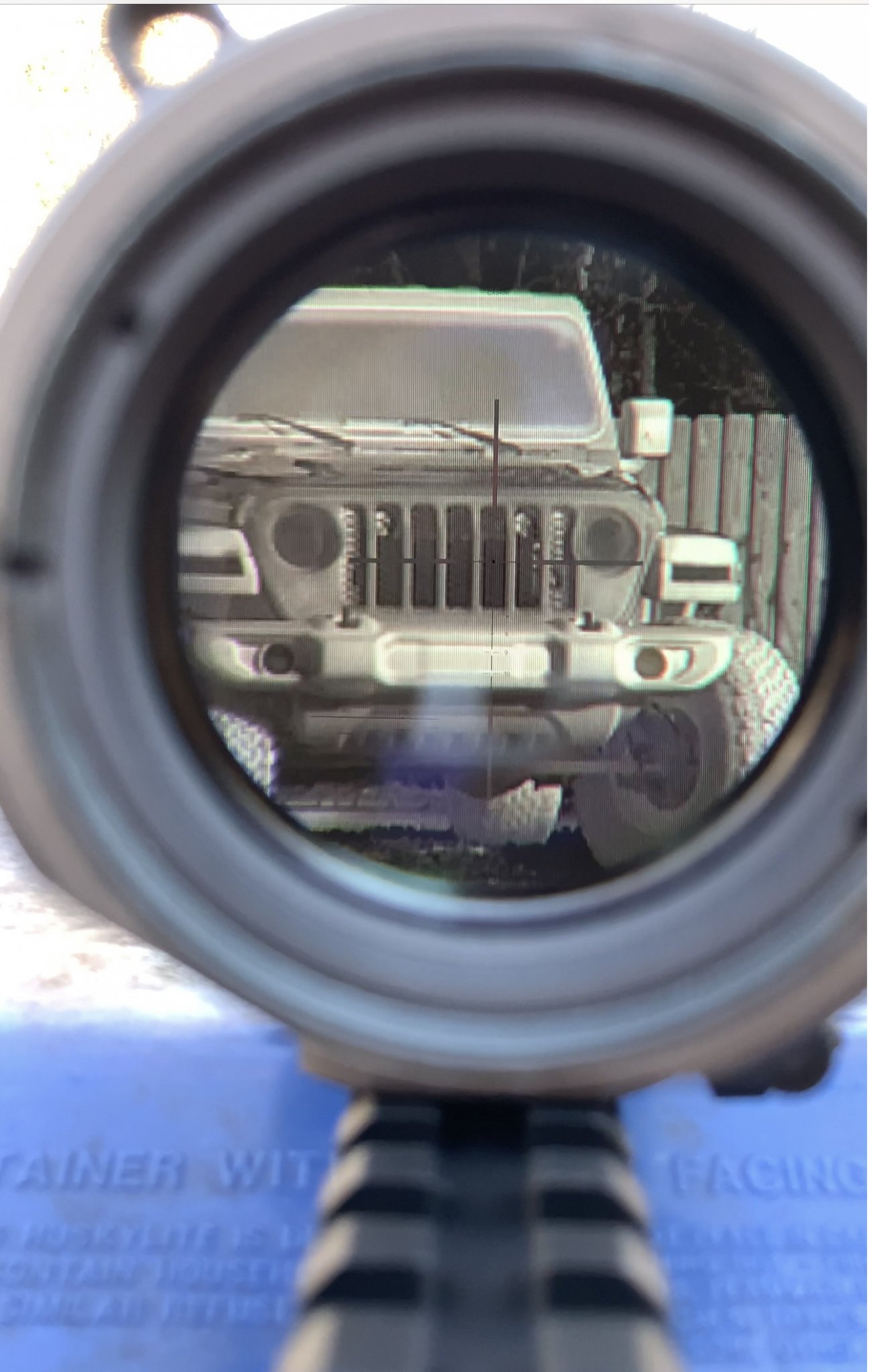

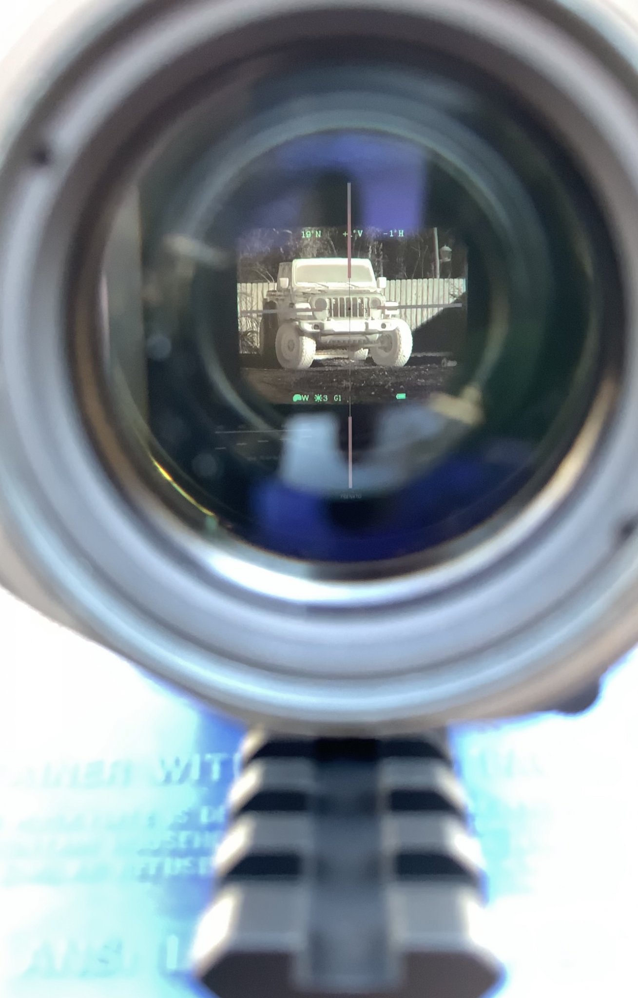

Here’s two pics from the Hogster C I had…
looking from behind an Elcan at 1.5x and 6x (Jeep is at ~50 yards)
I used it as a handheld scanner with the clip on lens and a clip on (obviously).
When I look at the pics I kinda wish I hadn’t sold it.

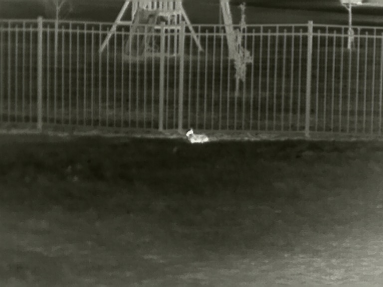

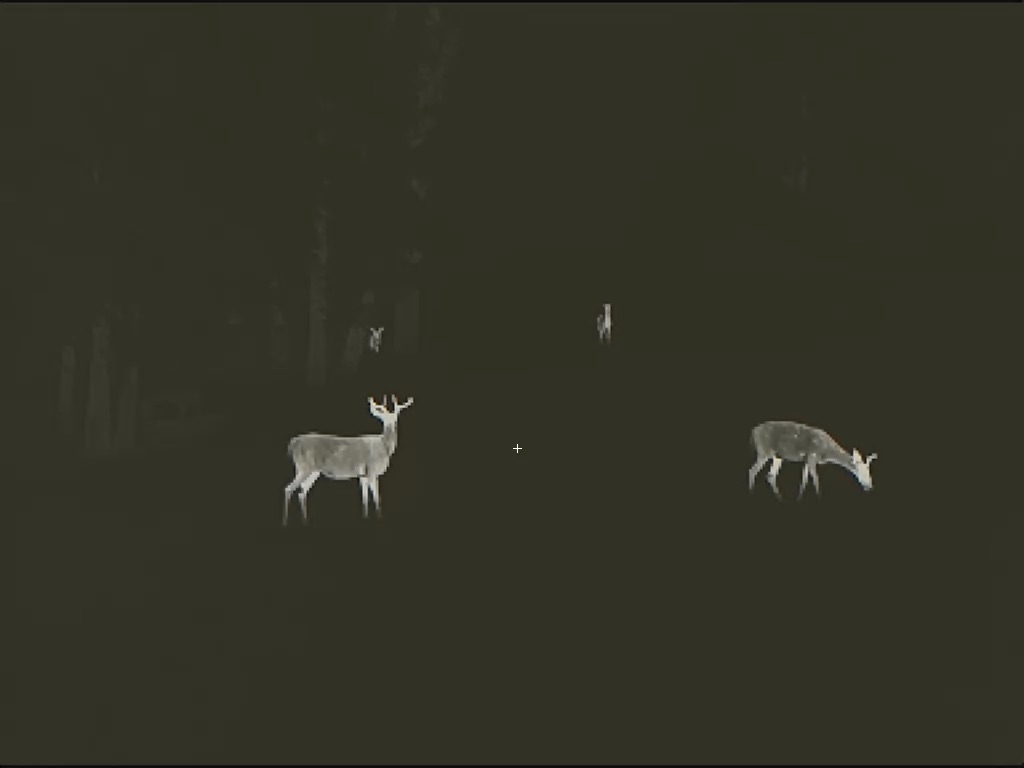

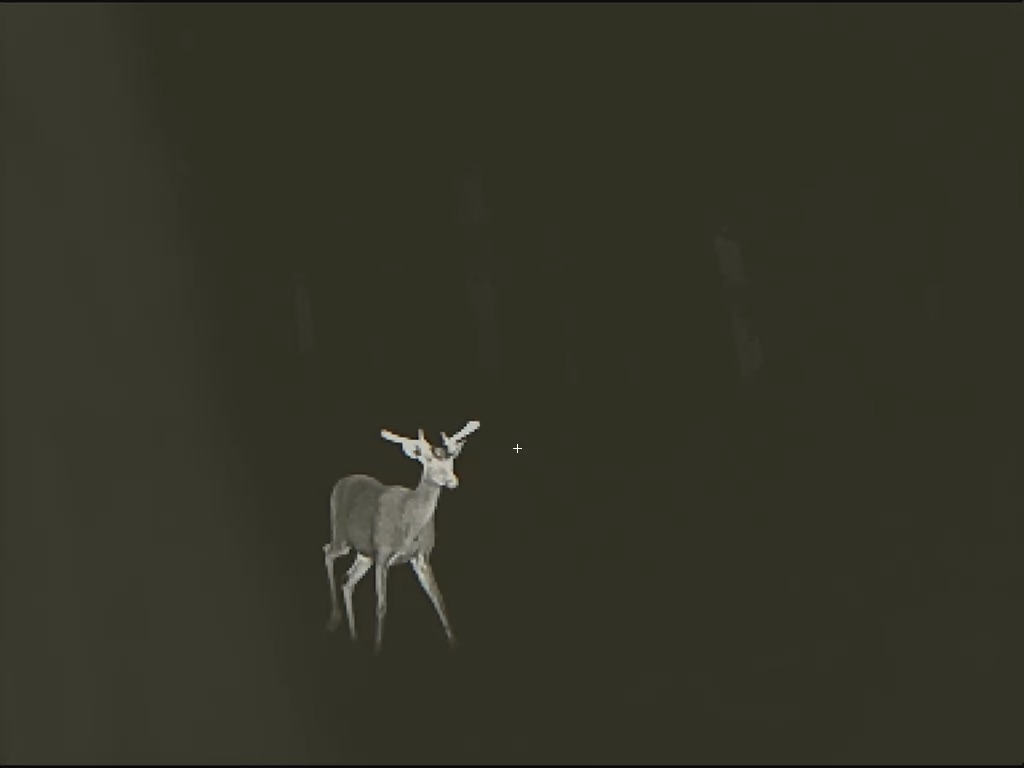

A couple of pics here from use.

What are the approximate distances of the animals in the above photos?
Rabbit was with the monocular, 30 yards.
The deer in second pic was with the Rico Bravo, the velvet buck was 40-50.
The third pic of the group of deer, again with Rico Bravo, and closest deer was 60-70 and the farthest ones were ~100.
Give or take a few, I’m approximating a little.
