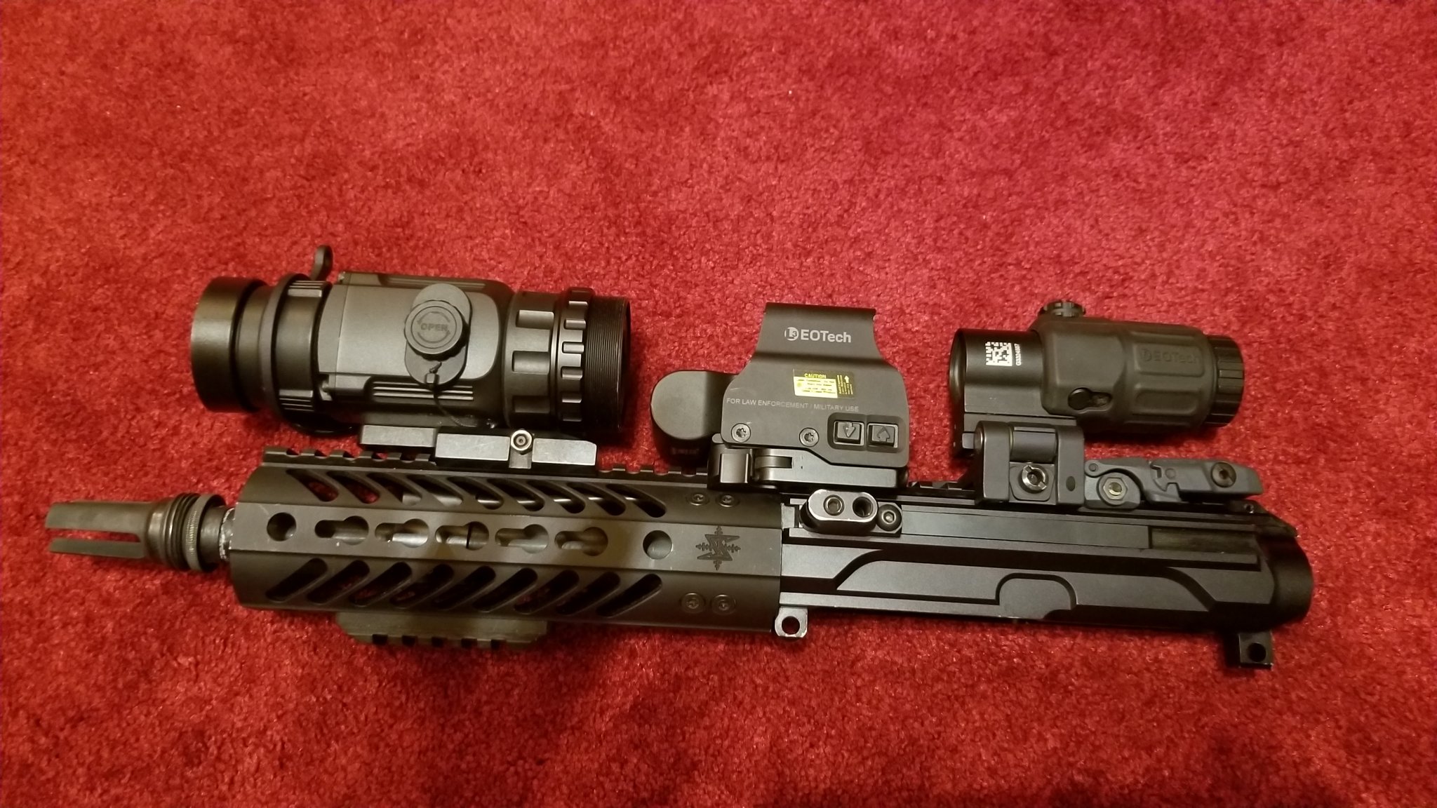

    I’ve got an Eotech EXPS3 mounted in front of a 5x magnifier. I’m looking for options of mounting a thermal in front of this. Is this even a possibility? I already have a Pulsar Trail XP50 scope on another rifle. Is it as simple as mounting this in front of the Eotech?

    I threw my Hogster-C in front of a Eotech and 3x, and it works. Kind of, field of view is small without the magnifier, with the 3x even smaller.
    Since you can get a thermal with a QD, why not swap sights instead of clip on? Below is a Hogster 35mm, Cheaper too!
    Clip on in front of Eotech and magnifier is poor performance, better to swap the Eotech for a thermal when needed. Mine has the Bobro QD mount, very repeatable POI.

    5x is a lot for the lower cost and smaller footprint options. Using a clipon with a wider field of view means you’d be throwing away a lot of the image outside of what the 5x magnifier can see. There’s some footage of what the VooDoo-S looks like through a 3x towards the end of my video here.
    That’s got a 15deg horizontal FoV, so I’d be looking for something in the 5-10deg range if you really wanted to use the 5x. The SY-C or AGM TC50 might be decent, but sounds like Old Man above wasn’t a huge fan.

    The eotech magnifier does not have the same FOV as a scope of the same power. The clip on is considerably farther away from the objective making the screen appear smaller.

    If I'm understanding you correctly you're wanting to put your thermal scope in front of your eotech. This will most likely have poi issues and I doubt it has a function to compensate. You will need a clip on for this.
