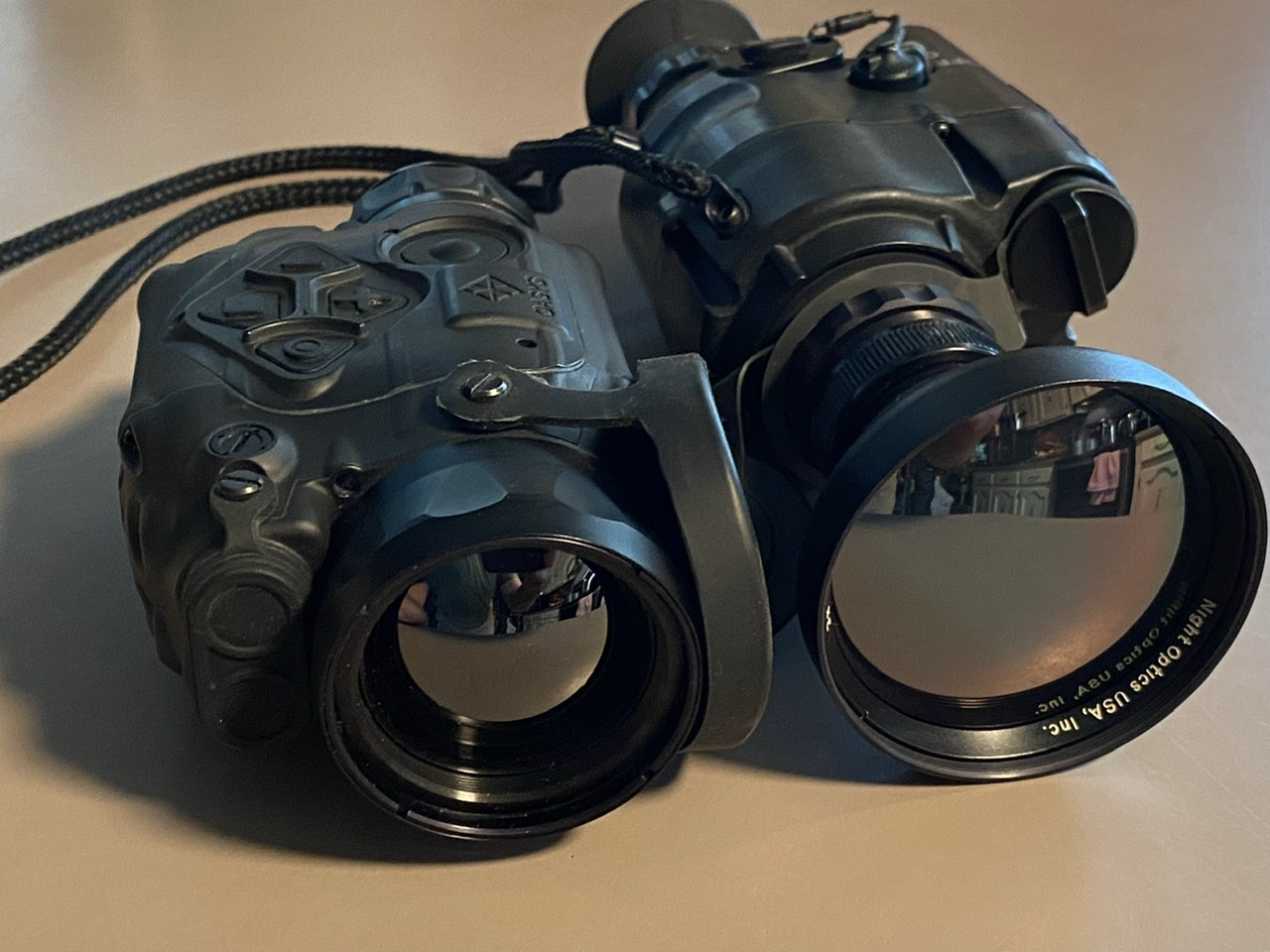

I have a Nox 18, and it will meet your needs. I looked at the Pulsar Accolades (in person at a demo), but this is superior IMHO due to its core. I use this for driving the ATV at night or stalking, and then I switch to the Halo LR.

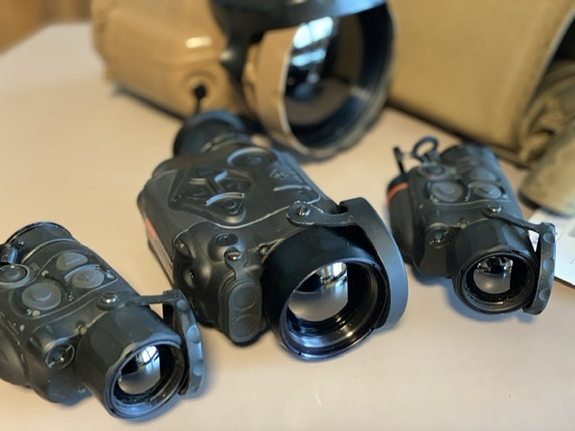

I’m somewhat of a fan of the Trijicon/BAE stuff when it comes to monoculars.
But I also like the Flir M18 Recon as well.
(3x magnifier installed)
Reactions: stefan73 and EWS6
