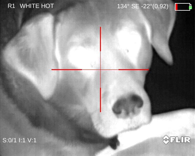

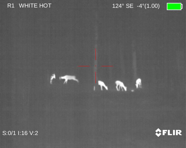

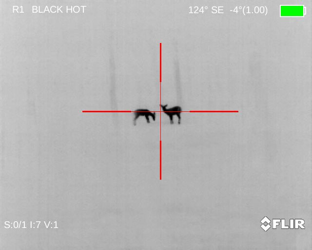

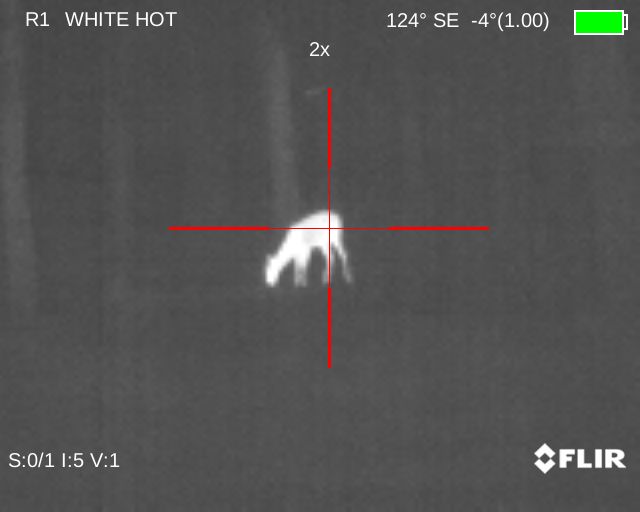

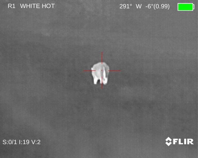

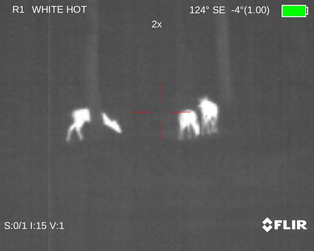

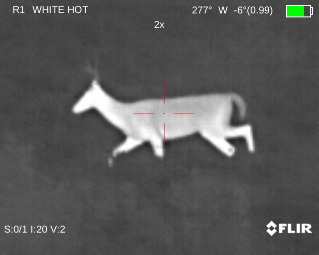

I just recently bought a FLIR Thermosight PRO 536 mainly for hog hunting and secondary to find downed game. It has been pretty good so far. Haven't used for hog hunting yet, but I have used it as a hand held while deer hunting heres a few pics.
