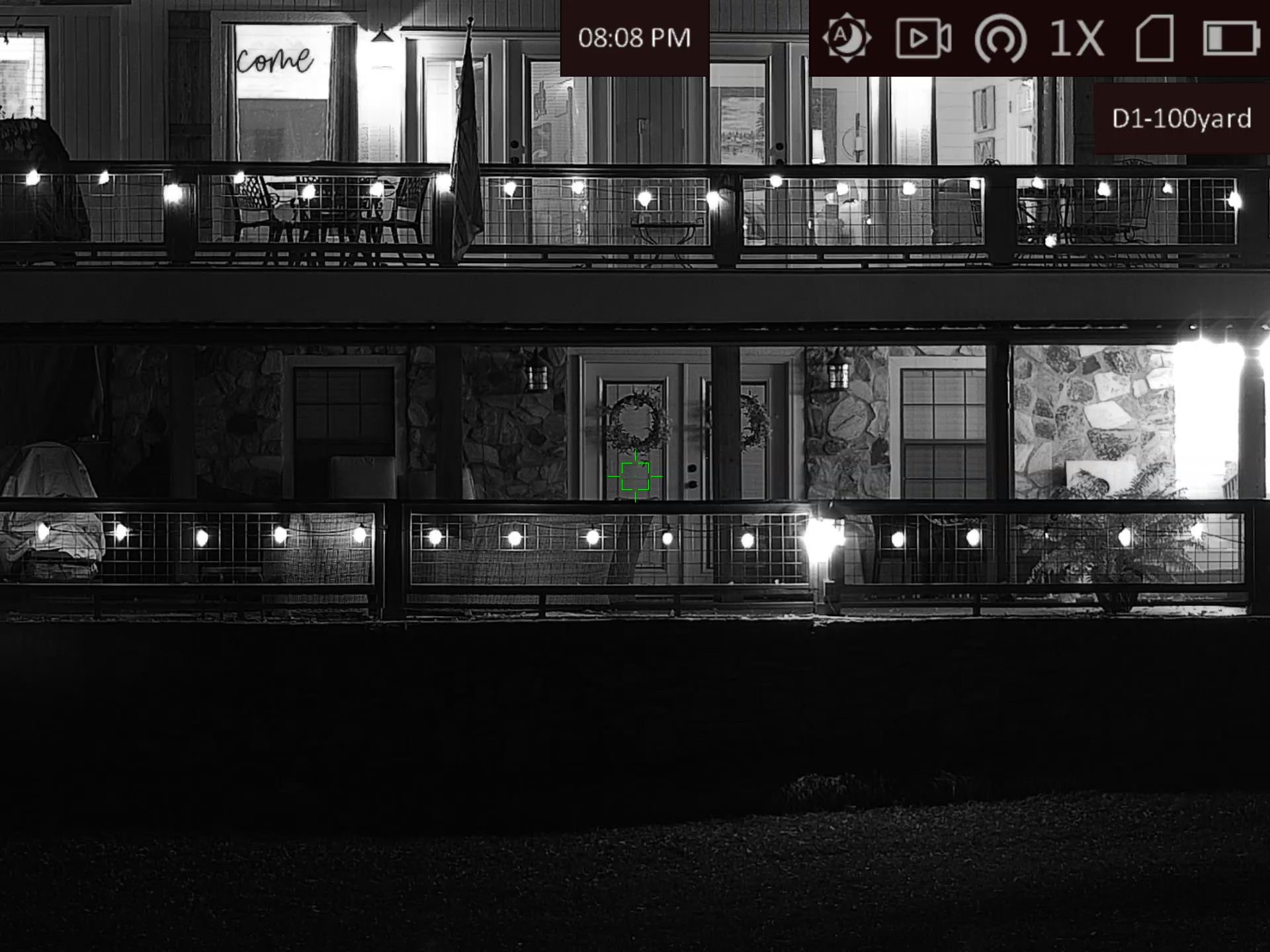

    Owning both, here’s how I feel about them…
    If you want to be able to really see in pretty sharp detail (photograph-like) then get a really nice NV & IR light setup.
    If you are more interested in detecting heat signatures (animals) no matter the atmospheric conditions with a fairly good background image quality, go with a high end 640 thermal.

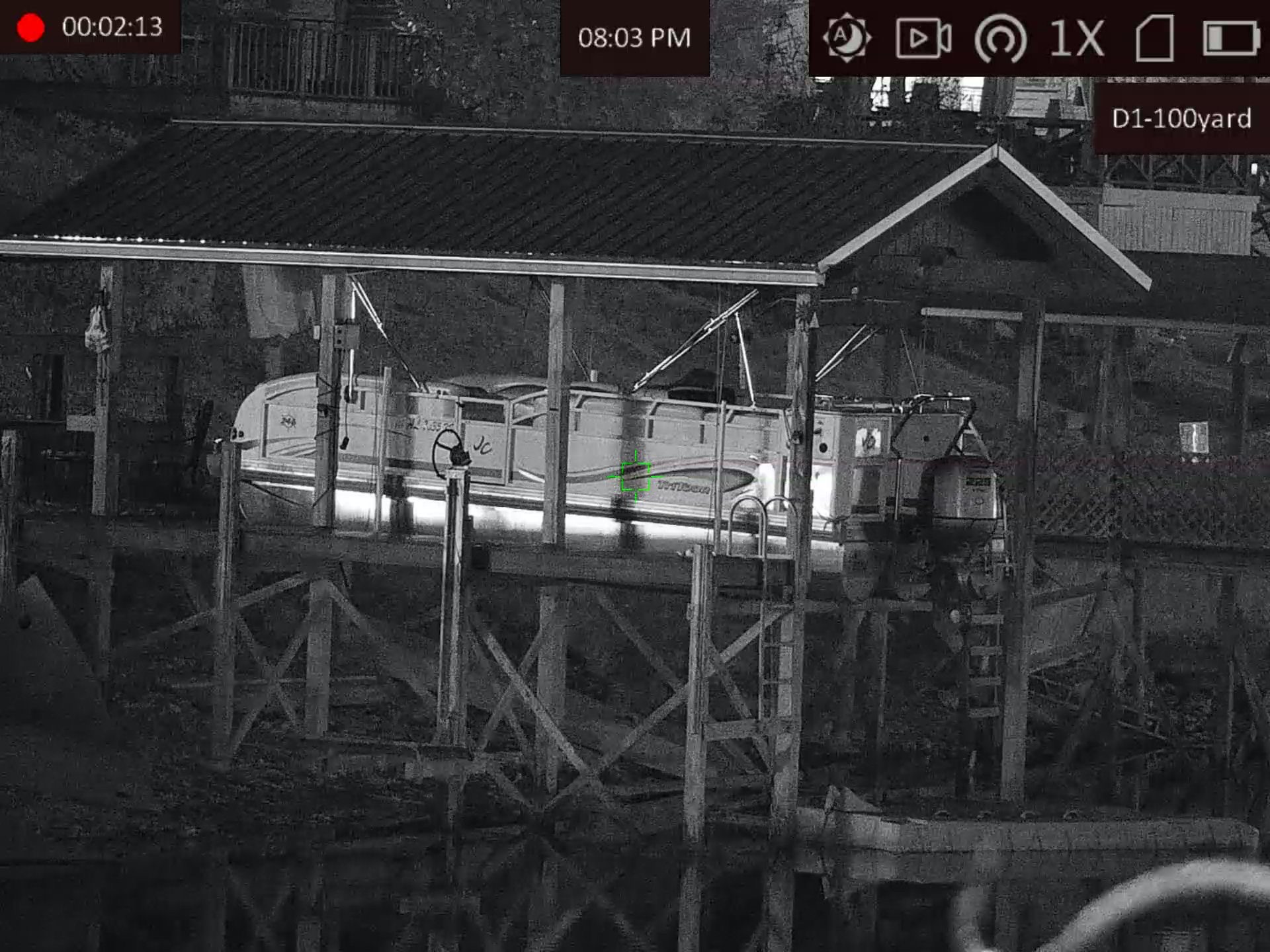

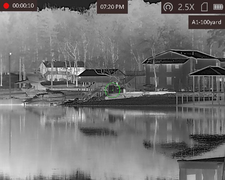

    A buddy of mine killed a deer right at dark Friday evening. We went deep into the woods to get it, but blood trail was virtually non-existent. He made a good shot on it, just didn’t bleed hardly at all. I took the thermal with us, so I went and got it out of the gator, and in just a couple minutes found the deer’s residual body heat signature glowing black in the cold creek 35 yards from impact.
    NV (AGM Neith DS32-4MP $900)
    Thermal (AGM Rattler 50-640 $4,000)

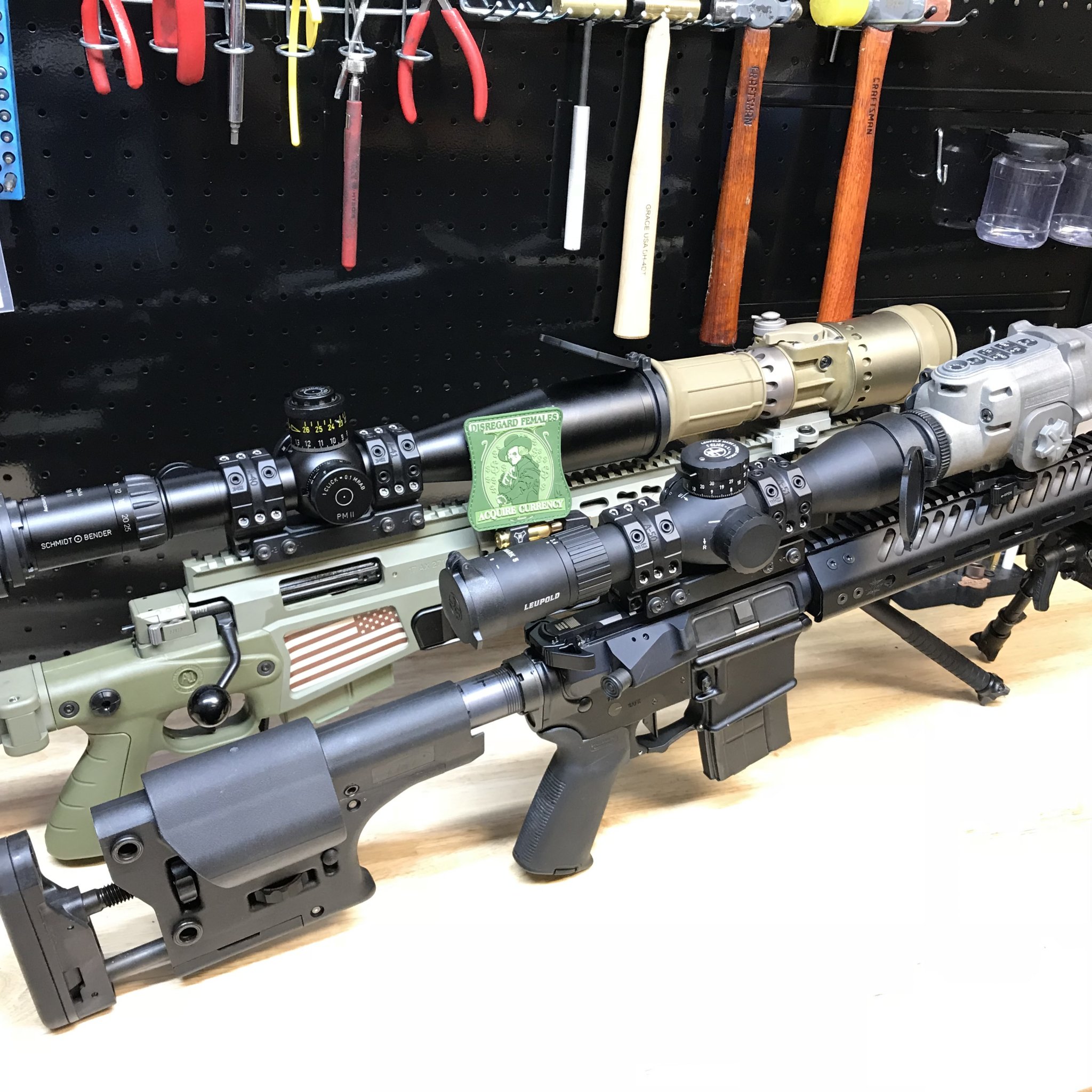

    Thermal clip ons worth owning can’t be touched under 8k-10K or so. At minimum LWTS which can be had for 8K used but will be a little limited on magnification to 8-10x ideally. LWTS-LR or UTCX are where it’s at but you’re talking 12-20k. Even with a thermal clip on you’ll still want something handheld to scan with too.
    You can get a clean 24LR for 6-7K and then get something as simple as a breach for a little over $2K to scan with or spend more for something badass like a M250/M300, Skeet, UTM, MTM, etc. I really like the MTM’s with the IR laser for a more budget scanner because they’re tough as shit and you can get them used for $2500 or so. Most are only 320 units but I’ll take a 320 L3 over any imported 640 unit. Advantages to the NV clip on are ID being able to tell a coyote for your neighbors dog and the ability to run a WMLRF and see the IR laser on it for range.
    You could buy both used for good values and sell whichever you like the least, not be out with anything and know you made the best choice for your uses and preferences.

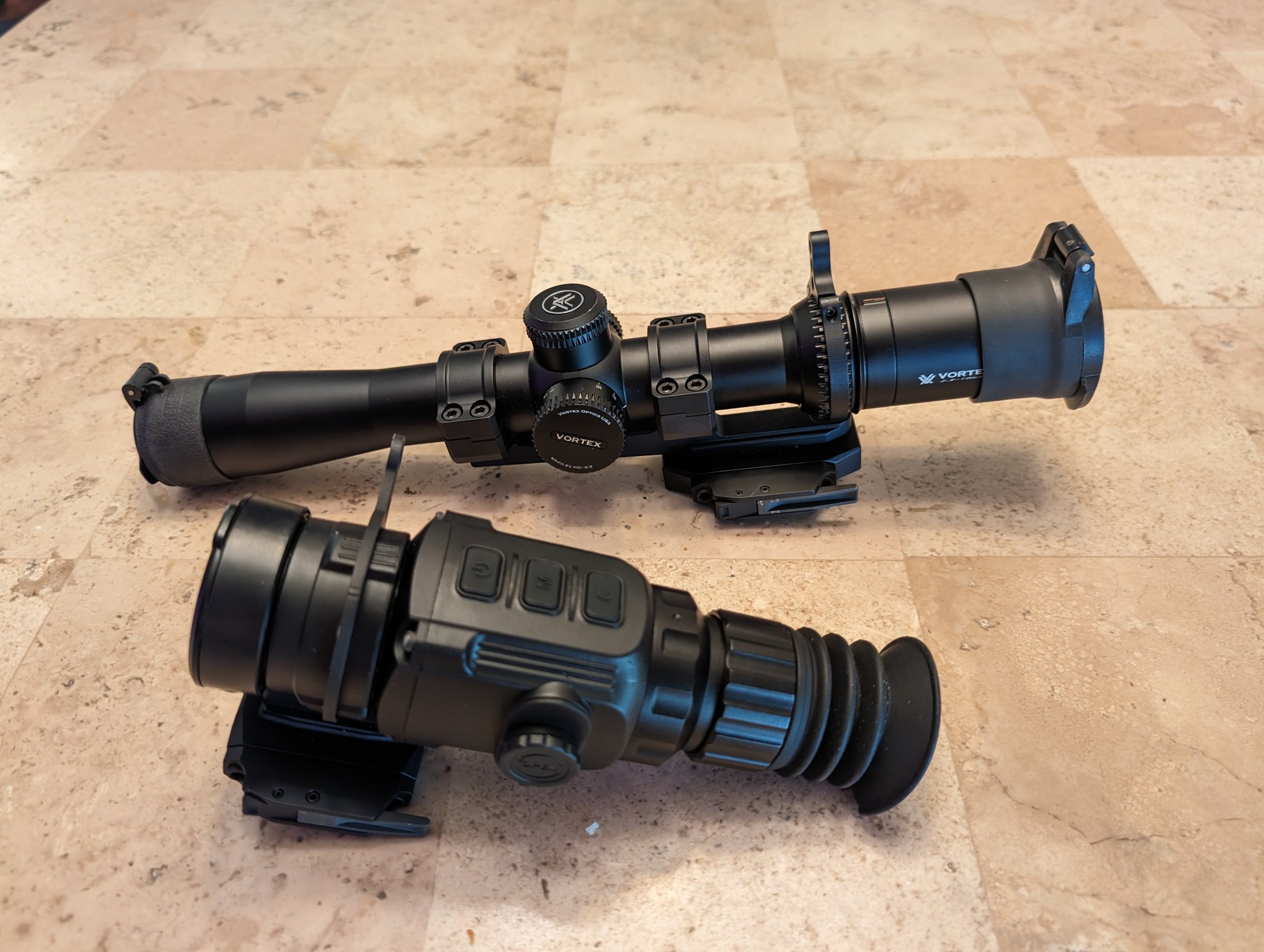

    Make sure you understand the limitations of your scope with a thermal clip on. I have a Hogster clip on, so this may not apply to all brands.
    Magnification of 2-3x will show you the screen in full, anything more you are looking at a smaller part of the screen and the image gets pixilated. If your reticle is first focal plane, see if you like it at 2-3x for the ranges and game you hunt. I can go up to about 6x with mine, but lose image quality and field of view.
    I much prefer switching to a dedicated thermal over the clip on.

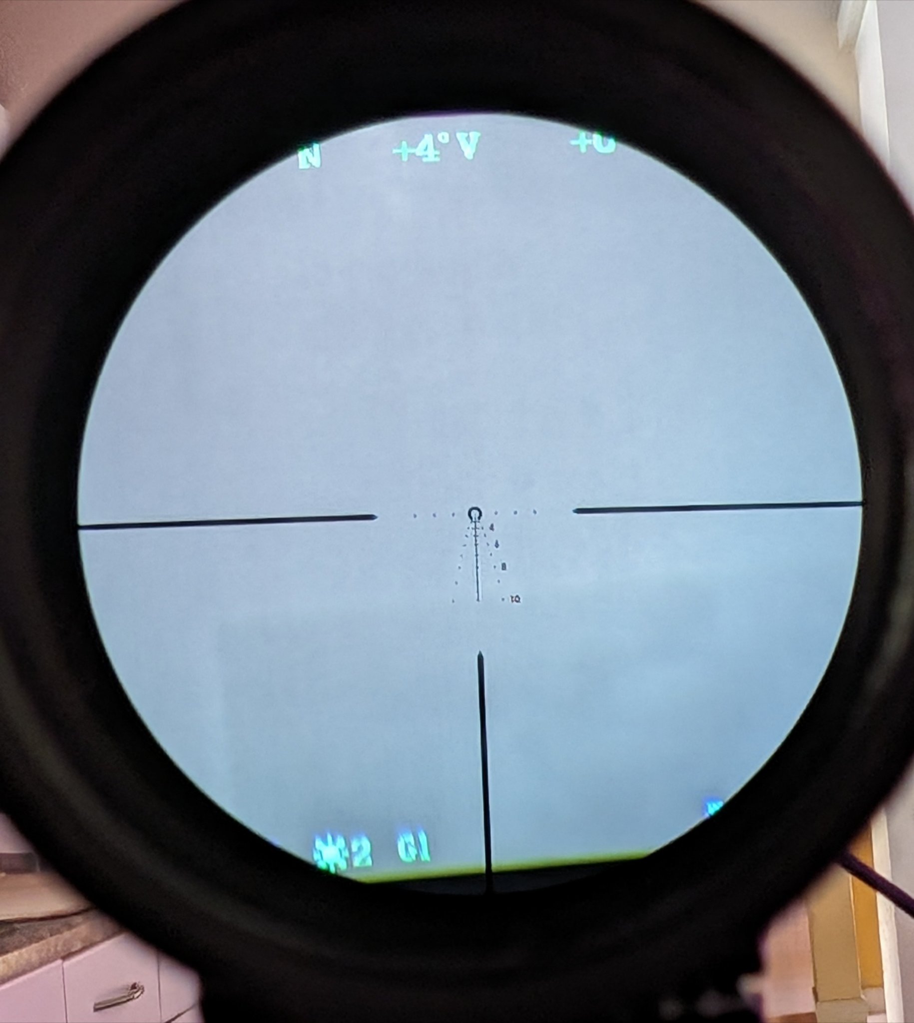

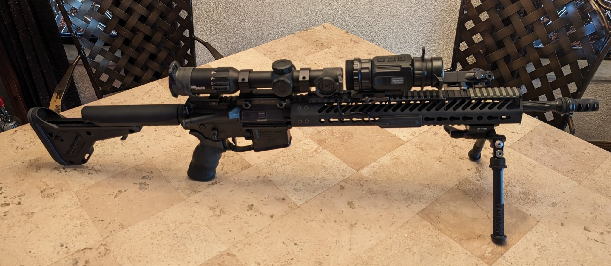

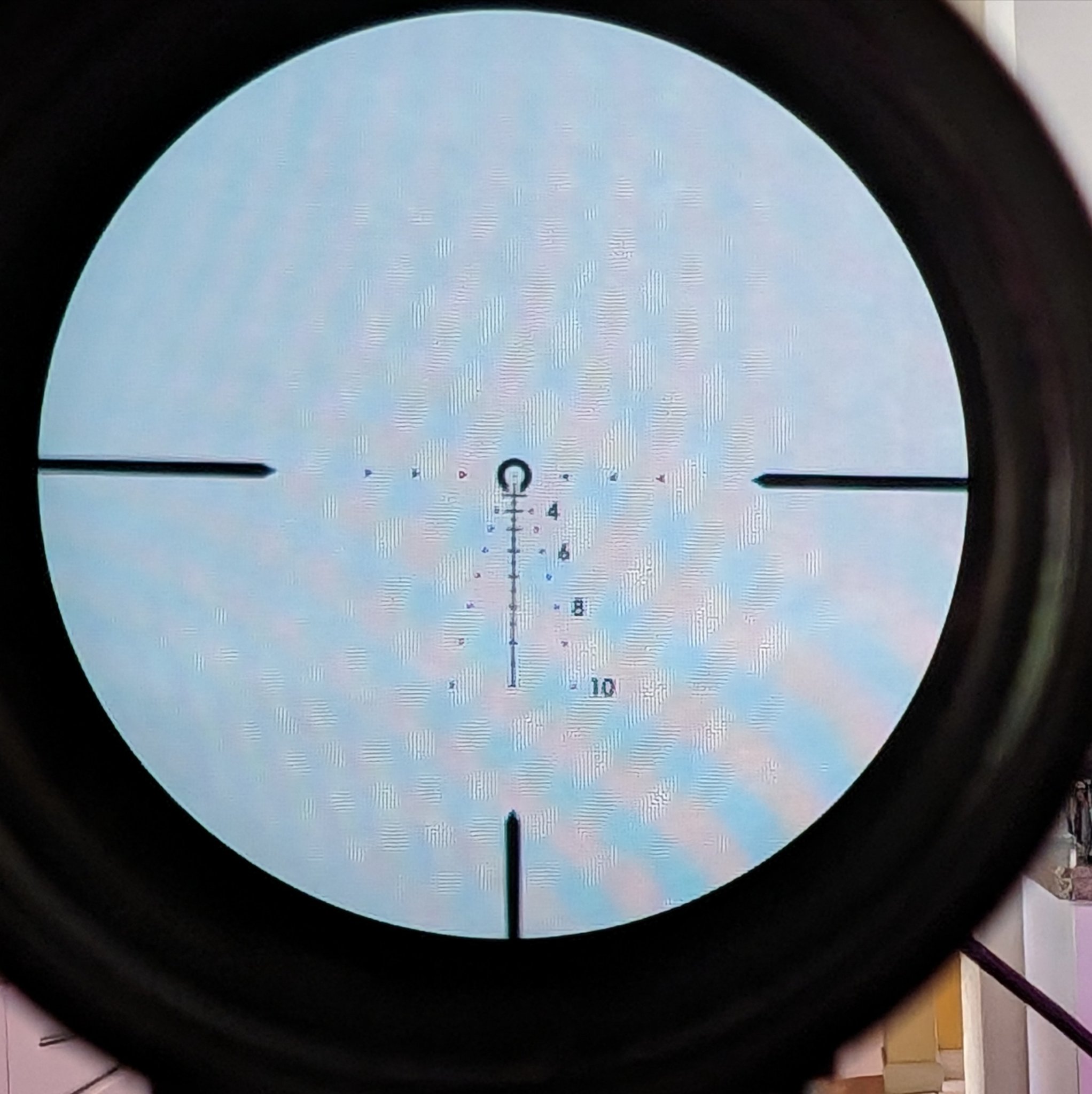

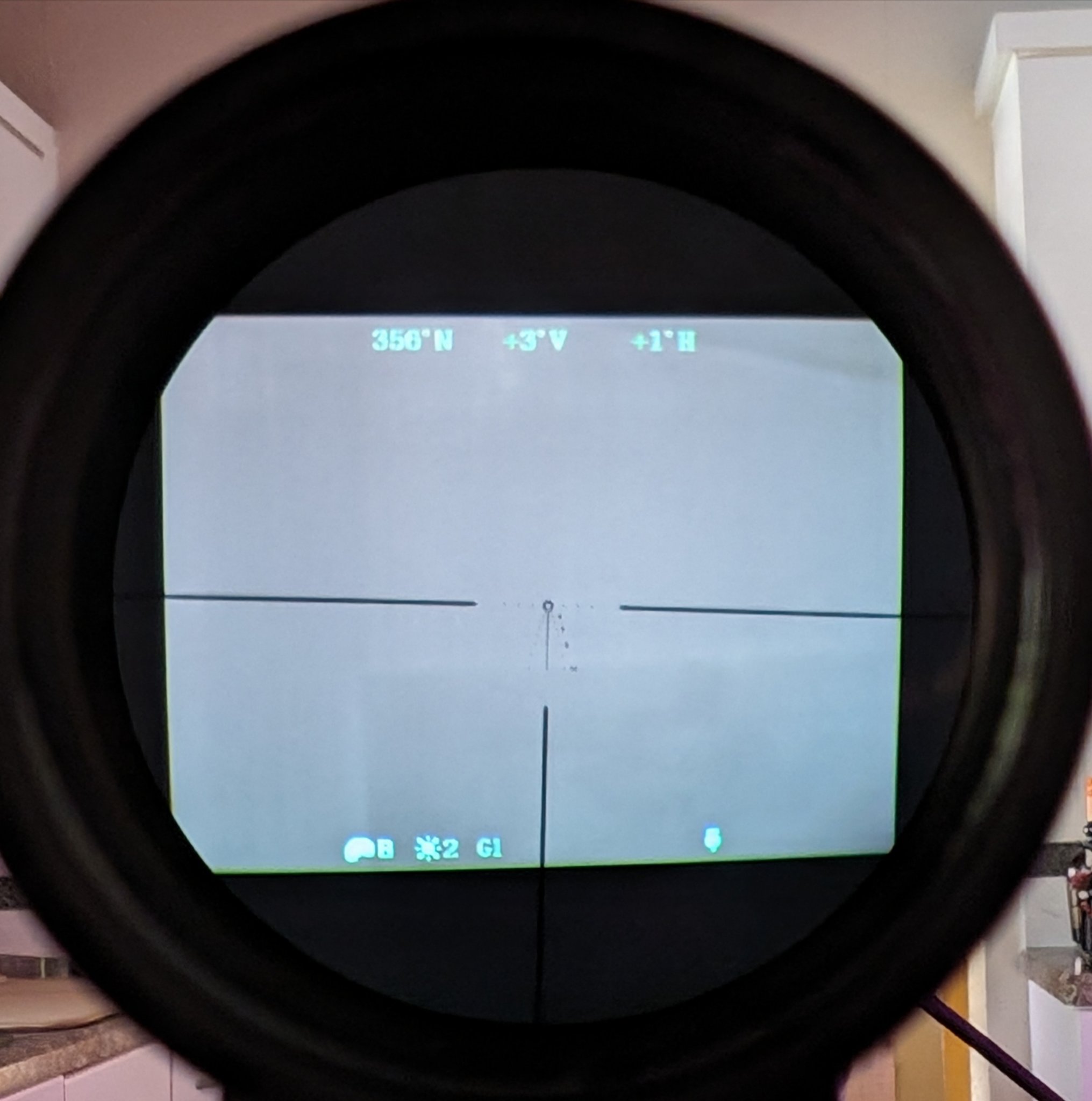

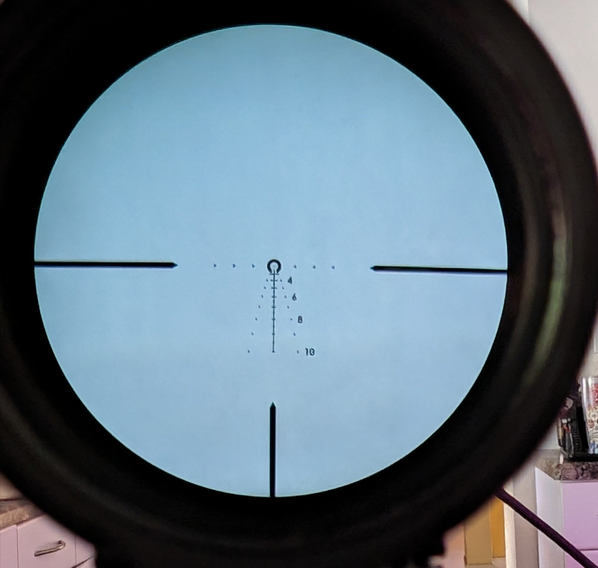

    This is my 6.5G with 1-6x Sig Tango 6 FFP and Hogster Clip On.
    Yes picture quality sucks.
    See how far forward the clip on focus is even with a LPVO?

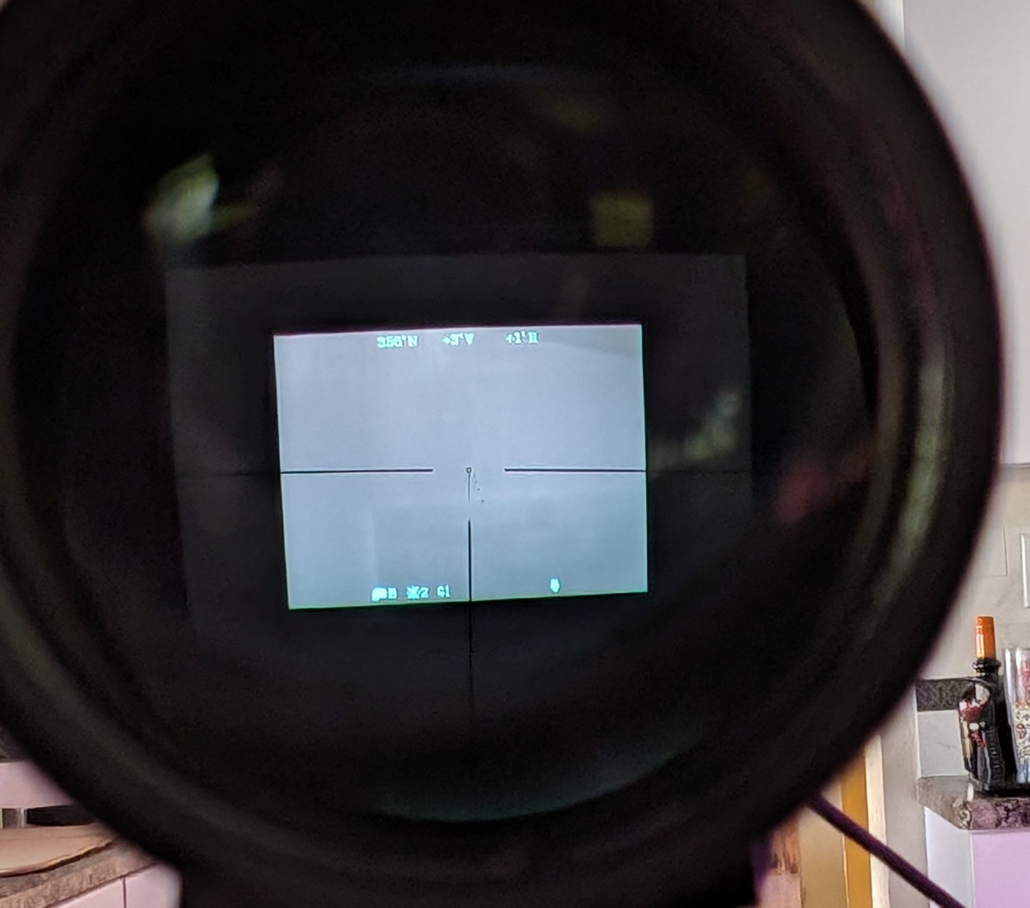

    At 1x screen is small
    At 2x can see all of the screen and important setting details around edge.
    At 3x starting to lose edge info and FOV. Image quality is actually about best here, max resolution while seeing full screen top to bottom, what you lose is the result of a round window on a rectangular screen.
    At 4x missing edge data and may not be able to see enough of drop menu to make changes.

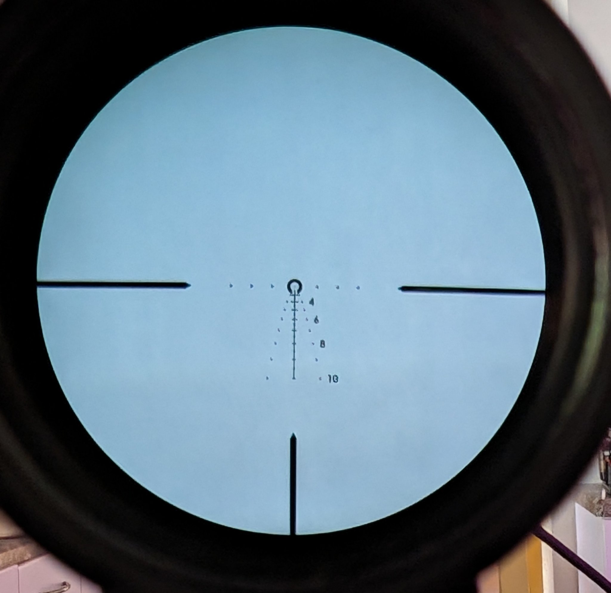

    5x
    6x reticle is nice, but FOV, image is the trade off for magnification.
    Point is, not having less than 4x would be a deal breaker for me, half FOV, half resolution and can't see display to know or change settings.
    This clip on is ideal for a 1-4x or 1-6x, FFP or 1-4x, 1-6x, 1-8x SFP.
    Swapping QD Optic and QD Thermal back and forth is a much better option. Better balance and reaching the focus for thermal is not a crazy stretch to front of handguard. Usually less money also. If I had it to do over I would not get the clip on.
