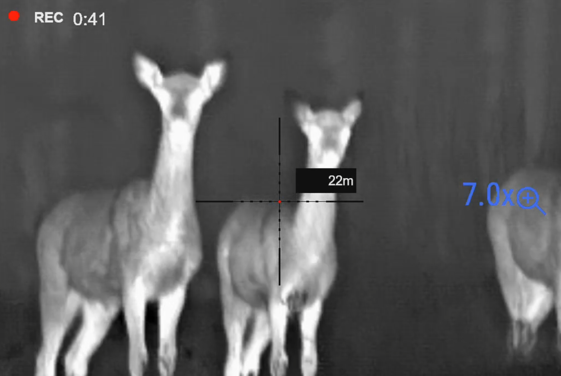

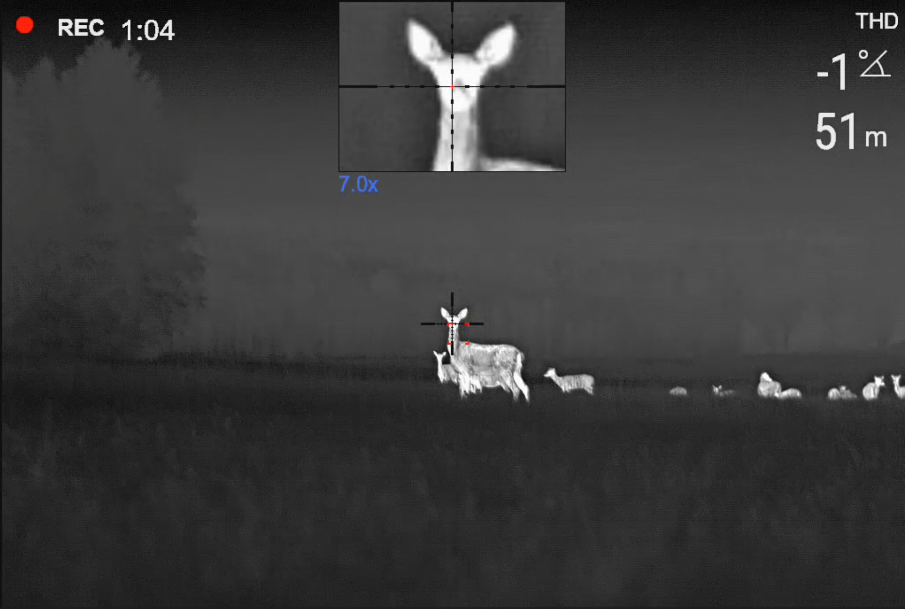

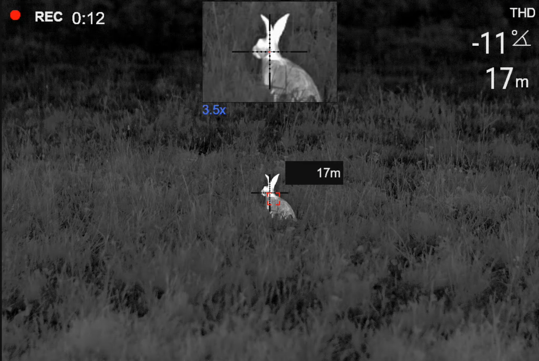

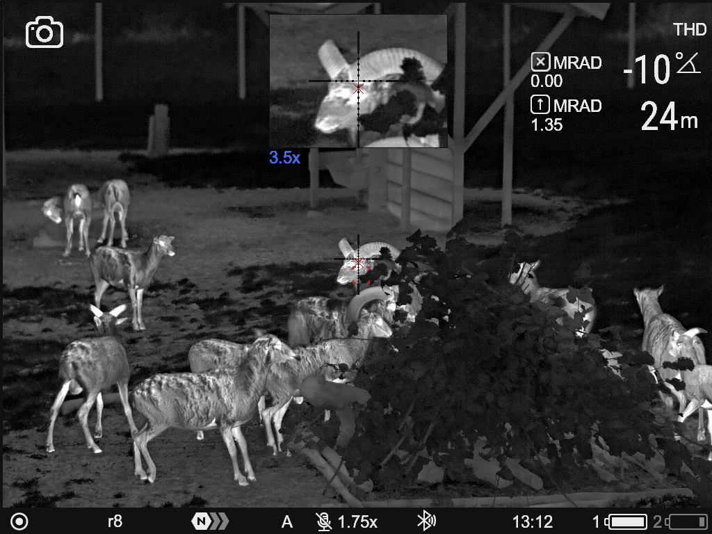

For the past month or so (perhaps longer), I've hade the pleasure to play around with the new Pulsar Thermion 2 LRF XL50. It's their first 1024x768 HD Thermal Riflescope.
It uses a Lynred sensor. The same as the Merger XL50, but IMO the image is a bit better (subjective) in the Thermion 2.
Magnification: 1.75-14x Great to have all that FOV!
There's an LRF with a ballistic app. Works really well, I used a Blaser with 300 WinMag, and well, it just works.
There's a also a BT remote control which may seem useless, but place it close to the trigger guard and you can play around with all the functions with your finger.
I have quite a few videos and images.

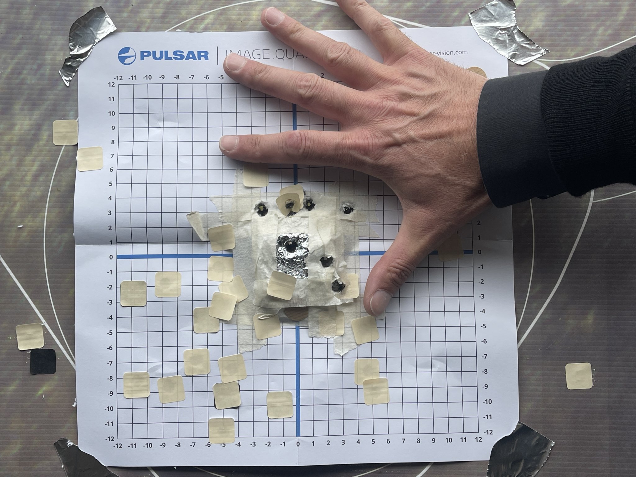

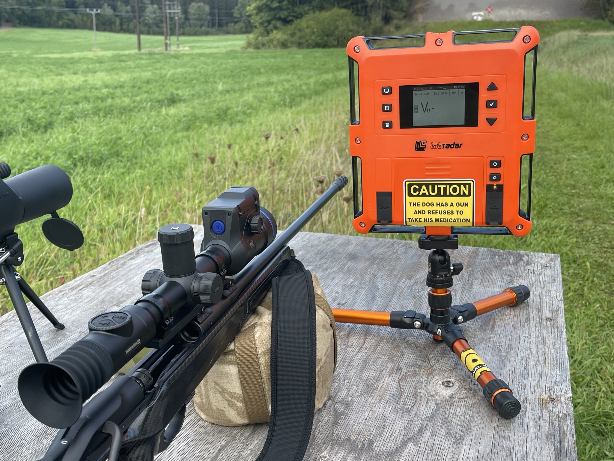

Labradar zeroing at 100 yards. Moose and overview of the area from the video above.
Note HD logotyp and yes, I know, the XL50 turret is upsidedown.

I dunno. The base mag at 1.75 means that at 3.5X the res will be 512x384 whereas the XG50 at 3X is 640x480. It seams like it would make more sense having a base mag of 3X but I think it might be beyond anybodies capabilities at this time.
I guess the best use is for shorter range pig hunting at the base mag with the accompanied wide field of view.
But still, this is a big jump in the industry and it's only going to get better.
