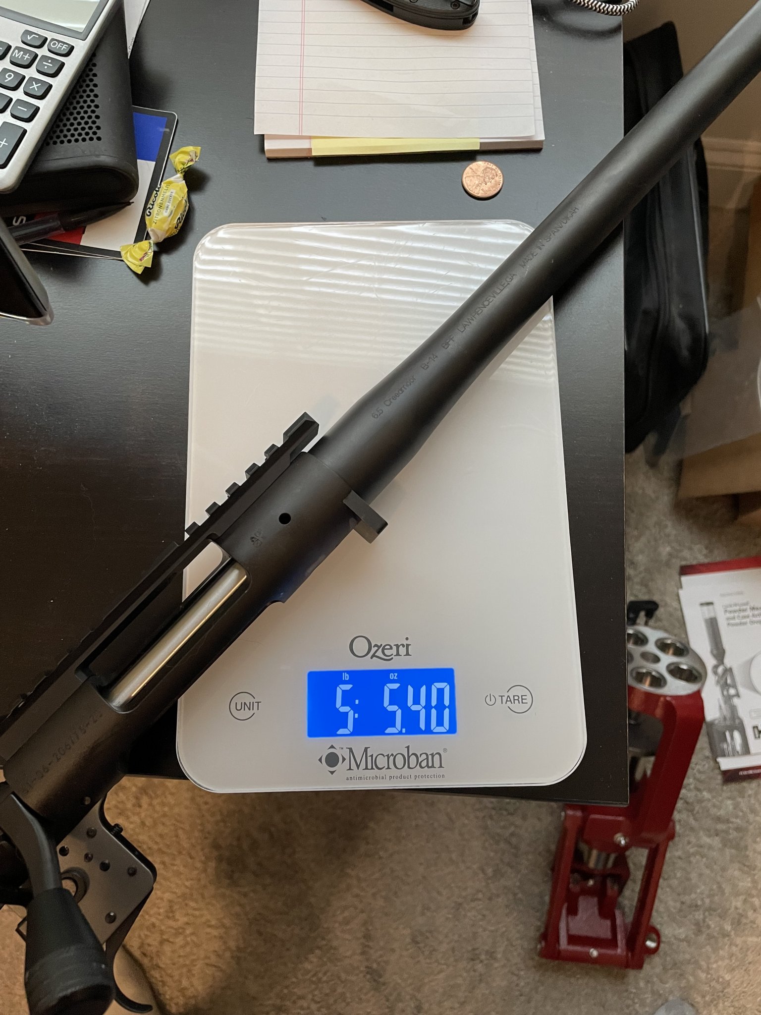

I have a Bergara B14 HMR in 6.5 Creedmoor that I cut down to 18", I like the rifle a lot but frequently find myself wishing it was a little lighter. I ordered an MDT field stock on black Friday sale that I am going to try out. It should save a little weight over the HMR stock if I like it and keep it installed. This got me thinking about other ways to lighten up the rifle a little and wondering about getting the barrel fluted as it is a fairly heavy profile barrel. It measures 0.877" at the muzzle. I pulled the barreled action out of the stock and pulled the scope off and it weighs 5 lbs 5.4 oz.

  1. Will fluting the barrel save enough weight to actually matter or be noticeable? I think if I can save 8 oz or more it will be worth it for me.

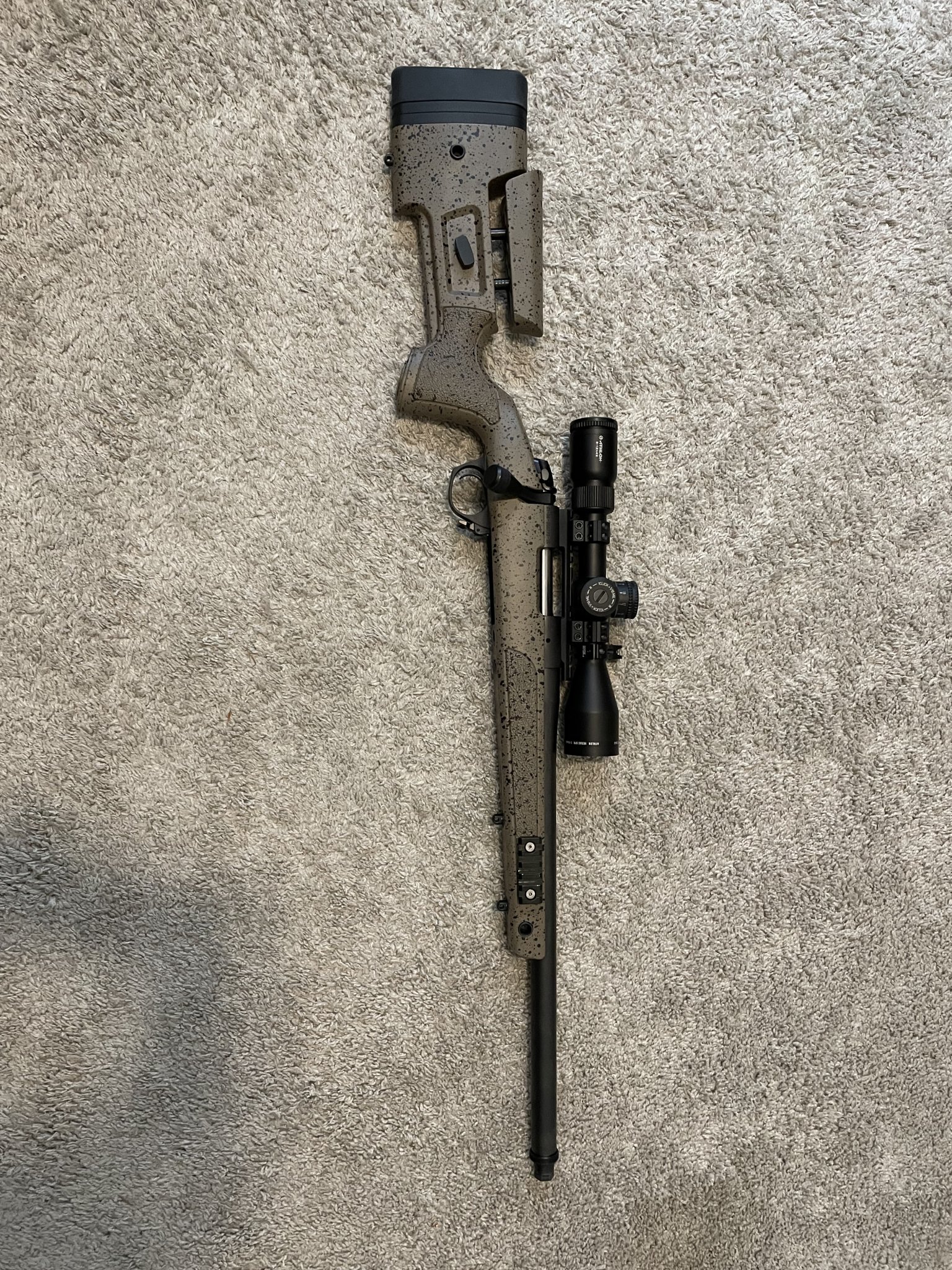

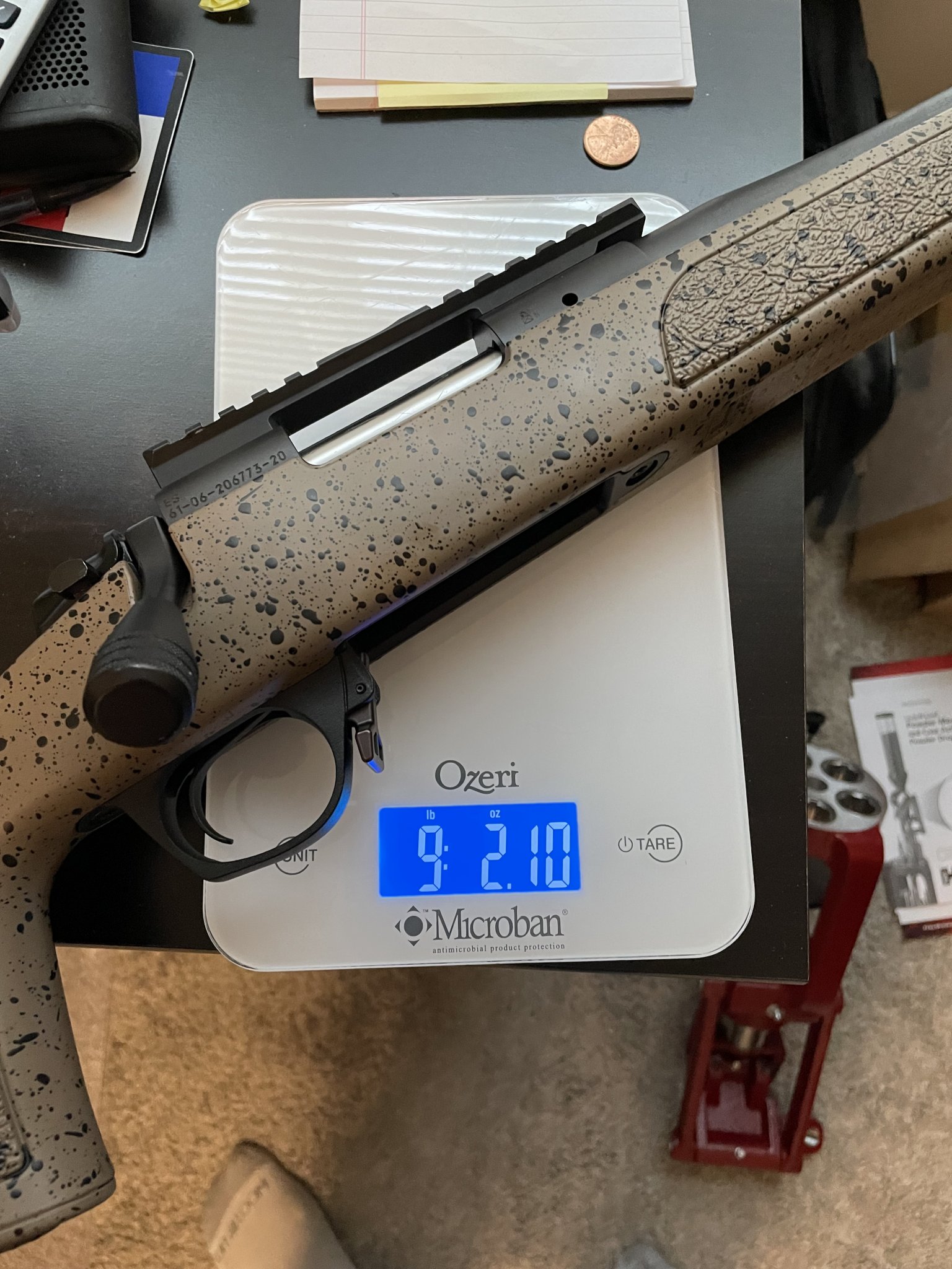

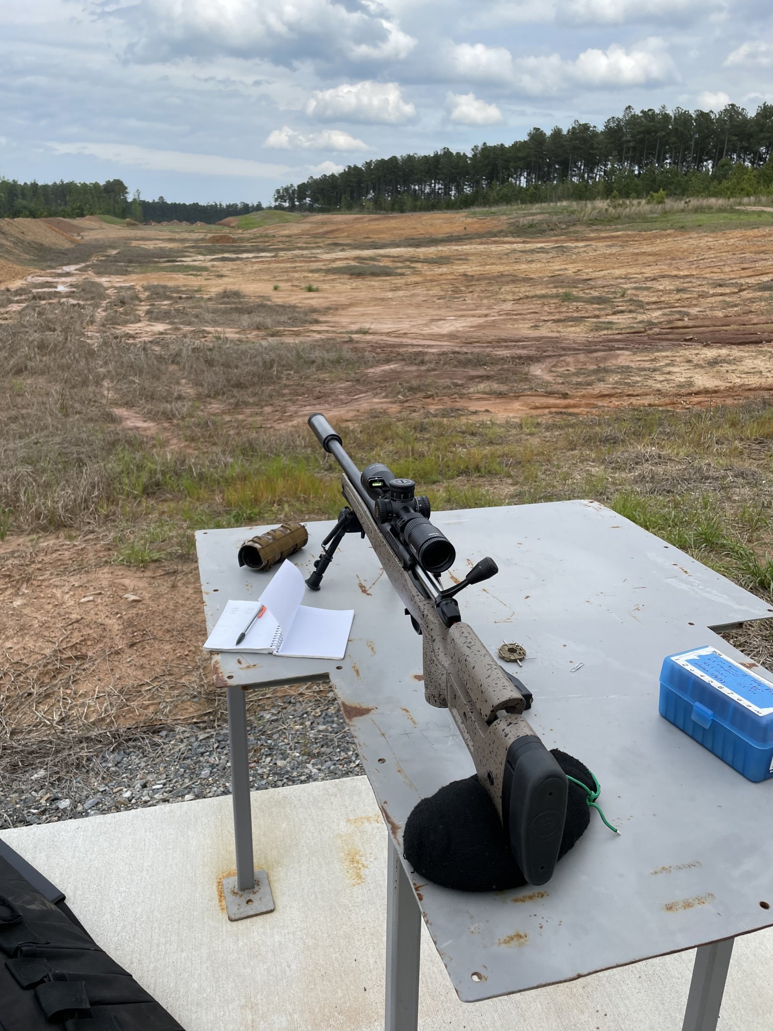

Here are some pictures of the rifle
