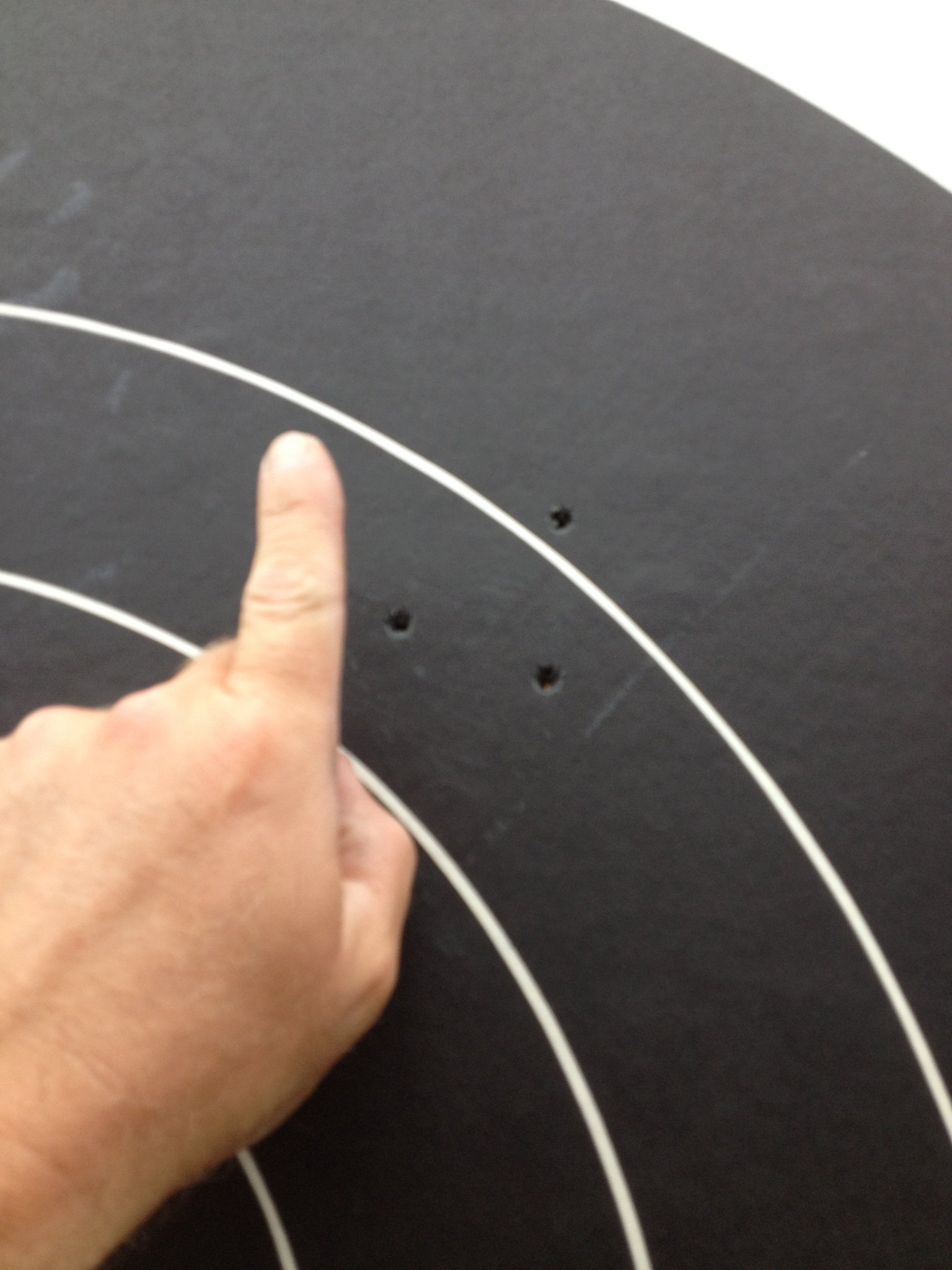

My Custom Precision Firearm 6.5 Grendel w Bartlein barrel is a tack driver at long range. Out to 800 good to go. The way the state laws are going w AR style rifles always keep a bolt gun and a pump shotgun.
600 yards prone off bipod w rear bag w 1-8 scope and factory ammo. Not to bad for a gas gun w Geisselle 3g trigger lol
