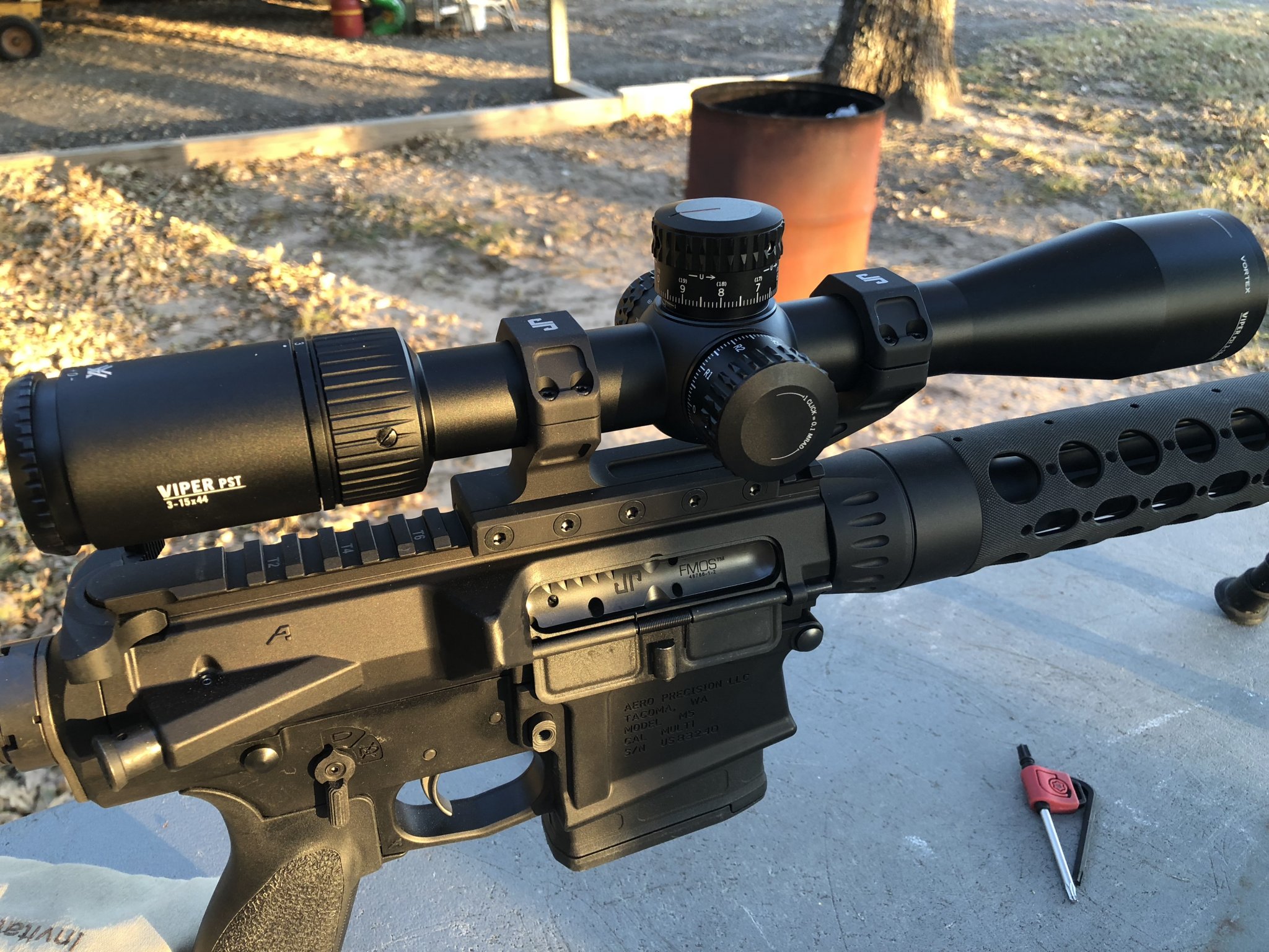

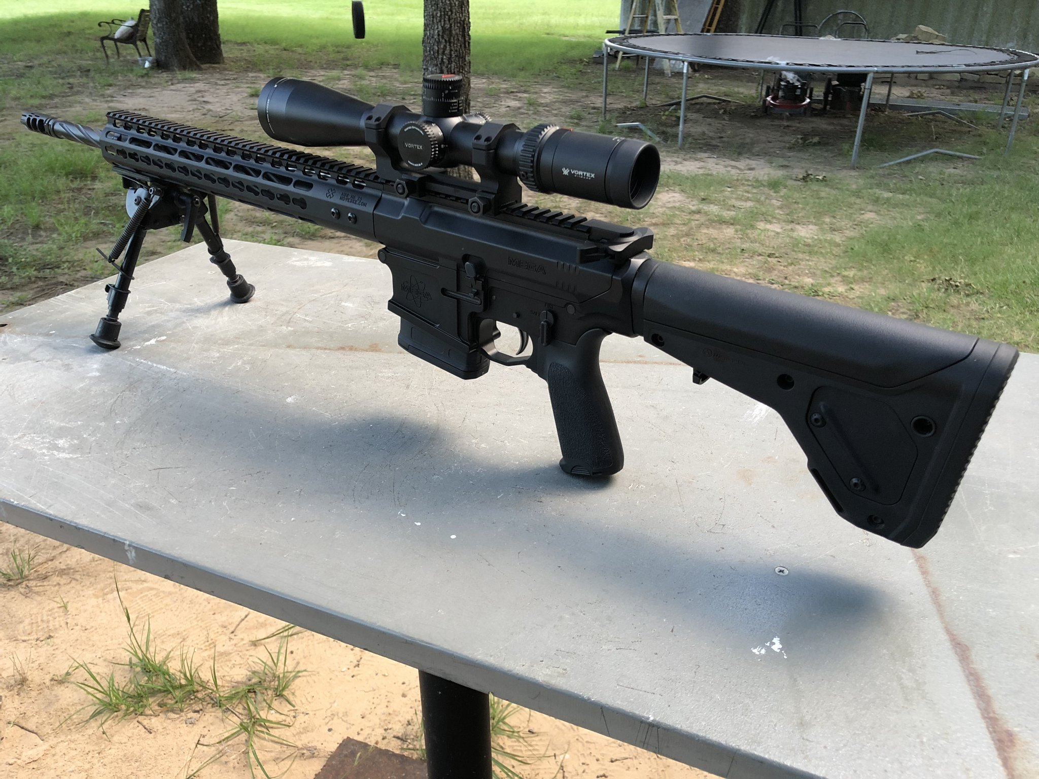

I have two 6 Creedmoor builds. One has a JP barrel on an Aero receiver set and the other is a Bartlein from Craddock on a Mega Maten receiver set. Both use JP HP bolts, Superlative Arms adjustable gas blocks, and H3 buffers in 7 3/4 extensions. The Bartlein is 20” and plus 1” gas. The JP is 22” with standard rifle length gas. What can I say, it was FREE!!

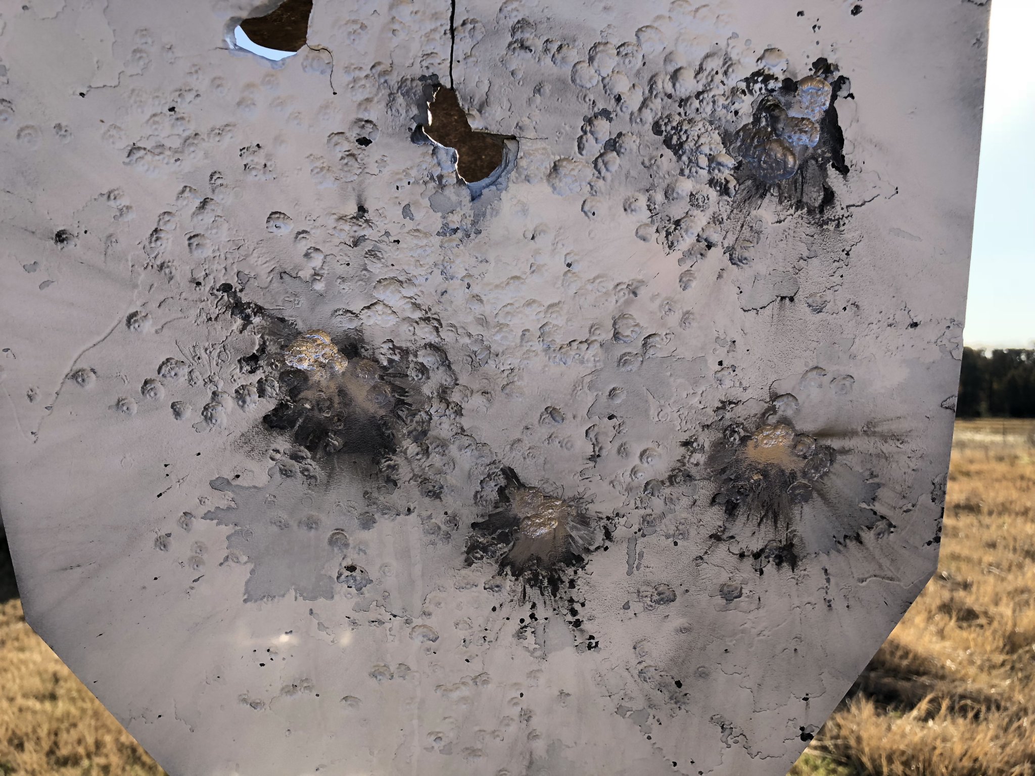

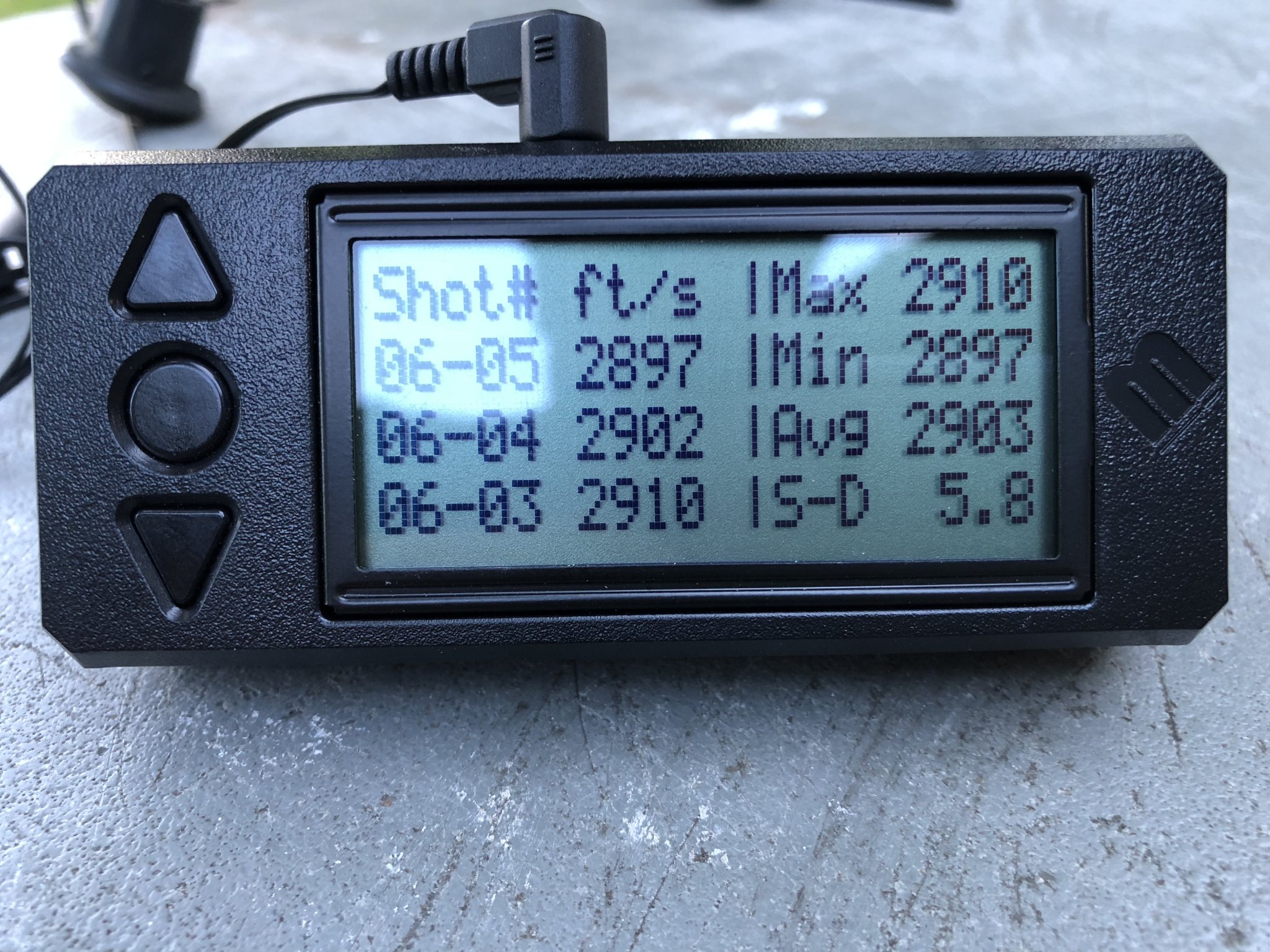

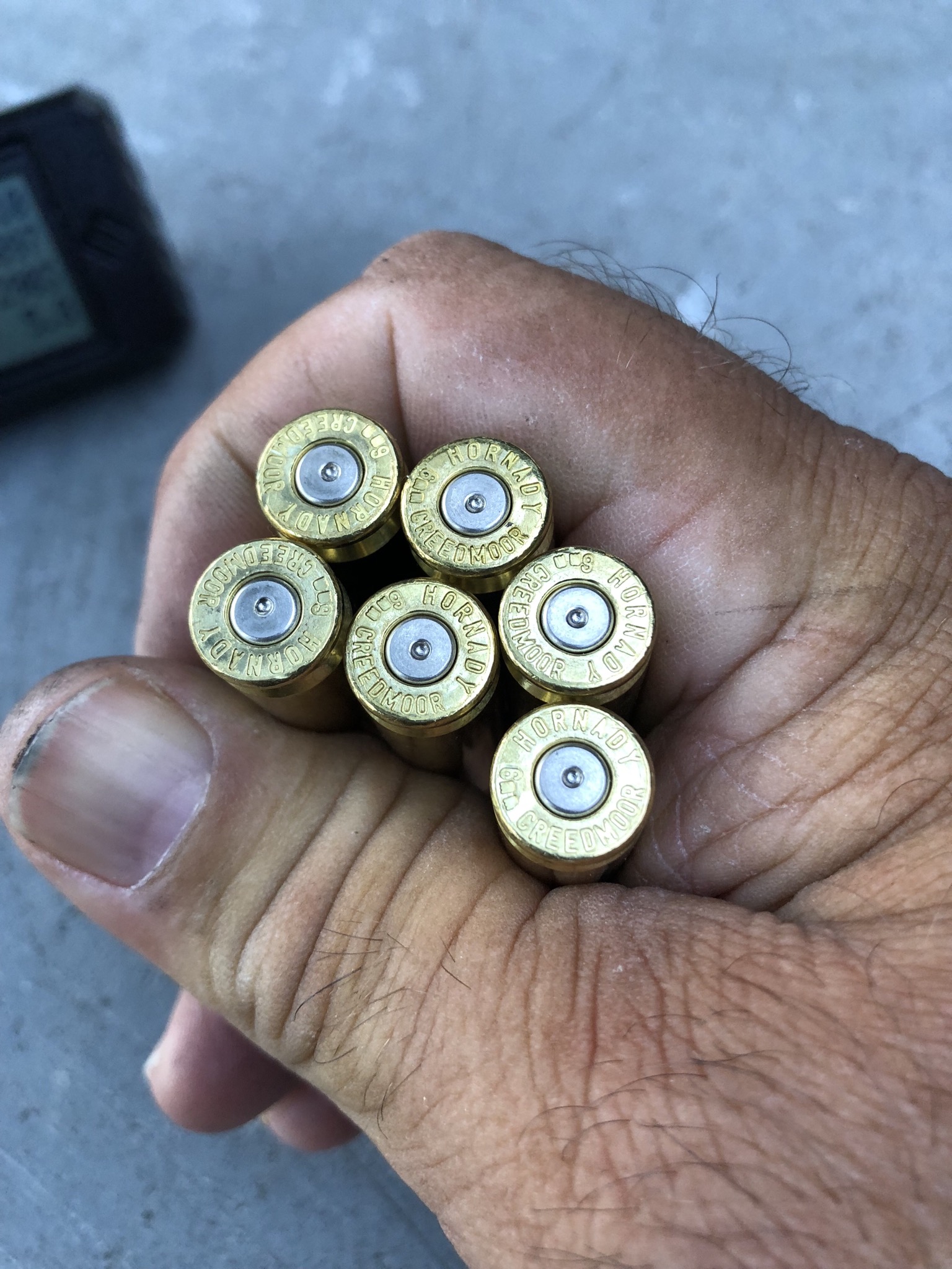

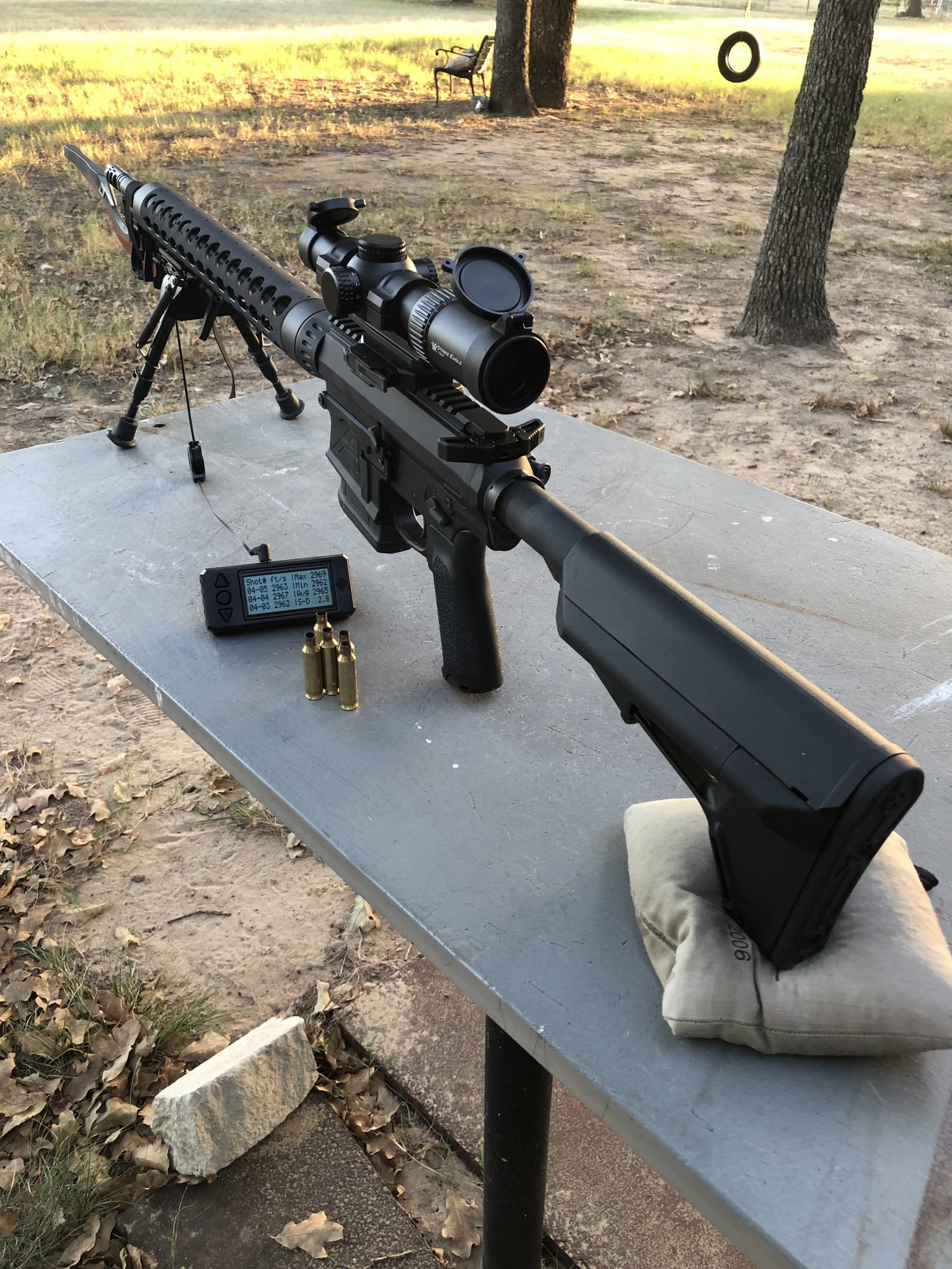

You definitely won’t be disappointed in a Bartlein from Craddock. I sent one round through a cold bore, then five at the same point of aim through the chrono.
105 BTHP with 40.7 H4350
