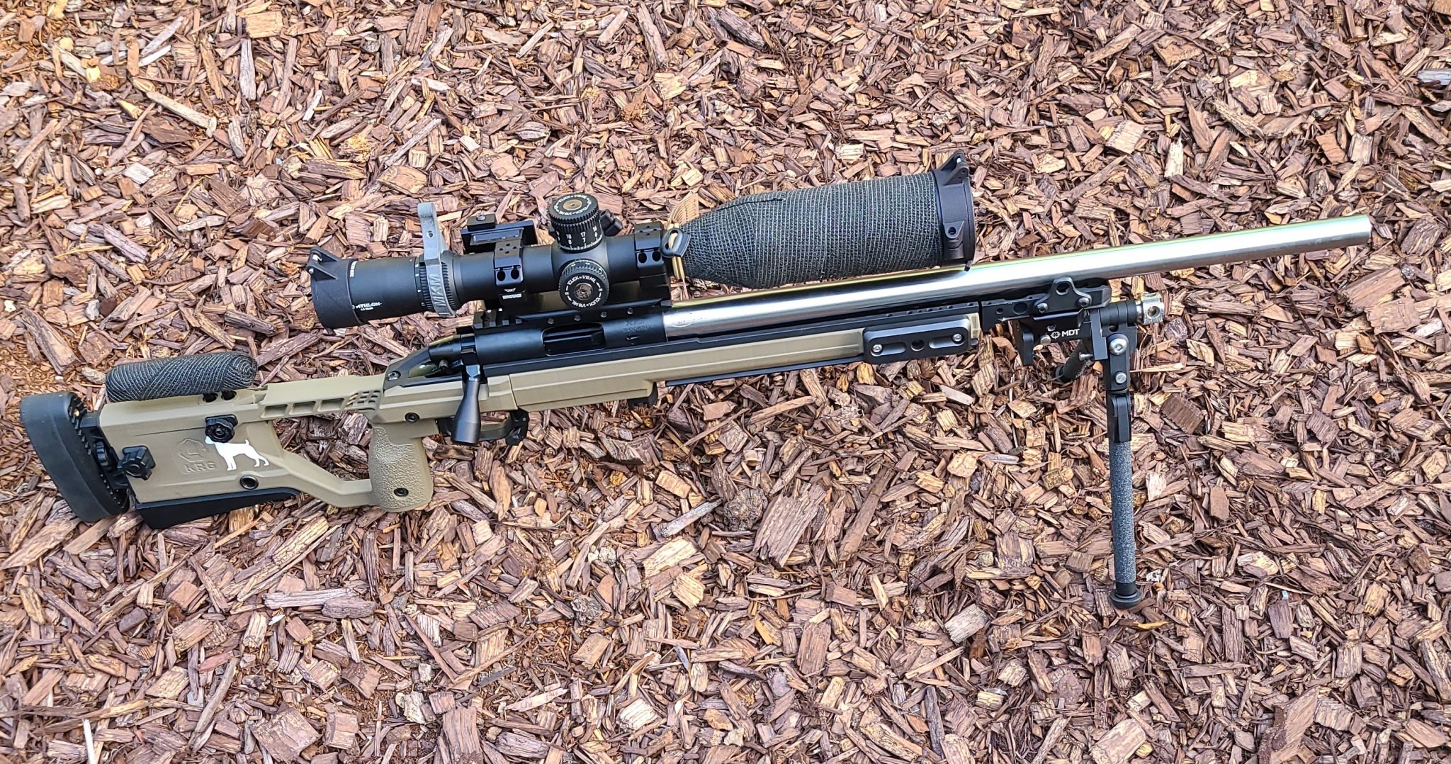

I can tell you my 12 -9 twist barrels out preform my 16t at longer yardage on my Rim X action. I set it up 1st with a Proof 16t 18" barrel shoots .3 to 4ish groups at 50 yards all day long. Out past 300 it's a rock slinger. Same action Bartlien transitional barrel at 25 " will hover around 1 moa at 300 with my best group just over .54 moa at 300. At 600 yards a 18" drum lid is a regular event with it in a constant wind. If the wind is variable , hang on it gets busy I use flags every 100 yards to see shifts also.
I am in a similar boat on the 12t, but I have already started paddling down river!!!
RimX action, bore guide and mags ordered.
PVA Barrel ordered 22" M24 profile.
ATS Tuner order with it.
My dilemma is do I want to start this build now or continue with the Vudoo and play with the 12t until I get it fully going.
I plan to only shoot SK as I have a few cases of different types. I know the tuner will allow me to shoot these lots and get the most out of them.

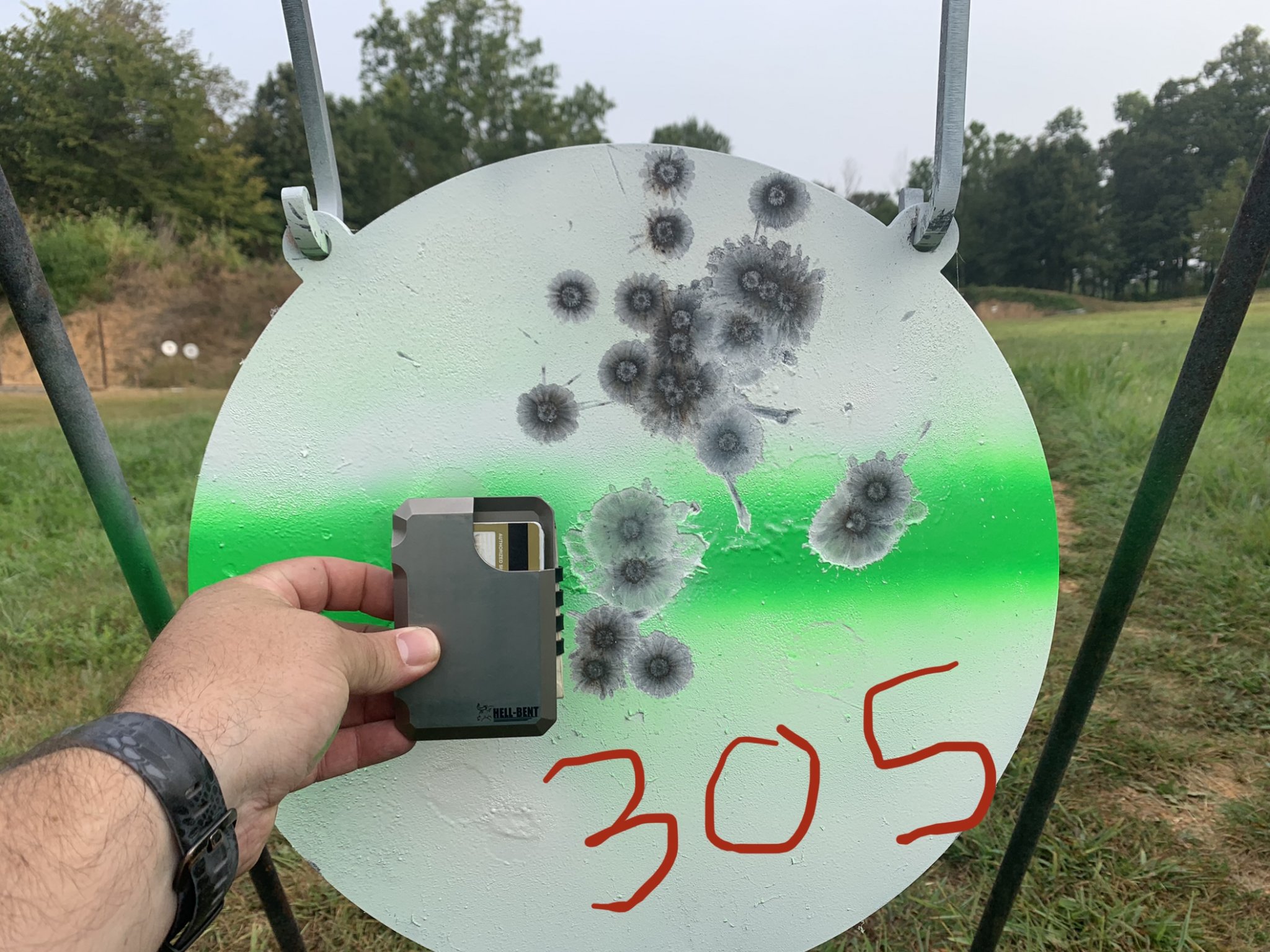

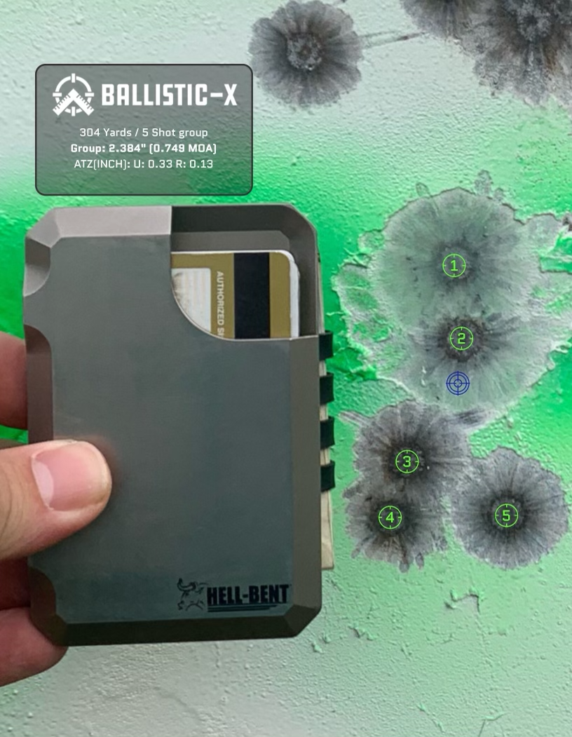

The 12T is no joke.
205 was spot on. 305 had a Cal DSF Adjustment then 5 rounds right in the middle by the wallet.

I have a Vudoo now that is being parted out. I have my RimX and another Vudoo on order. I absolutely love this 12T from PVA.
