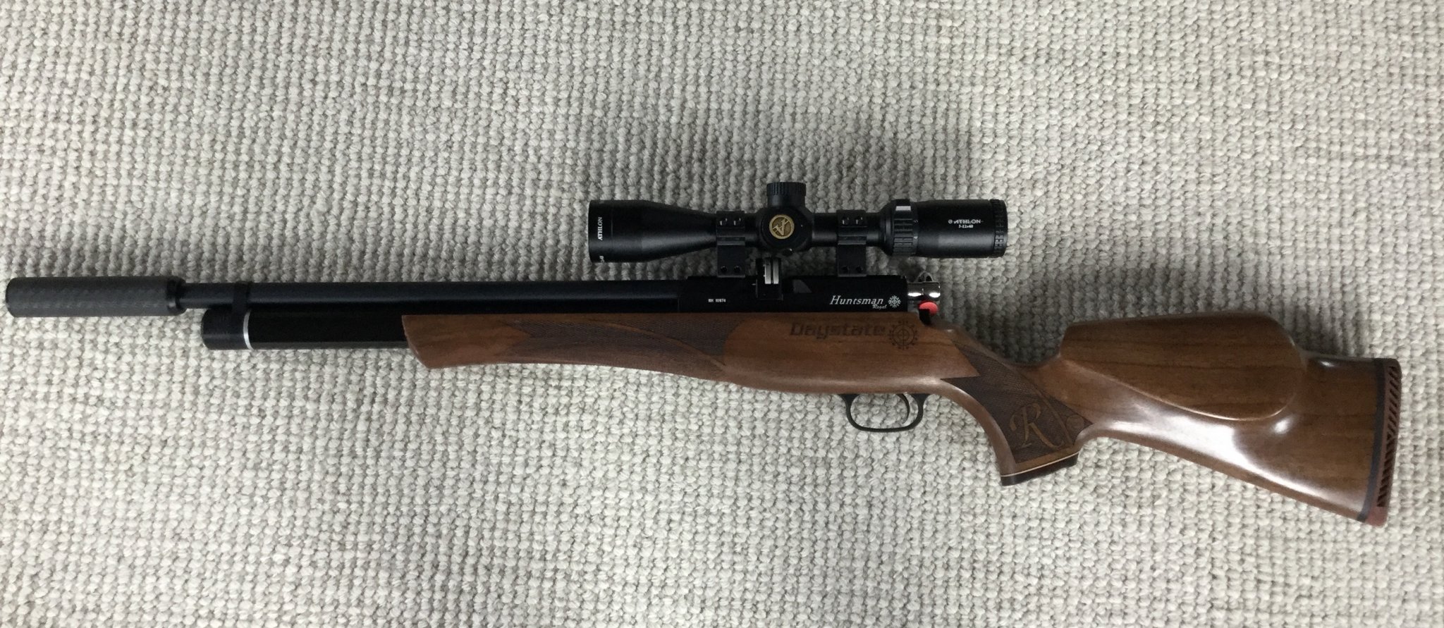

This is why I placed an order for my first PCP rifle (BSA R-10 SE walnut in 0.177). I also ordered a Benjamin Traveler 4500PSI compressor.

The gun is here. It's setup and ready to go. My compressor won't be here before next week, so no shooting for now.
I purchased the same gun as this guy in the YouTube review (but mine in 0.177). He's shooting in the 0.3s at 50Y and calls the gun sub moa at 100Y on a calm (very) day.

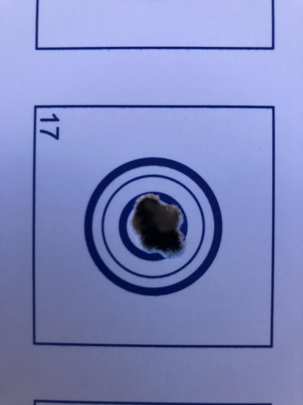

Shot the gun outdoor at 30Y.
I'm still figuring out the rifle and testing pellets. At 30Y I think it shoots like your average 22lr rifle (think CZ455). The shooting experience is also very similar to shooting a 22lr with a silencer.
But I'm not happy with the chrono numbers. I'm going to tune the gun a bit. I just ordered a Huma regulator that should greatly improve shot to shot consistency.
The below target was shot at 30Y with HN Match 10.65gr. They are all 5 shot or 10 shot groups.

Sorry for the confusion......The chrono is with HN Match 10.65. The 3 groups on the bottom left (2 five shot and 1 ten shot group) are with JSB Monster Redesigned 13.43 gr
I did try JSB 10.34 and the gun doesn't like it. So far, the HN match 10.65 seems to be what the gun likes the best.

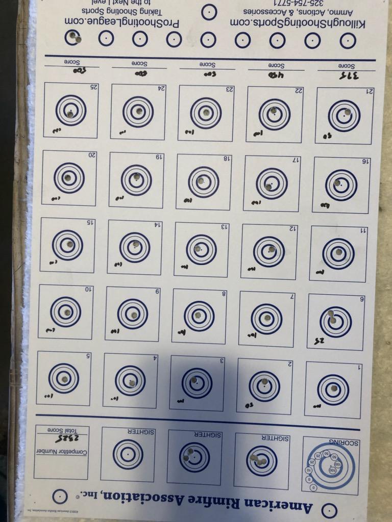

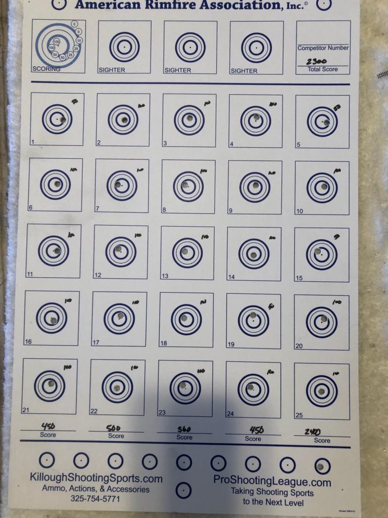

First outing with the rifle at 50Y in an indoor range. I bough a tank so I can refill at the range. The Huma regulator won't be here before next week, so to get more shot to shot consistency I'm refilling every 20 pellets (with the tank it just takes a few seconds).
I tested many pellets from 8.4 to 13.43 gr. Almost all pellets shot pretty well (typically below 1" at 50Y).
The best pellet was the JSB Monster Redesigned 13.43 gr. I shot a 4 five shot groups that was pretty good. I did it again just to make sure it's not pure luck.
I'm still figuring out the rifle, but it's clearly shooting on par with your typical CZ 455 at 50Y.

Today, for the first time, I shot the rifle at 50Y outdoor. It shoots in the 0.9s.
It’s just ok, but I was expecting better.
After shooting the air gun, I took out the Vudoo and shot the below target at 50Y with a clean barrel….
I’ll have to work a little more on this air rifle. I was also thinking about getting an FX Crown in 0.177. The reason for 0.177 is that the sectional density of a heavy slug in 0.177 will be better than the same gun shooting a bigger caliber.
I’m not expecting to get Vudoo accuracy. I’d be happy with 0.5” groups at 50Y.
Overall, I’m pretty happy though. Today was a good day at the range. I shot 400 pellets and only 3 boxes of Center X…..which is good because I need to save my good ammo as I’m not sure when I can find them in stock again.
