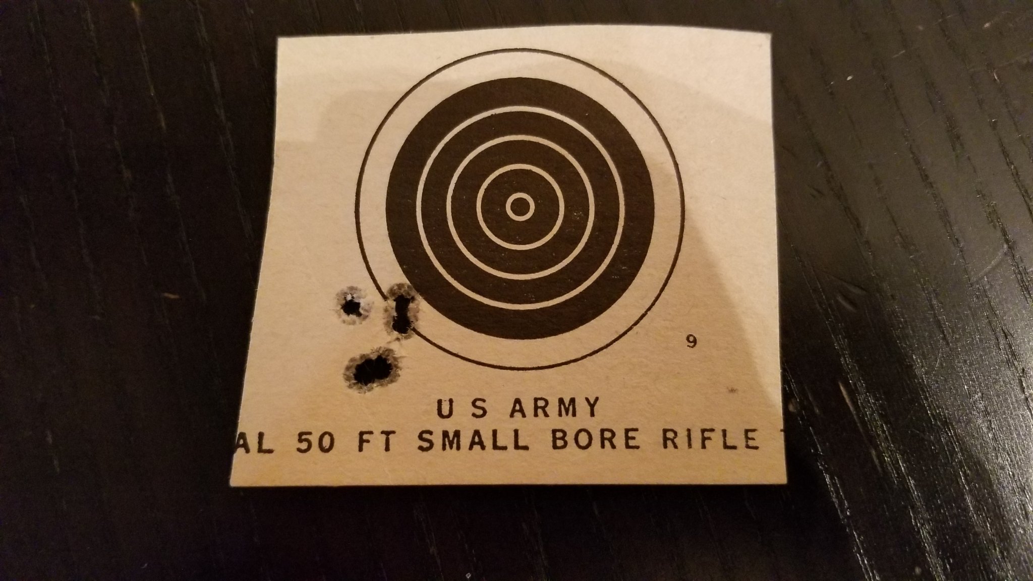

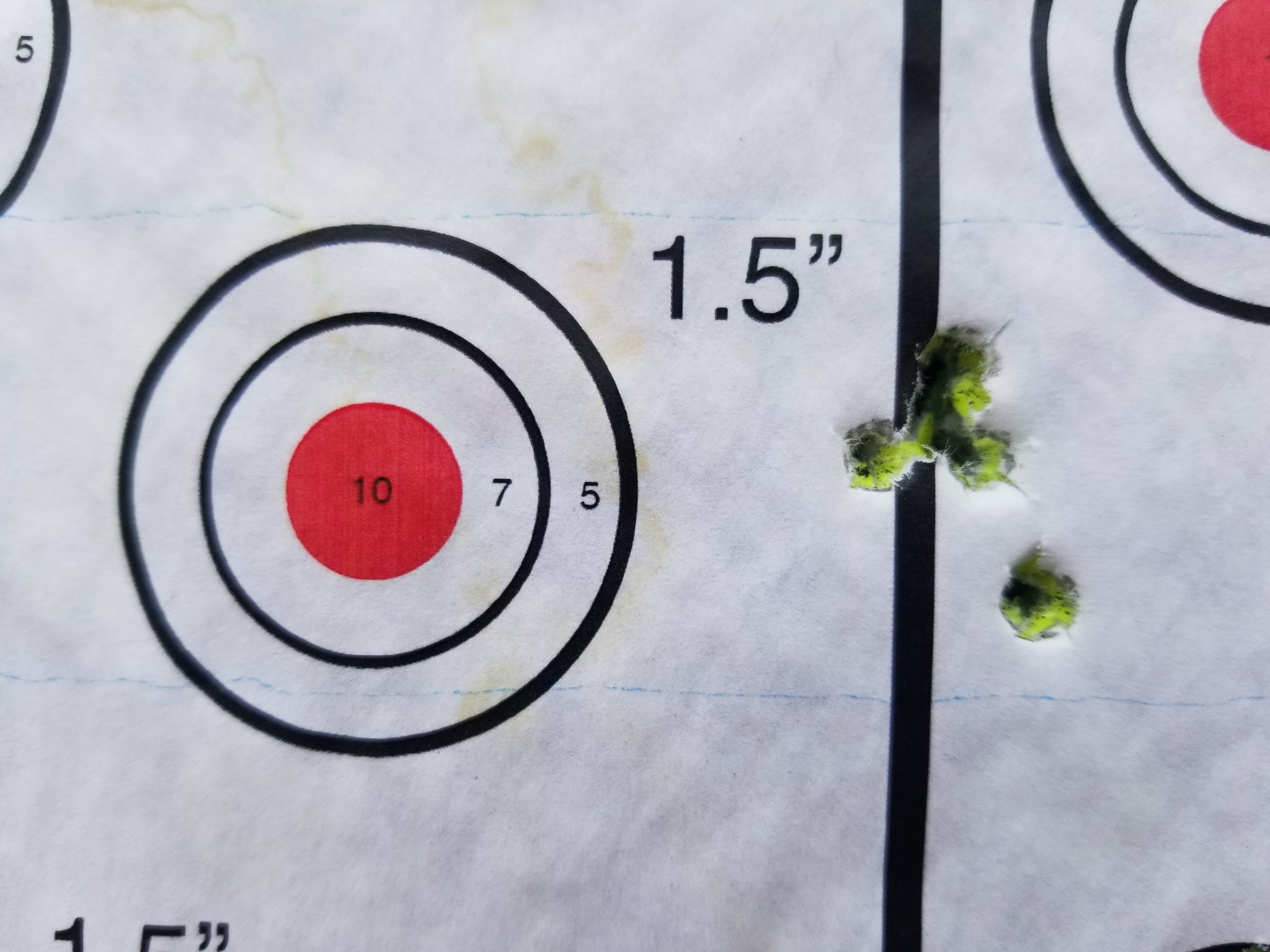

This is a special lot of SK Standard Plus. 4 at 100 yards from a Vudoo V22 in a Manners T4A.
Rumblingdwarf
Aug 19, 2018
120
116
SLC...ish
Great start, but I'd be more interested after seeing what the other 46 rounds from that box do before getting too excited. Rimfire ammo consistency is a continually frustrating experience. If the rest of the box does that , then indeed you have a magic lot that you need to get more of before it runs out of stock. nice group at 100.
Typical past experience for me is I get 2-8 rounds per box of 50 that are either hot or slow enough to drop the shot out of the x ring. X-ring for ARA BR is 1/2" bull at 50 yards, worst case scoring (if it breaks the line, it gets scored at lower value). The more $ spent usually means a better lower standard deviation, but even the expensive ammo have had turds mixed in with em.
I appreciate the constructive criticism. I have shot Similar groups from this same lot a few times. Actually from more than 1 rifle. This group is from the same rifle a few weeks earlier.

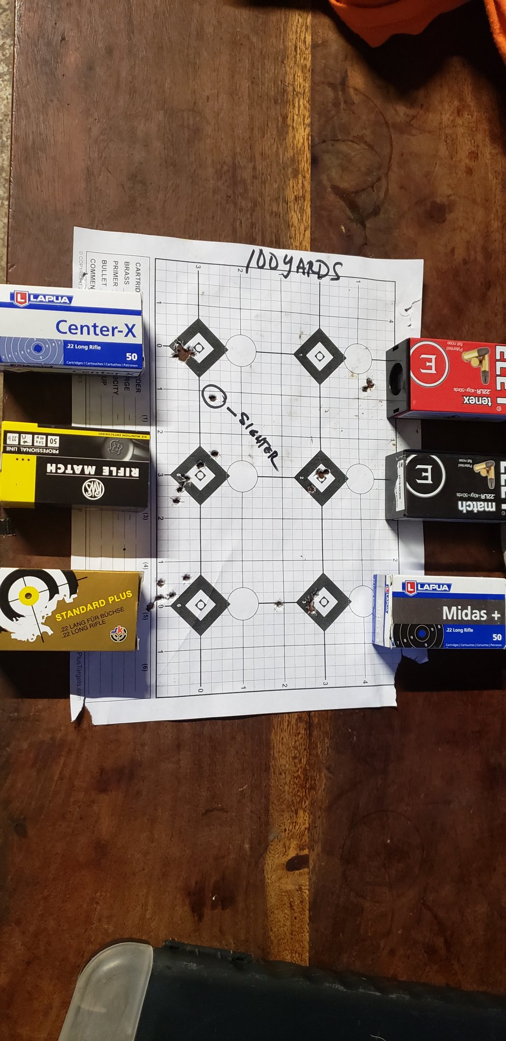

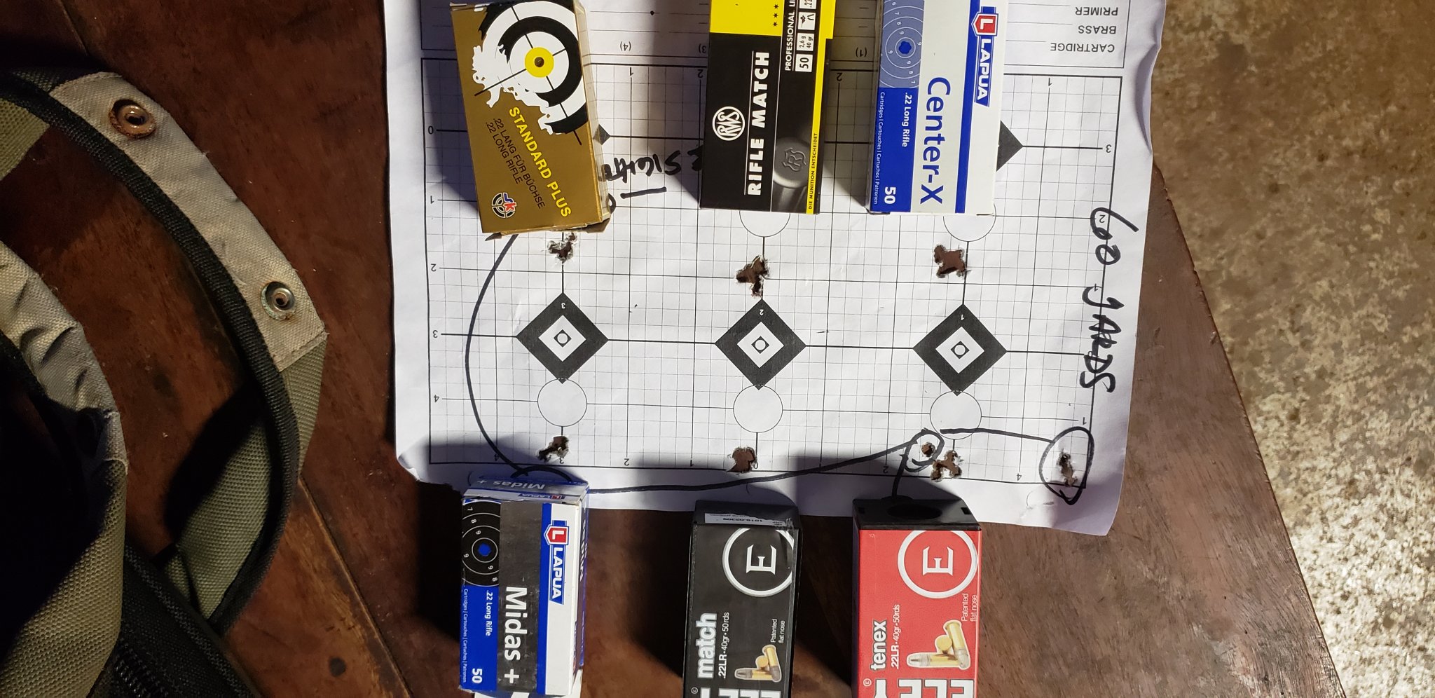

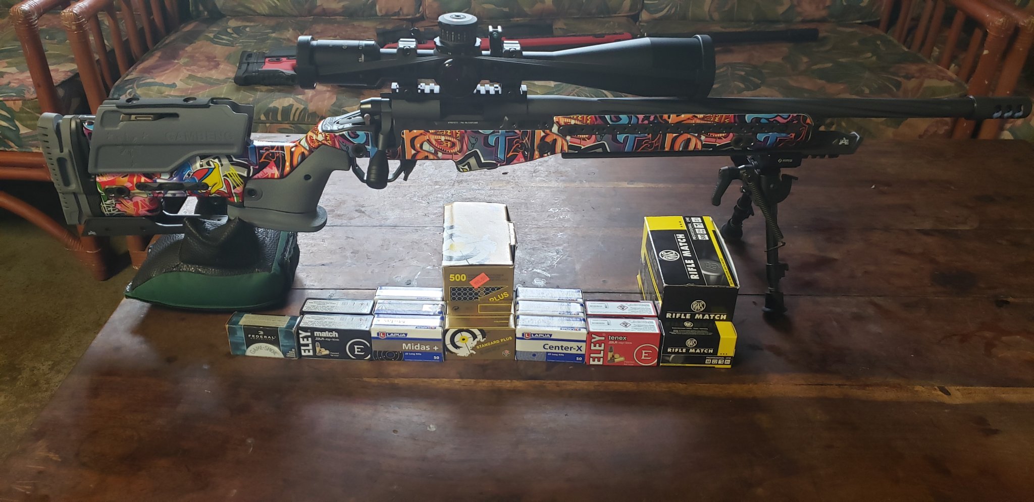

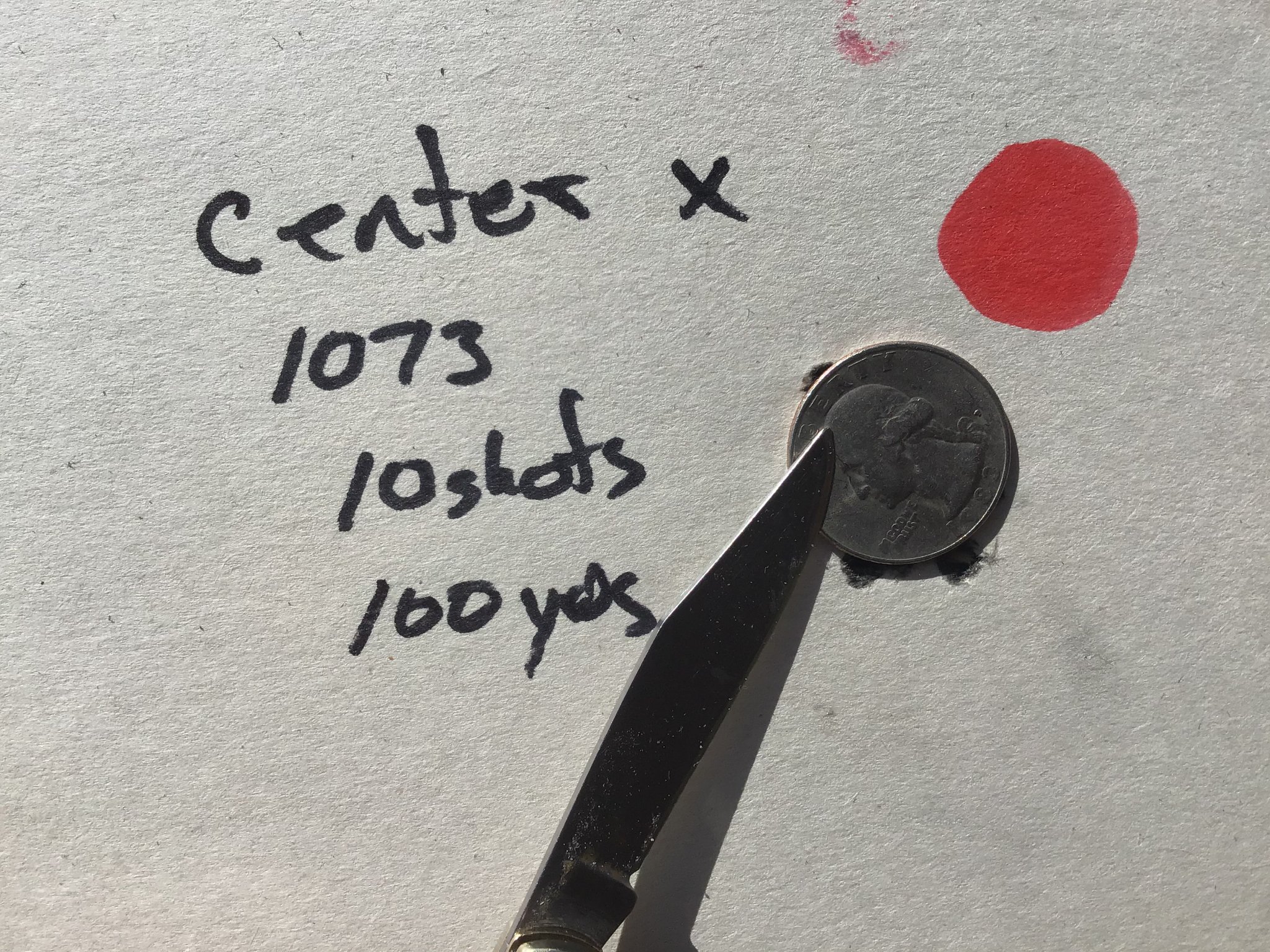

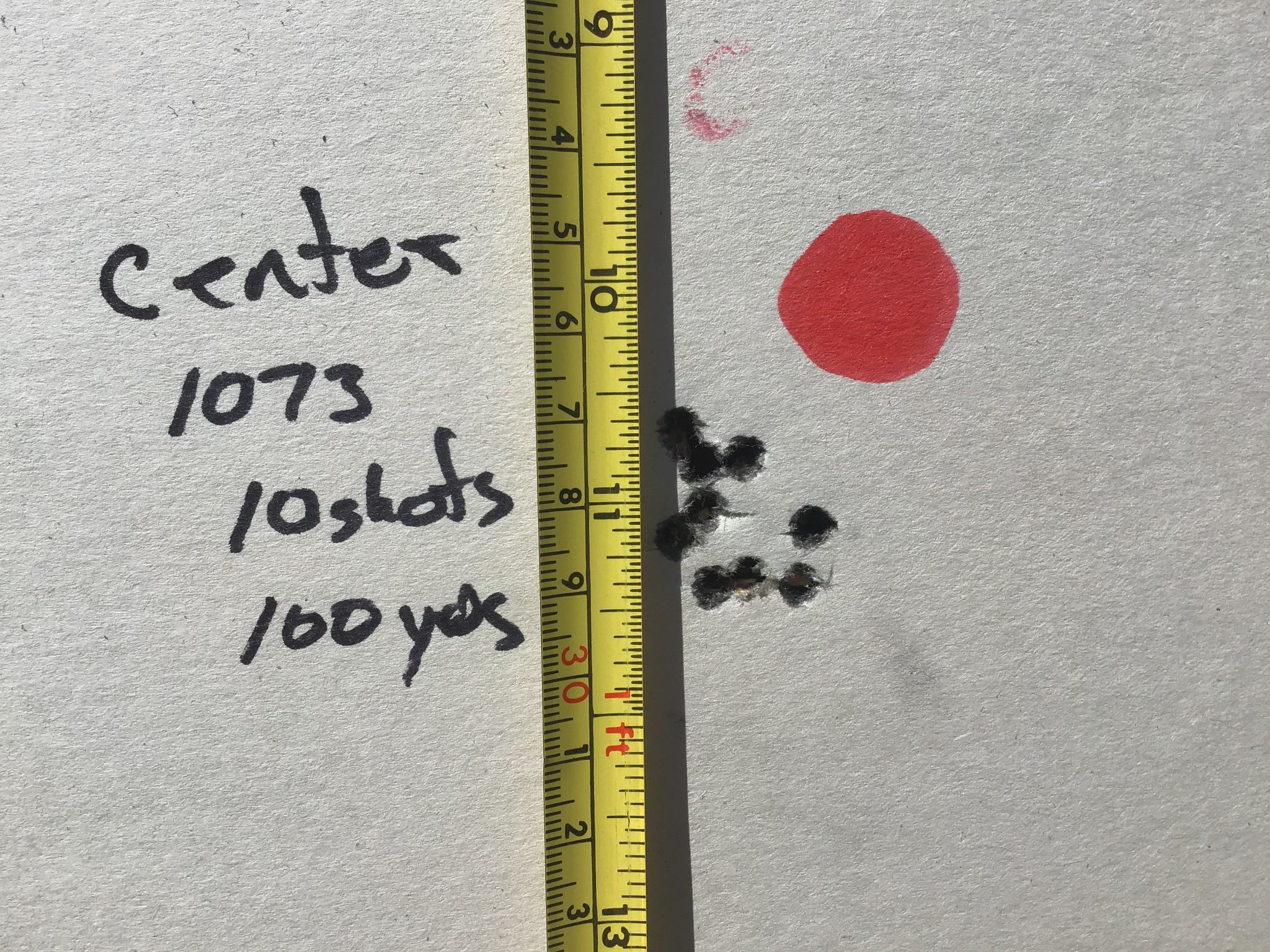

Narrowed selection down to lapua center X out of Eley target,Eley edge,ski rifle match,cci,fed gold ,sky long range.

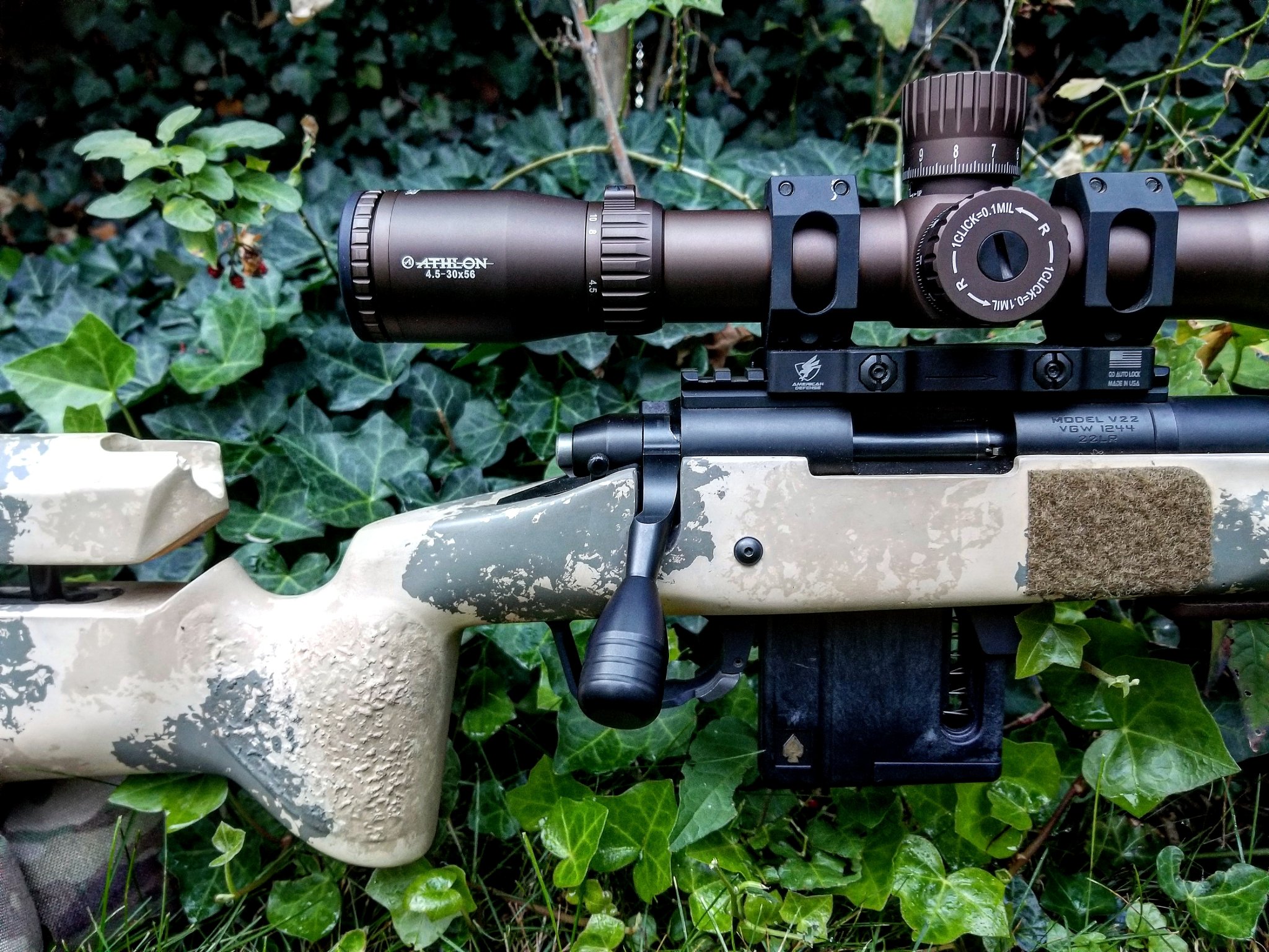

Vudoo 20” trigger tech standard MPA chassis 4x14 Nightforce shv
