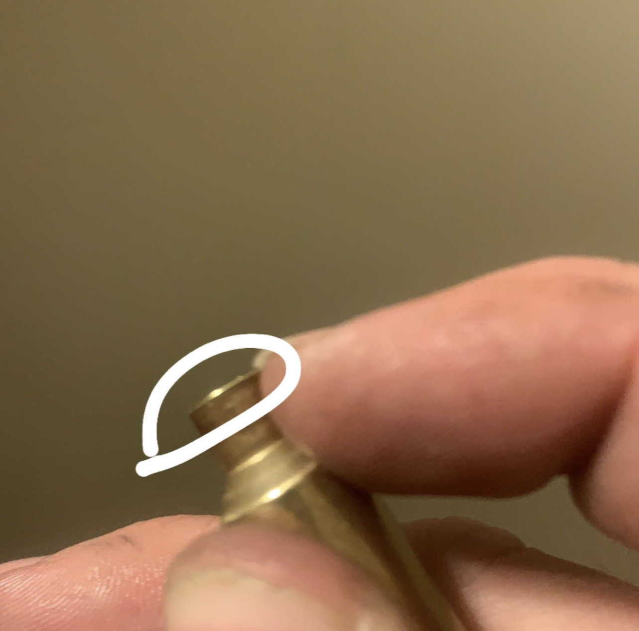

    I've been fire-forming a bunch of new 300-PRC Lapua brass. Took some 1x fired brass out for a test spin yesterday and they wouldn't fit into the chamber ... bolt wouldn't close on any of them at the range. Brought 'em home and because it's an MRAD and super easy ... I pulled the barrel and sure enough, the rounds wouldn't seat into the chamber. Went to my sized 1x fired brass that I used for this, and they fit just fine. Dismantled the ammo and re-sized and that made the cases fit just fine ... dropped in and dropped out easily.
    Charged and seated the bullets and checked again ... No-Go. Scratched my head over that one, and figured maybe I'd screwed up the head space and the bullets were hitting the lands. Went through that whole process again and it all checked good. Decided to take one of the finished cartridges that didn't fit, and decrease seating depth steadily until it dropped in the chamber ... No-Go. So the problem is not about the bullet hitting the lands, or the size of the case at the beginning of the seating process.
    Pulled the bullet to test the case ... and it didn't fit. I'm stumped. How the heck does seating the bullet take a perfectly good case that fits fine, and turn it into a case that doesn't fit in the chamber. What am I missing here? I'm not even sure about next steps to troubleshoot this ...
    On an empty case that doesn't fit, where is it getting stuck on the case? near the web?
    So all these suggestions got me thinking about stress-testing the size and specs of brass that doesn't work after seating. Long story short ... I figured out that the very end of the case mouth was at, or slightly over the max spec of .3410 ... on a very slight "bulge". It's less on sized and unseated brass, but when seating a bullet, it expands just enough to be out of spec. So even though the COAL is at a size that doesn't "require" trimming, I went ahead and trimmed down to trim-length (2.565) and ... VOILA ... case drops in and out of the chamber.
    Then I seated a bullet and ... VOILA x 2 ... it seats in the chamber just fine. Apparently I need to trim this slight bulge at the top of the case mouth on all my brass, whether or not it needs trimming for COAL specs ... to make this problem go away.
    Thanks for everyone's advice. Time to do some trimming and try all this again.
    What sizing and seater did are you using? Backing your seater off a bit may cause the case not to bulge. Typically I can go several firings on my cases before I need to trim. Haven’t played with the 300 PRC Lapua yet tho
    I use the Redding Competition Micrometer Seating Die ... very high end. Set up per the instructions to screw down until it just touches the ram, and then back off to set the micrometer guide facing forward. Do you think I should back off more than that?
    screw down until what touches the ram (die body or sleeve)? You should still be compressing the floating sleeve if setup right.
    BTW ... in order to get the shoulder bump correct, I have to cam-over just a bit and use a .002 shell holder. If I back off on either of those, I can't get the proper shoulder bump.
    I stopped using bushing dies because they turn the necks into funnels. This is fine if you crimp into a canelure afterwards but not so good if you have a tight chamber.
    Glad you figured it out. If I were you I would neck size with a a LCND before you body size or just use a LCND to deprime. That way the case mouth will always be the same diameter as the rest of the neck.
    Reactions: iceng

    Most every time I’ve seen issues with case mouth flaring, it’s a seating die screwed too far down.
    Reactions: Yondering
    When you screw a seater die too far down it crimps the case mouth, not flares it.
    I could obviously be wrong, but this looks flared. I’ve seen different dies do weird things when not setup up properly.

    Did you do that with a Redding Competition Seater?

    I believe that was a Redding. Can’t remember.

    Just a little trimmed, just enough to lose the flare at the very end. I'll back off the die one more rotation and see if that helps. Thanks.
