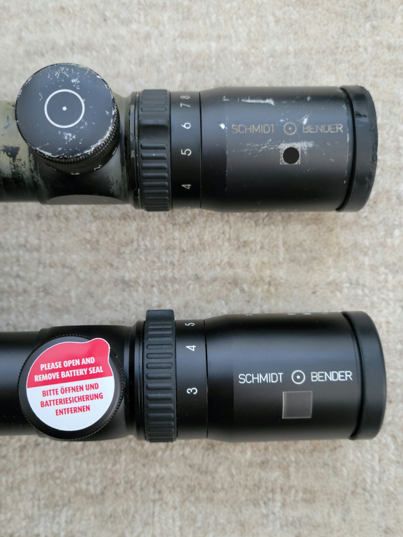

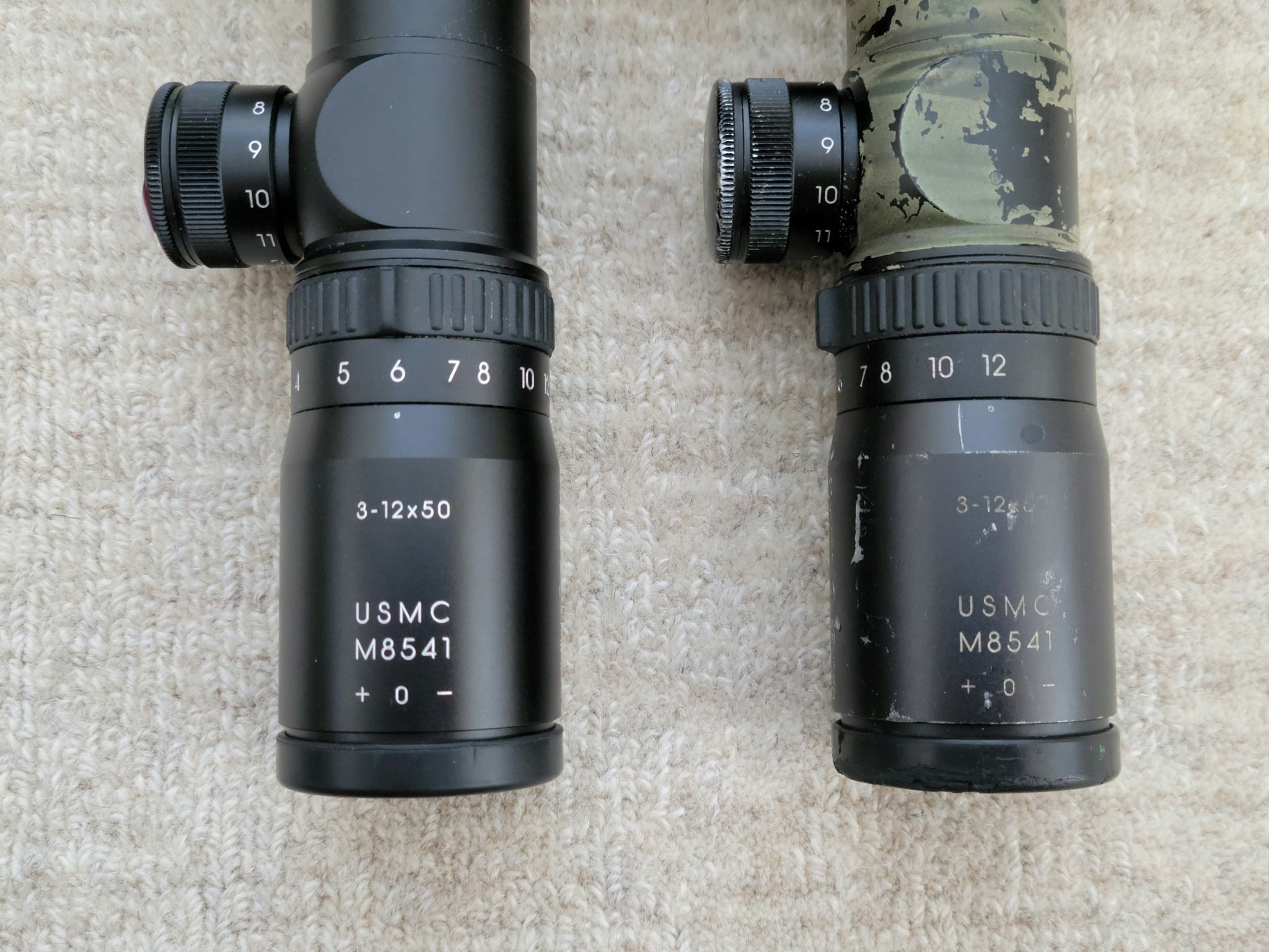

I have one of these EuroOptic scopes, I ordered it from them when they were released for sale and I think it cost me approximately 1 Flip. I photographed my EuroOptic scope next to a legit surplus USMC issued scope that I'm borrowing from a friend for my research (photos amd comparisons to other known scopes). I wish I could have kept the surplus scope, but I already mailed it back and I don't think my friend would have been too happy with me had I switched these 2 scopes around, lol.
This is proof that the 14 EuroOptic S&B M8541 SSDS scopes have the correct markings, including the Schmidt Bender on the left side of the ocular housing instead of Premier Reticles. The engraved UID tags are the exact same on both scopes. The EuroOptic scope has the UID tag, but unfortunately it was destroyed by S&B. Had this tag still been intact, the scopes would have been identical except for the serial number. Speaking of serial numbers, both scopes are very close in serial number, so they were made roughly the same time (maybe same month or same year, depending on how many scopes S&B makes per year).
