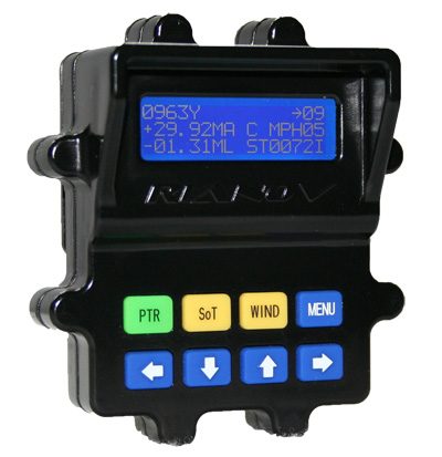

    This arrived today from Jason @ Euro Optics
    They are carrying the Rianov Ballistic Calculator that attaches to your scope, along with the ERA Tac Adjustable Cant Scope.
    Just mounted it up and made sure I had the basic settings in place, but overall, I like the package.
    The MOA Adjustable mount is actually very cool, low profile, with a wheel to dial the desired MOA as needed, which for the ELR Crowd could be the difference between needing to hold at distance or being able to further dial. It's a very smart design.
    https://rianov.com/product/4
    ERA-TAC - Adjustable Inclination Mounts
    It's the JBM Software, this is the guy I believe that actually has the engine behind JBM, which is used by a lot of stuff.
    A lot of it is just a variation of Point Mass which is open source, but they all add in their own little tweaks, but this is the guy that owns a few of the tweaks I believe that is used by most other software out there.
    The people behind the Rianov are one of the early entries into ballistic software.
    To get in depth a bit,
    You have 4 Modes you can operate in, and the computer will do a bunch of stuff for you. You can input your mil readings for range, and the computer will give you the solution, you can have it set to auto incline / for slope and cant adjustments which it will do automatically, or you can just input the range (and slope & cant) and the computer will give you that solution.
    You add a lot in about your weapon, Twist, Bullet Length, Lat, Bearing, MV, etc, it will show you how to calculate MV Corrections which you can add in. You can put in offsets for scopes issues, or mounting variations, so it's getting a lot of data to use. The wind is very good, and easy to use, as well you just add in your range and go.
    I would say it's very similar to the Kestrel solutions with a slightly easier menu (once you set it up) They are also sending me the Multi Gun version, this is the SOLO which is a one gun solution. When you consider that one gun solutions is $230 it's pretty reasonable compared to the options.
    From their page
    [h=1]RIANOV™ Technology[/h]RIANOV™ patented technology offers shooters the ability to mount solid state electronics to their weapons which provide real-time data, fully compensated solutions and other information critical to the success of the shooter.
    [h=2]HOW IT WORKS[/h]The RIANOV™ encapsulates a series of sensors and a microprocessor that manages and controls the sensors and user interface to allow the user to remain focused on the mission.

    [h=2]FOR THE RIANOV™ M06[/h]Ranging Your Target (2 steps)§
    1. Press the SoT (Size of Target) Button and enter the size of your target . You can enter any value from 1 inch to 9999 inches and convert to other units (feet, yards and meters).
    2. While looking through your scope, place the cross-hairs (or any portion of the reticle markings, even if your scope only provides a single dot) on the top† of the target, press and release the PTR (Push-To-Range™) Button and hold steady to establish the start point of the measurement. Move the cross-hairs to the bottom of the target, press and release the PTR Button and hold steady to establish the end point of the measurement.

    Because software makes it easier, especially for people without the ability to verify dope at distance.
    Why mount it, that can certainly be debated, it's not very big or heavy, so why not.
    Essentially, its JBM in a box... which many find JBM to accurate and convenient, and it adjust via conditions outside which it reads.

    We were at SHOT with Jason when the Rianov team demo'd them.
    We tested the Solo out to 1KM over the course of a week on a 260Rem and a 300WM and it was dead on every single time. We even ran it side by side with another PDA based solution and got differing results but the solutions coming from the Solo were the ones that worked.
    The Eagle not only allows you to set profiles but also DOPE so you can get accurate readings in the transonic and subsonic stages of flight.
    Amazing bit of gear....

    The EAGLE has multiple methods of mounting. Scope Mount Kits (1'', 30mm, 34 mm, 35 mm) and a Rail Mount Kit. The commercial Unit in the US is $750 plus mounts. The benefit of the EAGLE over the SOLO is memory for up to 16 different weapon systems. You also can enter up to 60 entries of DOPE for each weapon system. The DOPE "True-Zero points" helps you extend into the Trans/Sub Sonic regions.

    I am pretty much blind without my glasses and it's very bright and easy to read. It's far easier to read than a Kestrel I will say that.

    As I understand it, you put a reticle marking at the top of your target, push a button, move the reticle feature to the bottom of the target, push a button and input the size of the target in inches.
    Is this basically how the ranging works? How accurate is this system in practice?

    In some of the photos it seems that the Rianov has a pretty good back light. Can this be turned off and the display still be useable?
