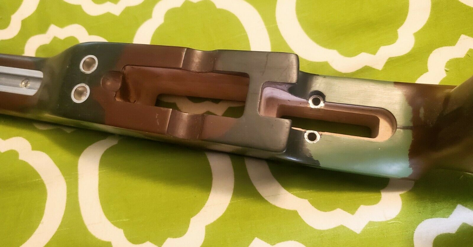

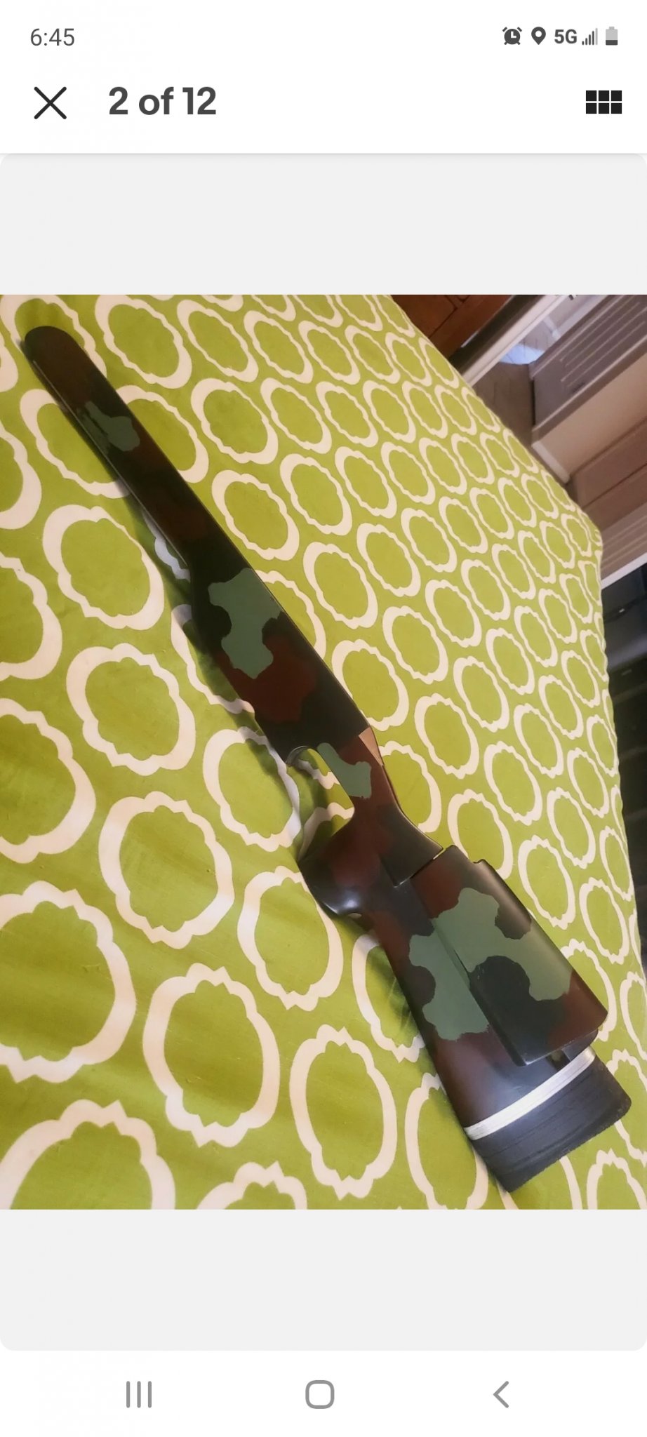

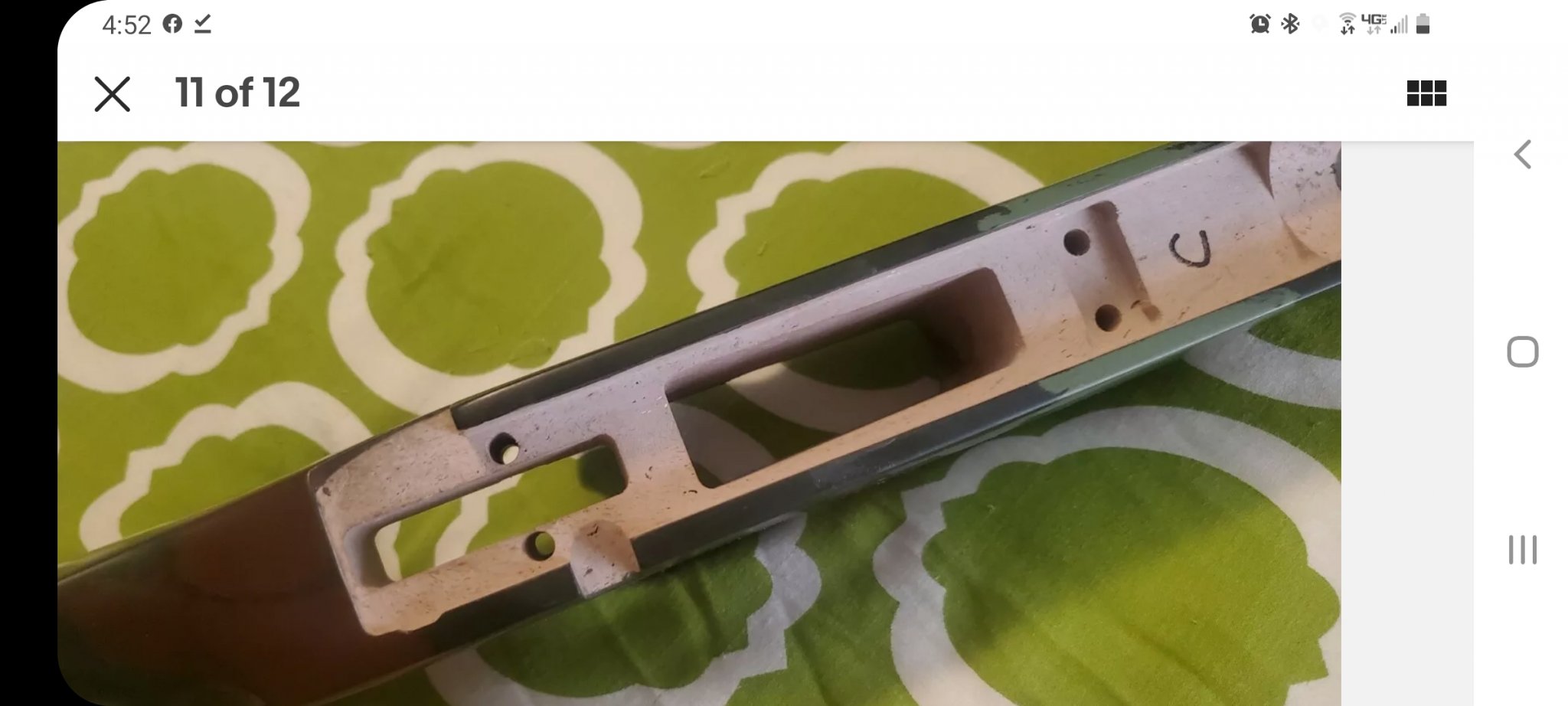

Wow, so that set of two holes at the rear are For action screws???Can somebody help me identify what action this McMillan stock is inletted for?
Fatboy nailed it!AI sold a Palma master that had a 5 round single stack mag. They were flat bottom with integral lug. Without pull all the shit out of my safe I can’t say for sure if the action screws go into the recoil lug, but it looks close. That Highpower stock fits the time period too.

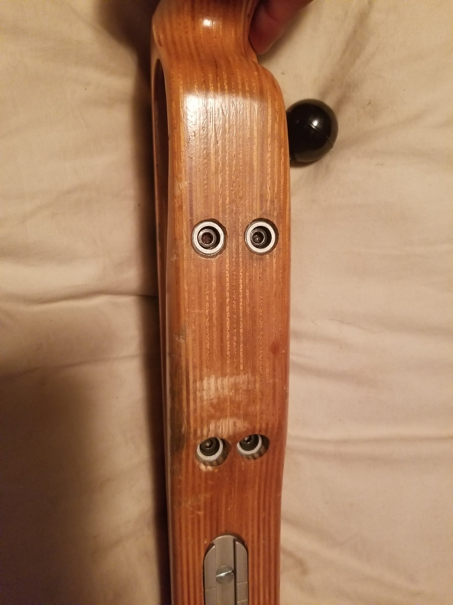

Here is the bottom of my Coopermatch. Appears to be it..
Edit: here you go…. AI
Accuracy International Coopermatch

My brother Scott traded Spike and I out of all our AI target rifles There were three in the country initially, Carl Bernosky had one for a while. Kind of spendy for NRA High-power, cool stuff!I figured it was a pretty small group of guys that would have a stock like this. I was thinking you or maybe Spike or David.
I think it's strange that someone would have a McMillan stock inleted for such a rare rifle
Not sure where you heard all that, the rifle pictured at Whidden Gunworks is a single shot 308 Palma master I sold to the AMU back in the day. AI England never made a 300 win mag target rifle. Like Chris said you can change out the standard bolt head for a Magnum and your off and running. I put one together and won the 1000 yard any-any rifle match at Oak Ridge first time out 200-12x. A Coopermatch was just a target rifle (repeater) in .308 quite a few were sold in Switzerland in 7.5 Swiss.Believe they been around since 2006
" Malcolm Cooper, world champion and two time Olympic champion, became part owner of Accuracy International in 1978. Under Malcolm Cooper's direction and input, the Cooper Match Rifle was born. Fewer than 50 CooperMatch rifles were ever produced. Approximately ten were produced in 300win mag."
