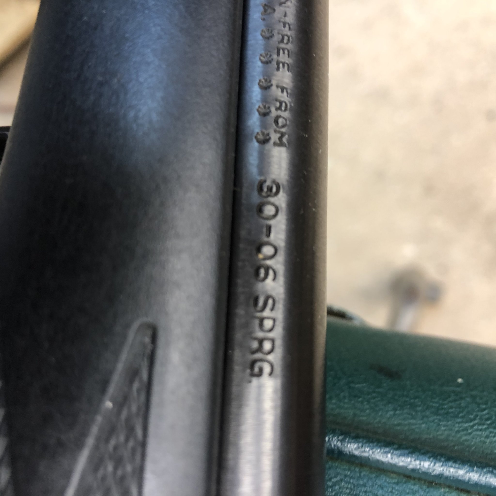

    Going after bigger animals generally requires a bit more horsepower downrange, so I dug my 30/06 out of the gun safe.
    Here's where the "Old Rifle" thing kicks in:

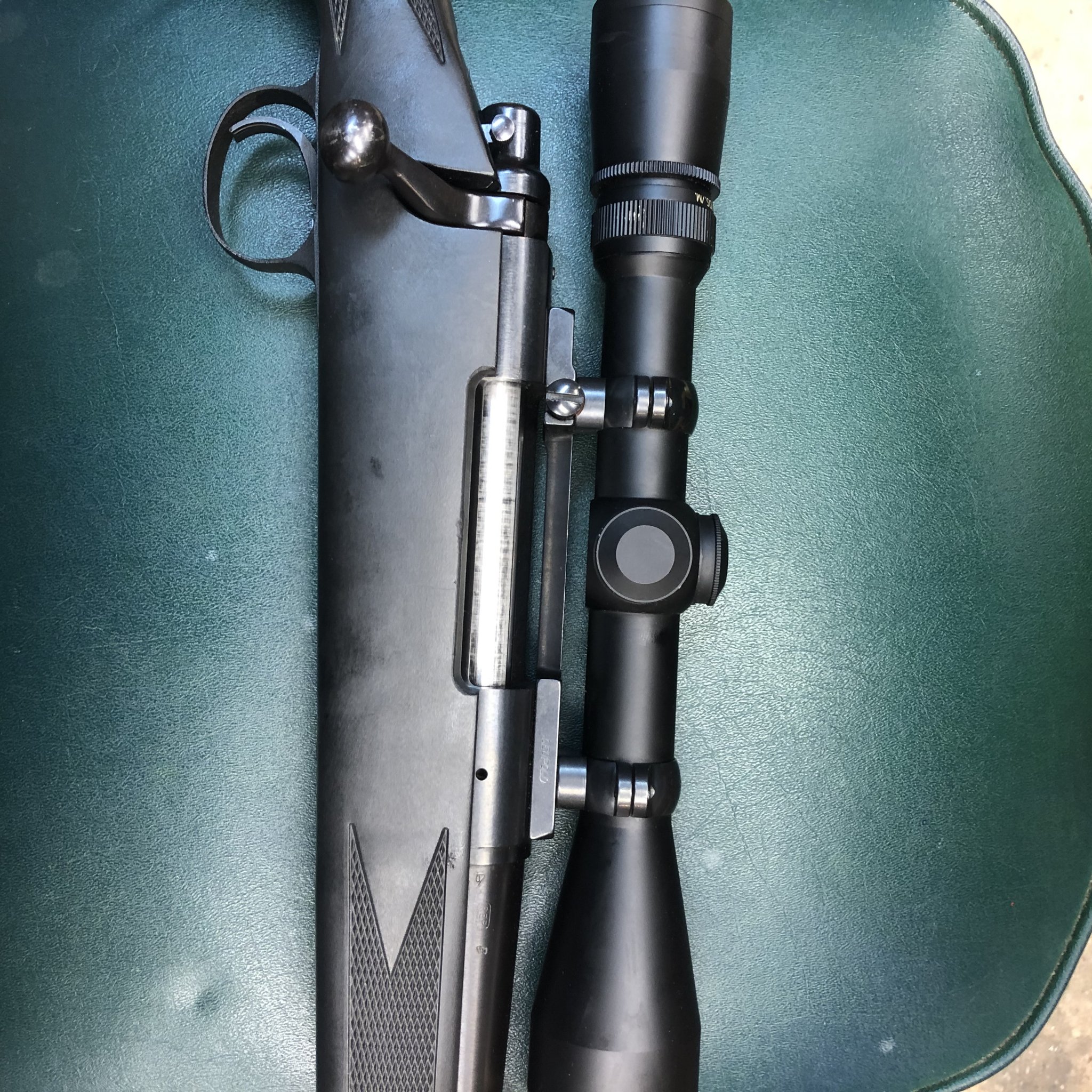

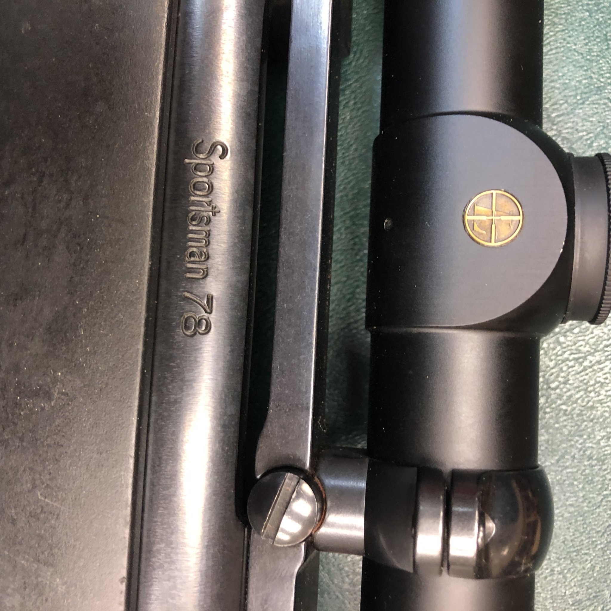

    I bought this Remington 78 Sportsman at Kmart in 1991 for the princely sum of $ 239.99 on clearance.
    It had open sights and birch wood stock that was about as pretty as a fence post or a shovel handle.
    The 3-9x Leupold Vari X3 scope, mounts and rings are all the same vintage and are still functional but not optimal.
    I scored a factory Remmy Synthetic stock about 1992 or so that I glass bedded to the action.
    The gun as it sits is capable of sub MOA 3 shot groups with hand loads, even with the optics currently on the rifle.
    It's killed coyotes, deer and armadillos in 3 different states and I carried it a lot of miles in a couple of more states.
    I want to give the old workhorse a bit of an update and add some functionality while i'm at it.
    Here's the plan so far:
    New Trigger - I want a two stage, it's what I like these days
    Picatinny Rail Scope mount -Every other rifle in the safe has one. Makes optic change outs more "Plug & Play"
    Optic- I'll swap something over from another rifle that I'm used to the reticle, more magnification, etc.
    Barrel - I'll thread it for a Form 1 Suppressor or a brake.
    Stock / Chassis - Either a KRG Bravo or the new MDT XRS if the LA 700 inlet hits the streets before next Hunting Season, depending on what feels better.
    Ammo - Handloads with a 180 grain partition or acccubond or interlock type bullet with a little more retained weight.
    Thoughts ?
    Suggestions?
    Input ?
    Since a thread like this needs photos:

    If it is sub moa, you’d be silly to swap stocks. Also, that’s a darned skinny muzzle! You might want to make sure you have enough meat to thread.
