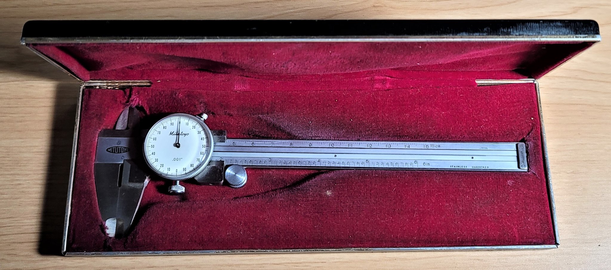

This this vintage caliper set acceptable for measuring case dimensions?

What do you all think of this old Mitutoyo dial set? My grandfather used this for a long time in automotive, and I'm trying to save where I can as I have dropped several thousand dollars in reloading equipment already.

As long as the needle sweeps the dial for the entire range of the slide without skipping or jumping, it will be accurate to at be +/-.002”, like every other caliper out there.

That is an awesome set of old Mitutoyo calipers. I use both dial and digital Mitutoyo's. Nothing that old, but I still prefer the dial. To me, a dial is easier to see small movements when making sure you have what your measuring flush against the jaws. Use them with pride!

If you're going to go nice go with the mitutoyo 500 series calipers. Available 0-6, 0-8, and 0-12.
Personally have 0-6 and 0-12. Will do American and metric at the push of a button. They also don't forget where they are along the slide. Also safe to store with your guns down to 3' of water.

Have multiple Mitys identical to yours and they perform perfectly. It is a precision instrument. It is not a hammer or pry bar. Take care of it. Treat it with care. It will serve you well.
