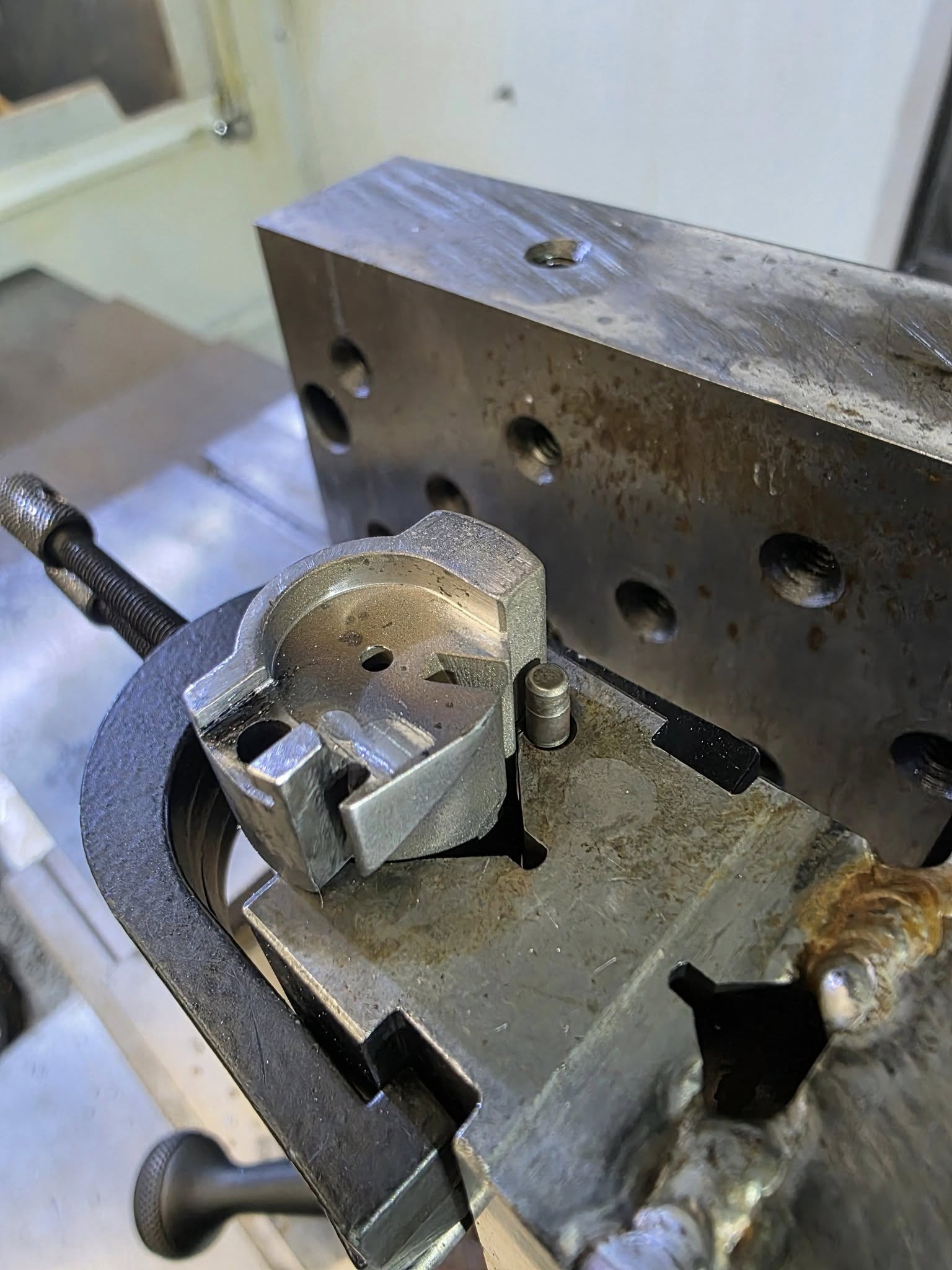

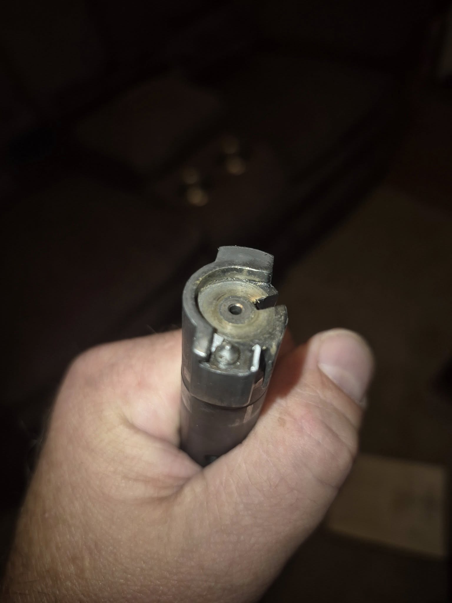

    This was Winchester's attempt to make a T slot work as a Control Round Feed from a few decades ago.

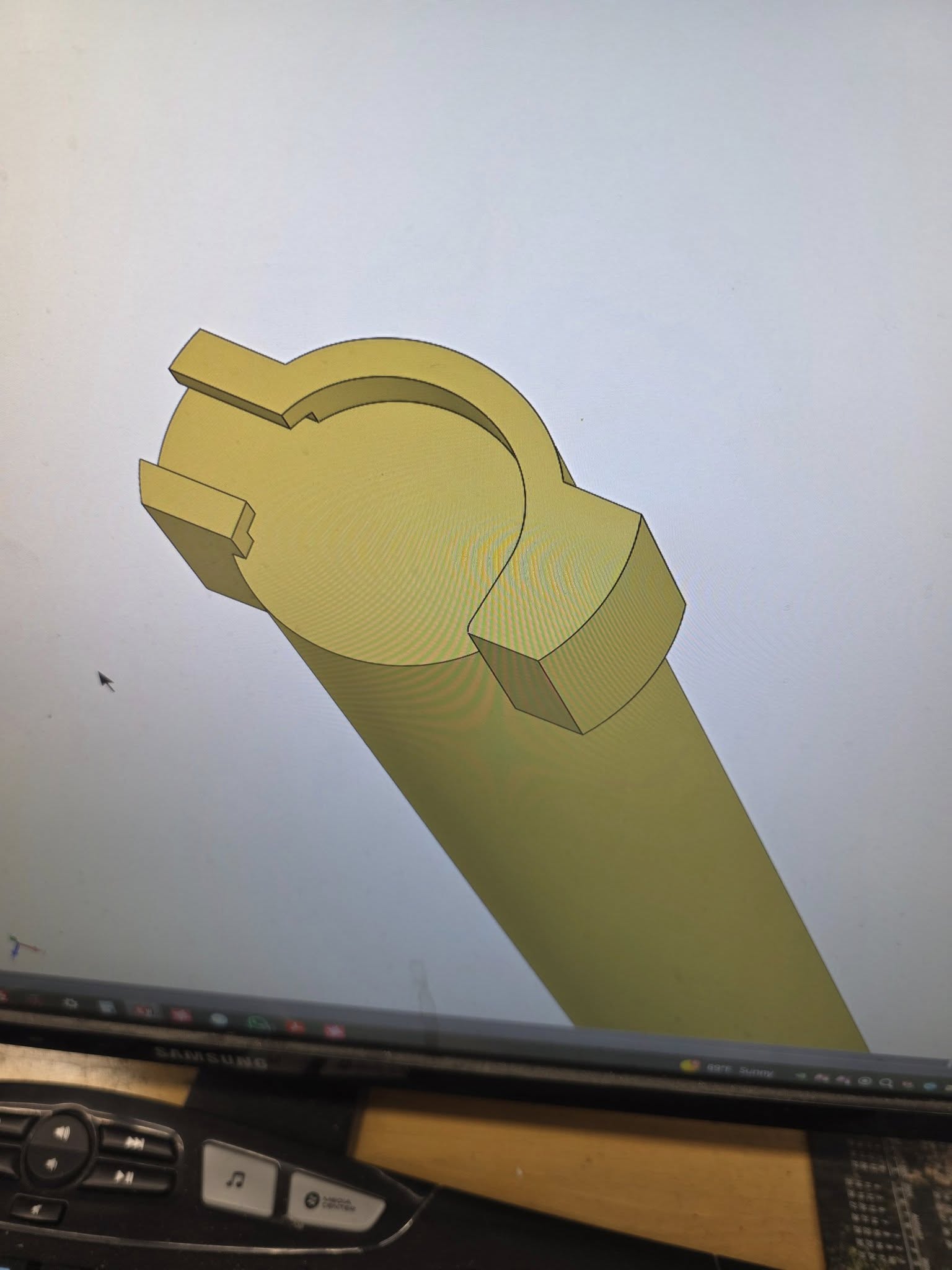

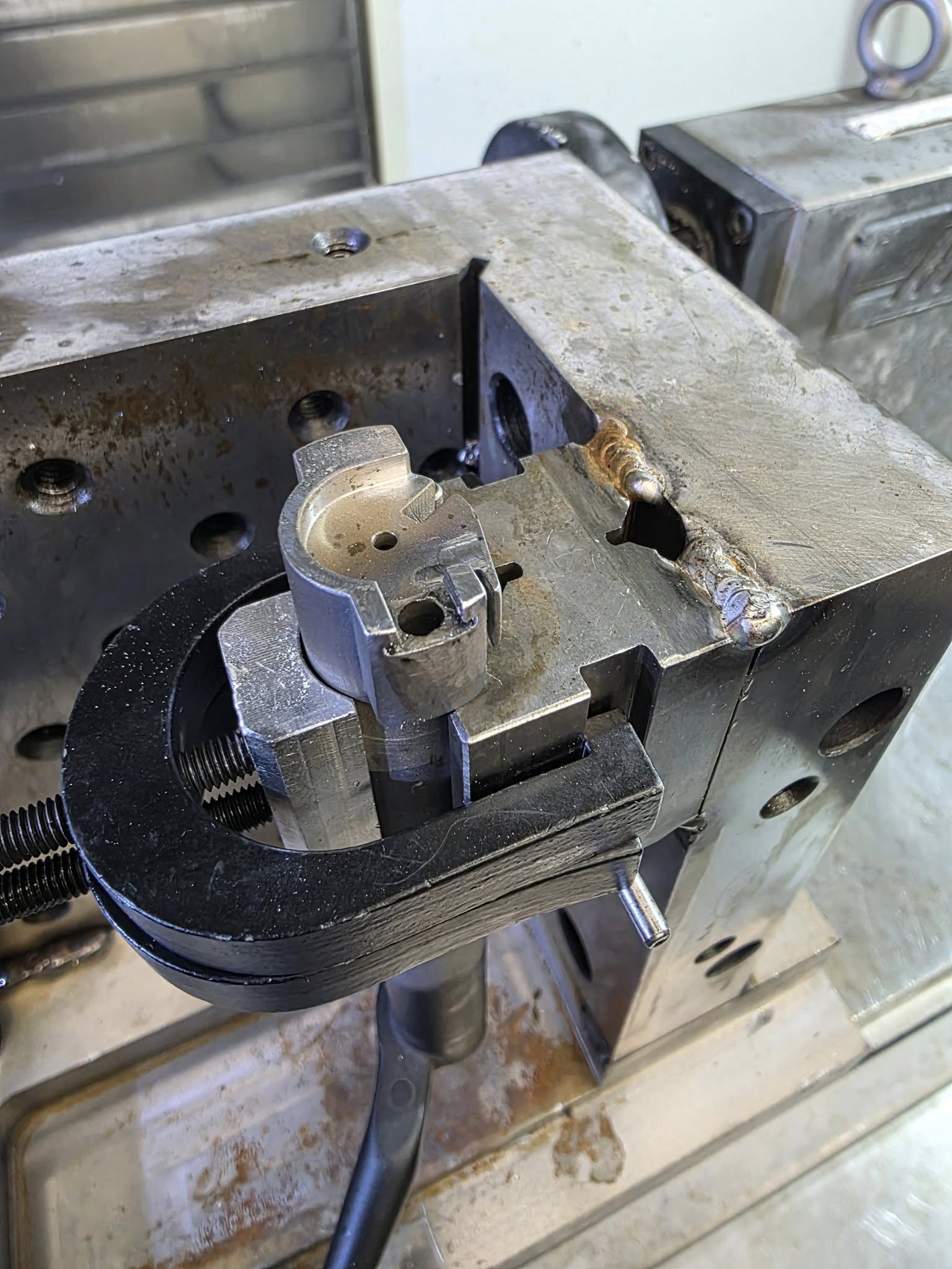

    The T slot decided to amputate itself from the bolt head. A little -puter modeling followed by some welding and machining saves it from the grave.
