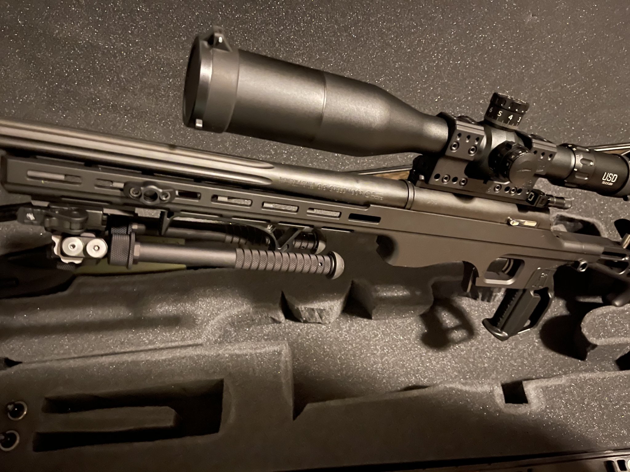

Old topic but I have a LRR in 6.5 Creedmoor and have zero issues. It was a little stiff at first but after a good cleaning and a couple hundred rounds it’s really smooth. Trigger is set to 3lbs and it has a nice break to it as well, not much to complain about for me. A few of my friends have high dollar precision riffles with Bat actions and they all said it’s damn nice for the price. Maybe you have a defect or need to go shoot it a little to break it in.
