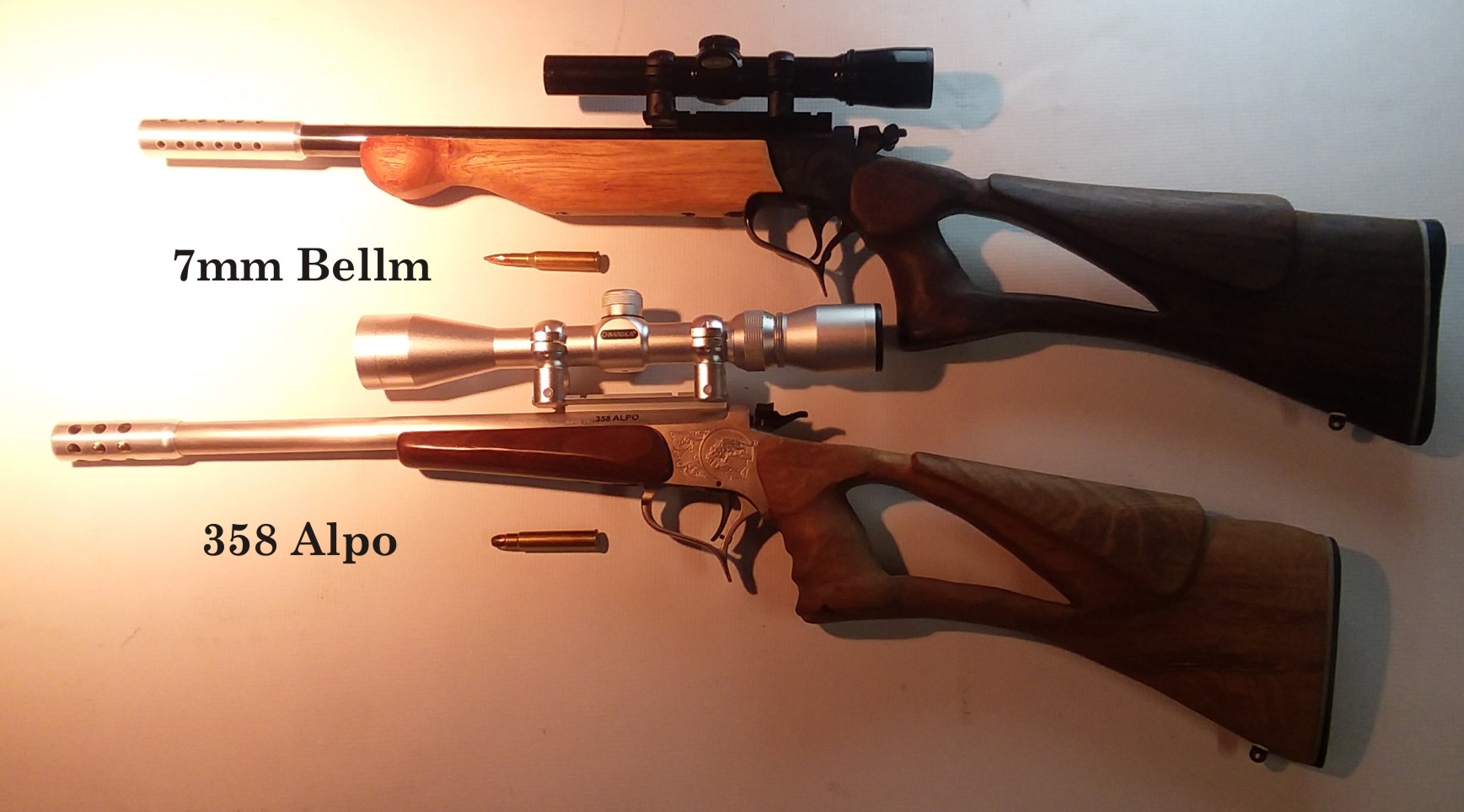

I love those rifles gemihur! I wonder what was going on with T/C that they needed to put all "big" cartridges in the Encore Frame lawyer restriction? FWIW, I've seen bigger cartridges chambered in the Contenders of old like yours. Not today. I agree with what you said above too, handle each and you will gravitate back to the Contender.
Speaking of which, I was out shooting my 7-TCU out to 300 today. Not all that successful, but 200 was solid for sure. I've decided the 7-TCU is about enough cartridge for me in a T/C Contender. I can still pump 50 rounds down in a day. For bigger ones, I've shot 30-30's, 7-30's , 6BR's, and 300 Savages (that hurt). While they have better ballistics I just find it hard to hang on to them for the number of shots I like to put downrange.

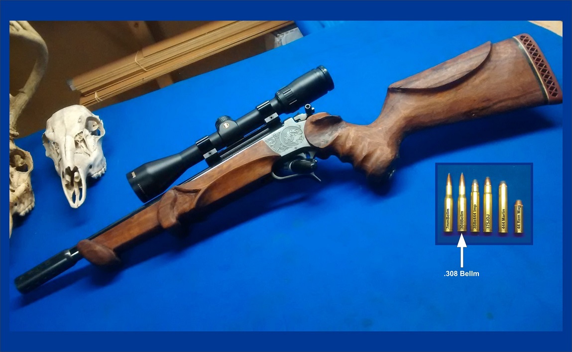

What loads do you run in the .308 Bellm? Sounds like a really nice cartridge for a lightweight rifle like a T/C Contender. I wonder if it ever got necked to 7mm or 6.5mm. 6mm? Contenders are no doubt a wildcatters dream.

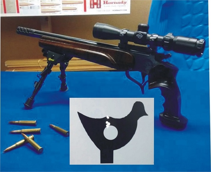

Honestly, the accuracy that I was used to from the Contender was one of the factors that led me down the cherry path of precision rifles.
then you have guys like mike bellum (SP?) that are selling oversized hinge pins because of the “inherent inaccuarcy” of the contenders....and people buy into that bullshit. talk about snake oil. I bet he could sell snow to the eskimos.
308 Bellm load data: https://www.bellmtcs.com/blog/308-bellm-load-data/
Don Shearer and Mike put this together it's good enough for me.
I like the 7-30 Waters but also use 7mm Bellm.

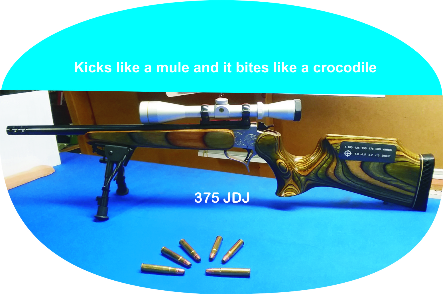

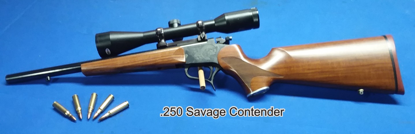

Actually mid-range calibers are my favorite, 6.5 Grendel and 250 Savage, but honestly my 375 JDJ is a handy and tolerable setup that I wouldn't hesitate to use if I felt it might be needed.

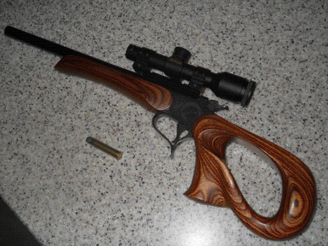

Shot a Contender pistol in .45-70 with a heavy load and the thing almost flew out of my hands when fired. :eek:
45-70's can actually be loaded pretty hot. The ones you are 'supposed' to use in a Contender are old black powder pressure loads. I've fired those and they aren't too bad. (300 gr. bullet @ 1200 fps) I believe this is where the load limit issue came to a head and why the Encore was created. Much like gemihur's .308 Bellm, it's capable of some pretty stout ballistics. But really needs to be loaded down. The frame won't really take it, much less your hand.

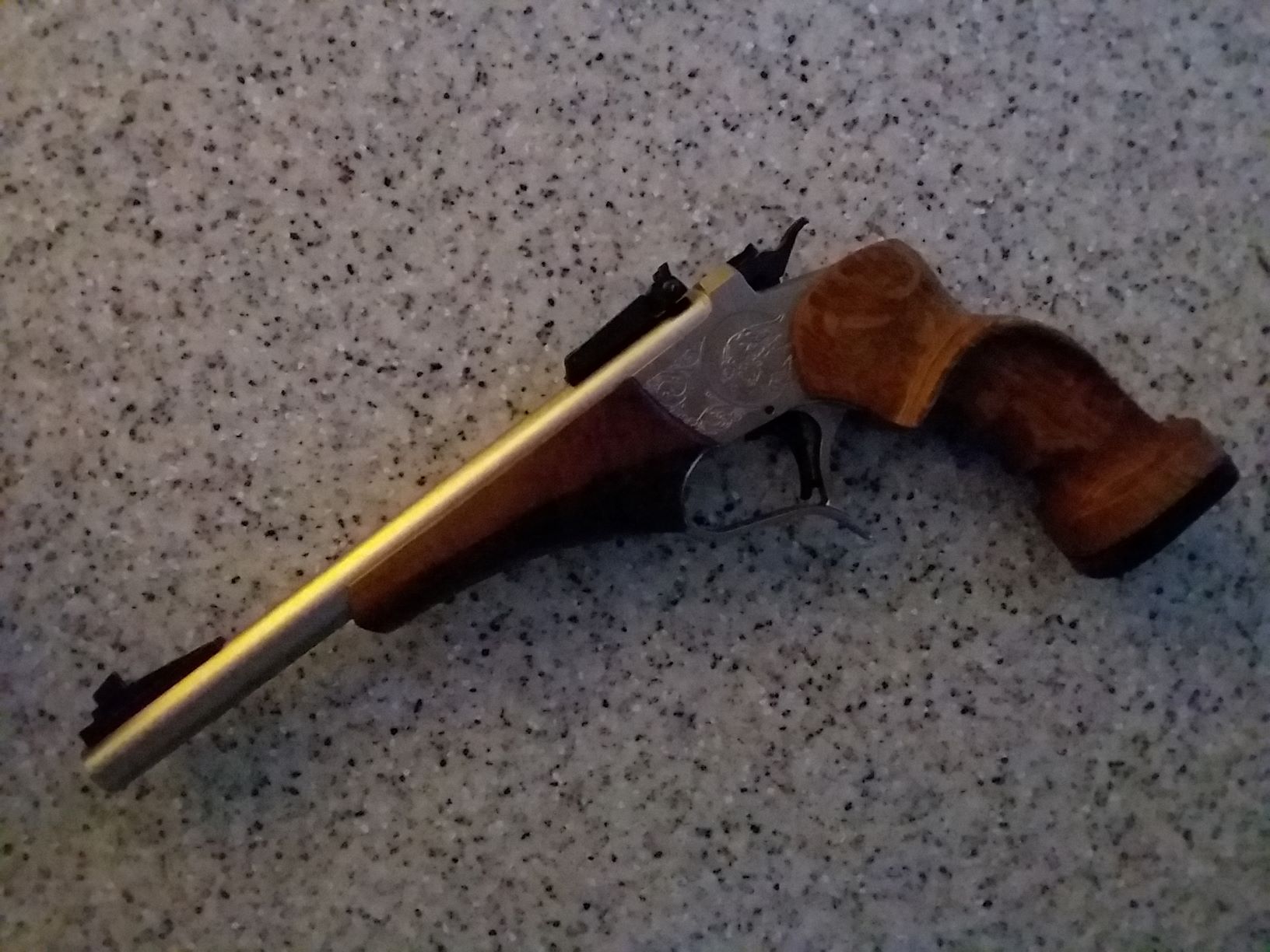

You have a gorgeous collection of Contenders and amazing stocks!
Pachmayr decellerator grips help a lot with the livelier cartridges. I used to have a 35 remington in the super 14 with the rynite pistol grips...and THAT really sucked to shoot. That was back when i had no pot to piss in nor a window to throw it out of. They make wood grips with a rubber recoil strap in the back, and the pachmayr grips. The grips can transform the shooting experience.
That I do. I started with a wood grip, then wanted one of those cushioned backstrap grips. Which they don't make for the G2, BTW. Then got the Packmayr rubber grip. I didn't think it was all that different until I put the wood one back on. The Packmayr went back on. I just really have to focus on grip before I pull the trigger.
