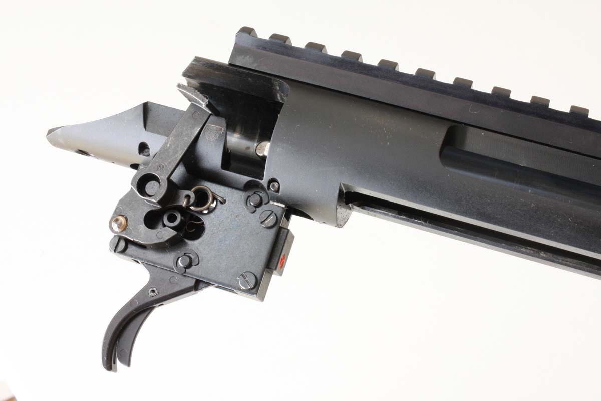

Hey ,
I have a Thompson performance center LRR in 6.5 creedmoor with about 450 rounds though it. I am having some issues with my trigger. 85% of the time it fires just as it should, but the rest of the time its like the trigger safety is hanging up and causing the trigger to get stuck. I have to really pull on the trigger to get it to fire. I have adjusted the trigger both ways trying to see if it will help the issue but so far nothing has helped. Need less to say when this happens it ends up being a pulled shot.
Has anyone else had this issue. I have called Thompson they said I could send it in to then but could be 8-12 weeks to get it back. Is there a way to remove the trigger safety.
Does anyone know of an aftermarket trigger that will work for this rifle.

Whoa, I just read this and wondered if I wrote it, knowing I've asked others. So I have the same rifle and identical issue! They told me they are very light on work now, and should be 3-4 wks.
Heads up I had one hang, and more force didn't make it fire, I pulled my hand off the trigger while still on target and it fired. That forced me to stop trying to push thru, and just send it back.
Yup same issue, out of the box. I did notice if you trow the bolt up and back down it release the trigger mechanism.
Looking for upgrade, awful trigger feel. Very unpredictable.
My HS HTR breaks like an icicle. The timney on my AR-10 is better.
VERY POOR trigger......stunning and disappointing.

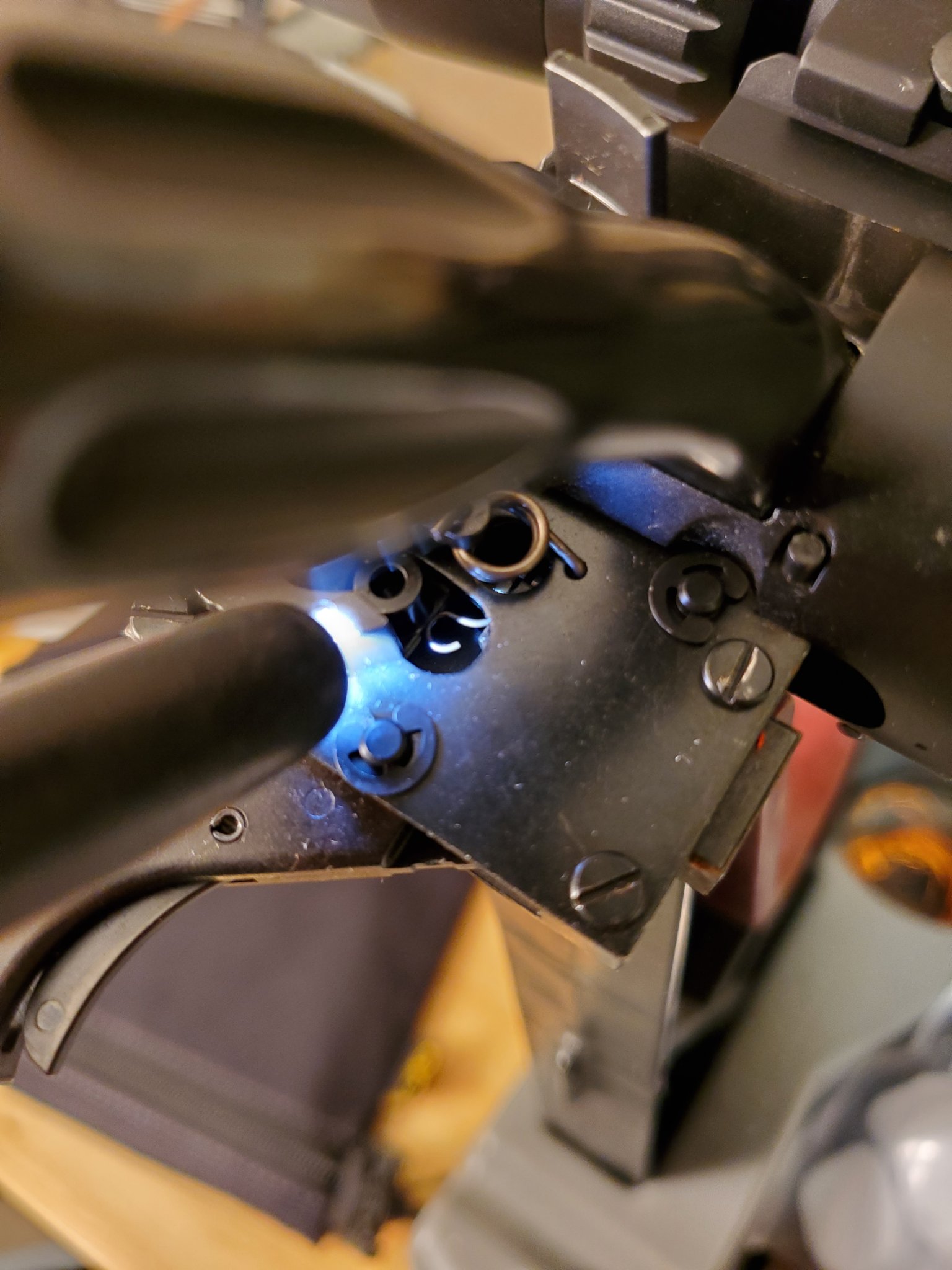

January 30 2021, last weekend we took the new lrr out to sight it in, trigger locked up after fewer than 20 rounds. Today we took it apart to see why. For any of you metal fabricators out there it would be an easy fix, why tc doesn’t fix it is beyond me. The spring that holds out the trigger safety rides against the actual trigger in a less than adequate slot. Mine had come out of the slot and was binding between the trigger and the housing. My son is a mechanical engineer and saw the issue clearly and is devising a fix. We saw these posts while looking for any TC information on the issue amd determined that trying to get a solution from tc was going to be an ordeal. One more thing, apparently no one in the gun community has bothered to show a parts breakdown on the trigger assembly and an explanation on its design. I hope to remedy that.
Your son in going in the right direction. From what I can tell, the small spring rides on the face of the center trigger safety which is slightly recessed back from the face of the main trigger. This spring is light and moves around and can pop out of the small groove that it rides in. I believe this particular springs job is to reset the center trigger safety forward.
I sent my rifle back for trigger replacement and to have the chamber cleaned up (it looked like they reamed it with a chainsaw). The trigger failed after about 15 shots.
I think the key is to keep that spring in place. I noticed that friction would sometimes cause the spring to hang up high on the surface it rides on. Once it pops out of the groove, the trigger will seize up.
I put a little bearing grease on the spring and groove and that helped quite a bit. Recoil will cause the spring to move out of place sometimes though. I may try a heavy grease to try and dampen the spring movement.

In the attached photo you can see the loop in the spring end. This is what rides in the shallow groove and will hang up or pop out.
I took a video of the problem and wrote what I saw and sent that info in but the performance center ignored it.
