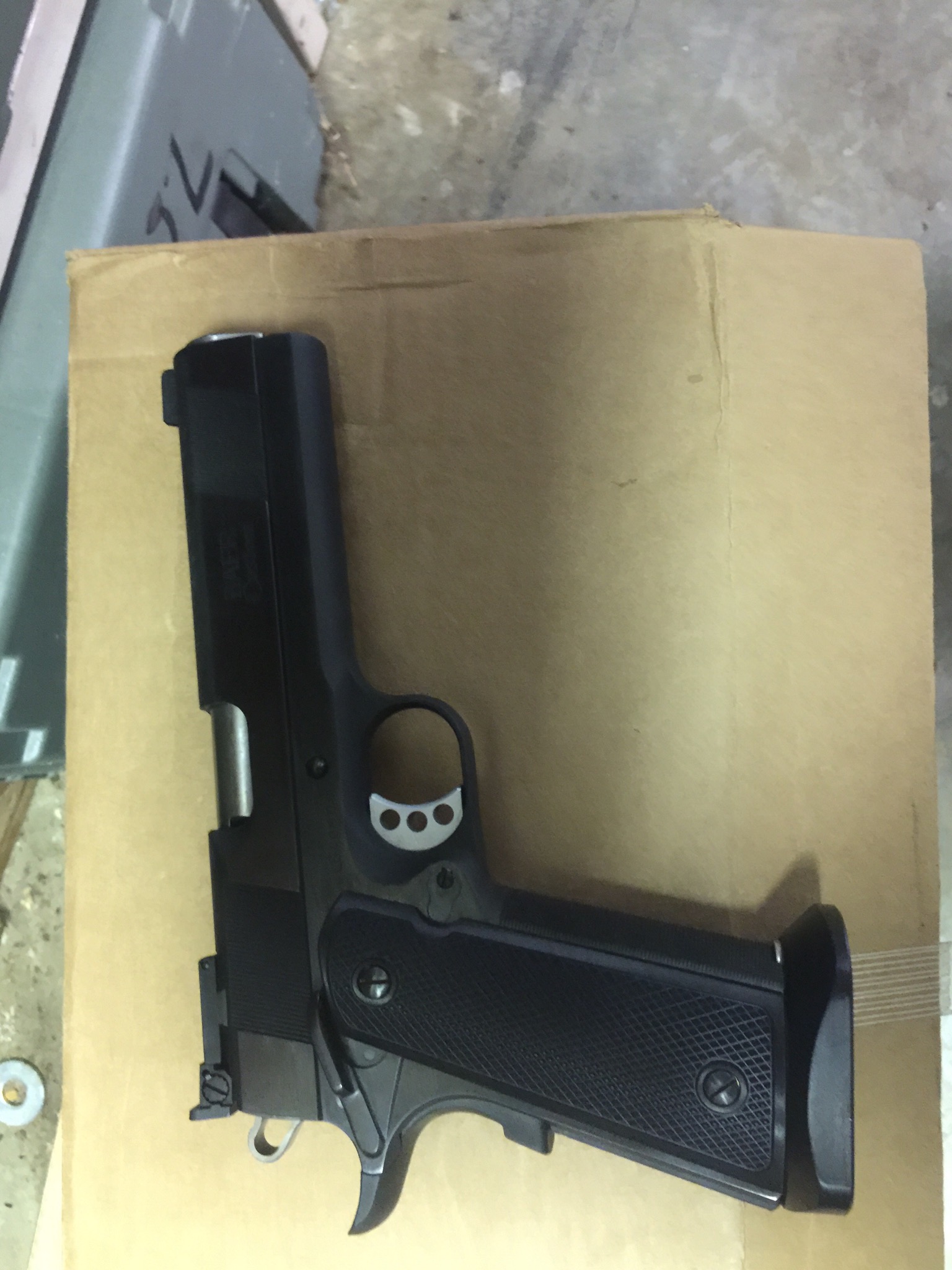

NightHawk Customs Heine Signature Competition. Five or six people have shot it without a hiccup. One other person had multiple failures to cycle all due to an inadequate grip. Very well put together pistol. Functions perfectly with various 115gr. bulk. The same functioning with 124gr. and more accurate. My carry ammo is Federal 124gr. Hydrashock and it has been one hundred percent reliable with better accuracy than any bulk.

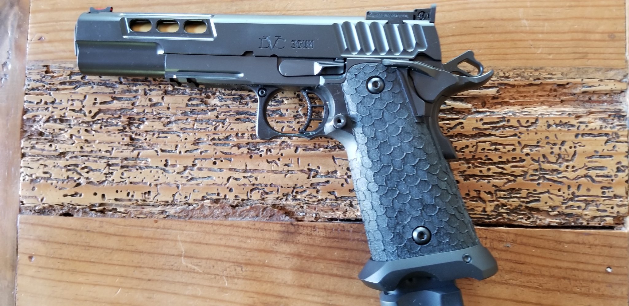

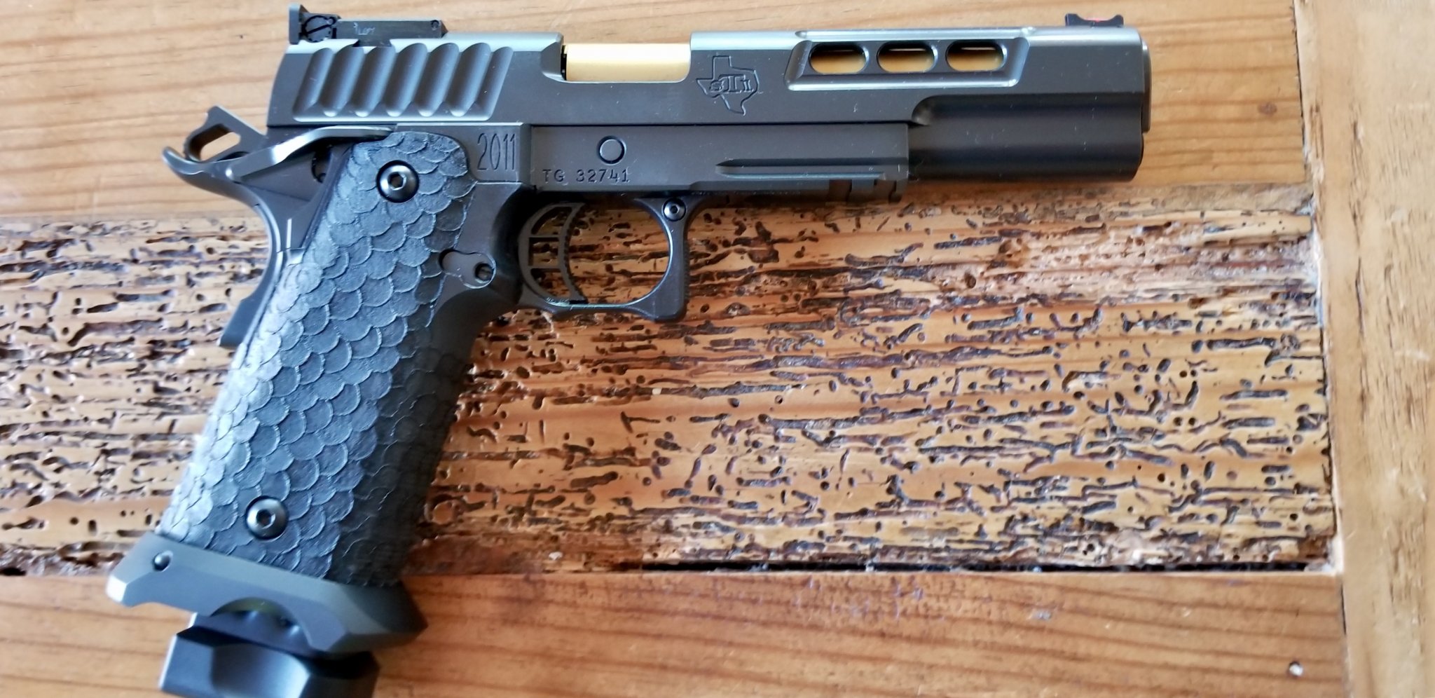

Also have a 2011 Tactical 5.0 that is getting better with work - have blown out single hole groups at 25 from a rest. That was an eye opener.

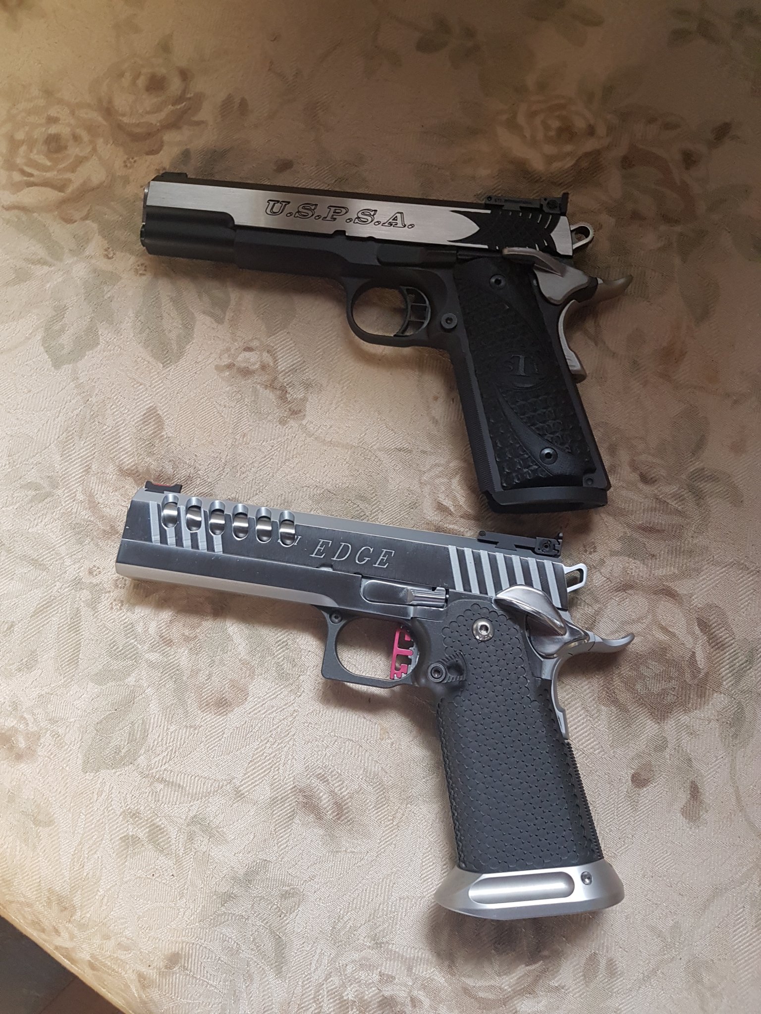

The 4 1911s/2011s below are as different as I could pull off the wall. Akai Limited 40, STI Marauder 9mm, Kimber Raptor II, Sig C3 Compact.
Speed. Maintaining A zone at 7 yards, my fastest splits are with the Marauder at around 0.12. I have north of 50K rounds through this gun and not a single malfunction. The only other gun equally as fast for me is the Benelli M4 that I can also get to 0.12. I can get an AR down to 0.10 on rare occasion.
Point here being you are not going to outrun the gun when it is set up correctly.
The Akai stays around 0.14 - 0.16 due to major power factor. The Raptor is about the same speed though the A zone % may drop a tad (b/c of me, not the gun). The C3, with that short slide and alloy frame, is the slowest simply because it is the snappiest. The C3 has the fastest cycle time but the slowest splits.

I just jumped on the 20l11 style and love it. Picked up the STI Omni in 9 MM and couldn't be happier. Only shot 350 rounds so far but not one hiccup. this is my first 9 and first with a compensator, damn thing shoots FLAT and SMOOTH!

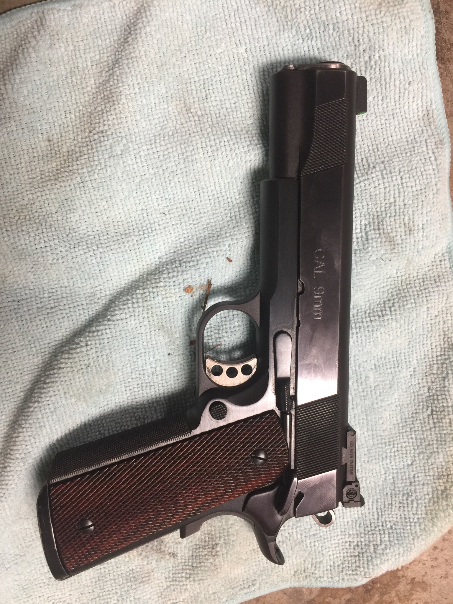

I run the colt 1911 commander in 9mm, has 5000+ rds down the pipe. Ive replaced a lot of parts with wilson combat over the years but i would highly recommend. It was great out of the box but has aged even better. Very fun on the range, very accurate, cheaper to shoot than 45.
