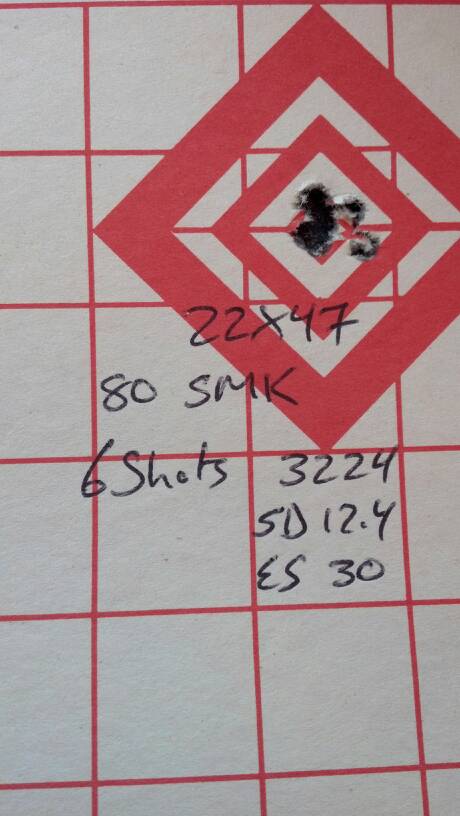

I just built a 22x47 with an 1-8 twist shooting 80 smk and 80 Amax. I'm getting 3300 with both bullets. Shot almost 100 rounds through it so far. I'm not sure on barrel life but it sure is fun. The brass will be more expensive but it's lapua and should last. I have a 6x47 and building a 6.5 so it made more sense to use the x47
Sent from my iPad using Tapatalk
Very nice, I bet thats a fun round. What kinda 5-shot groups are you getting on average with it? And what powder are you using?
I'm using 37 grains of H4350. Its awesome to shoot
