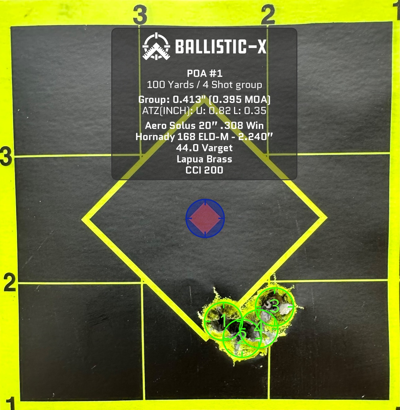

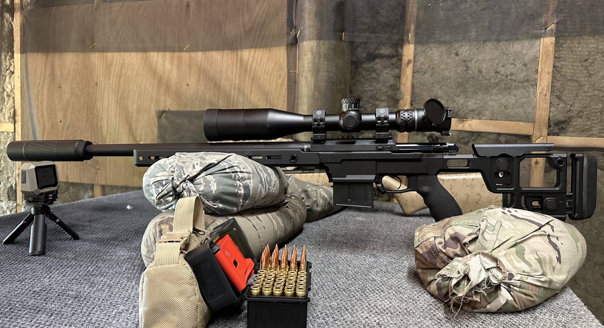

I'm debating trying a budget rifle build with an aero precision barreled action(probably in .308), and would like everyone's opinions.
Mine has been extremely picky, but I found a sub-1/2 MOA load with Hornady 168 ELD-M’s with Varget, and that load has consistently put down ragged-hole groups @ 100.
Reactions: The_Butcher
