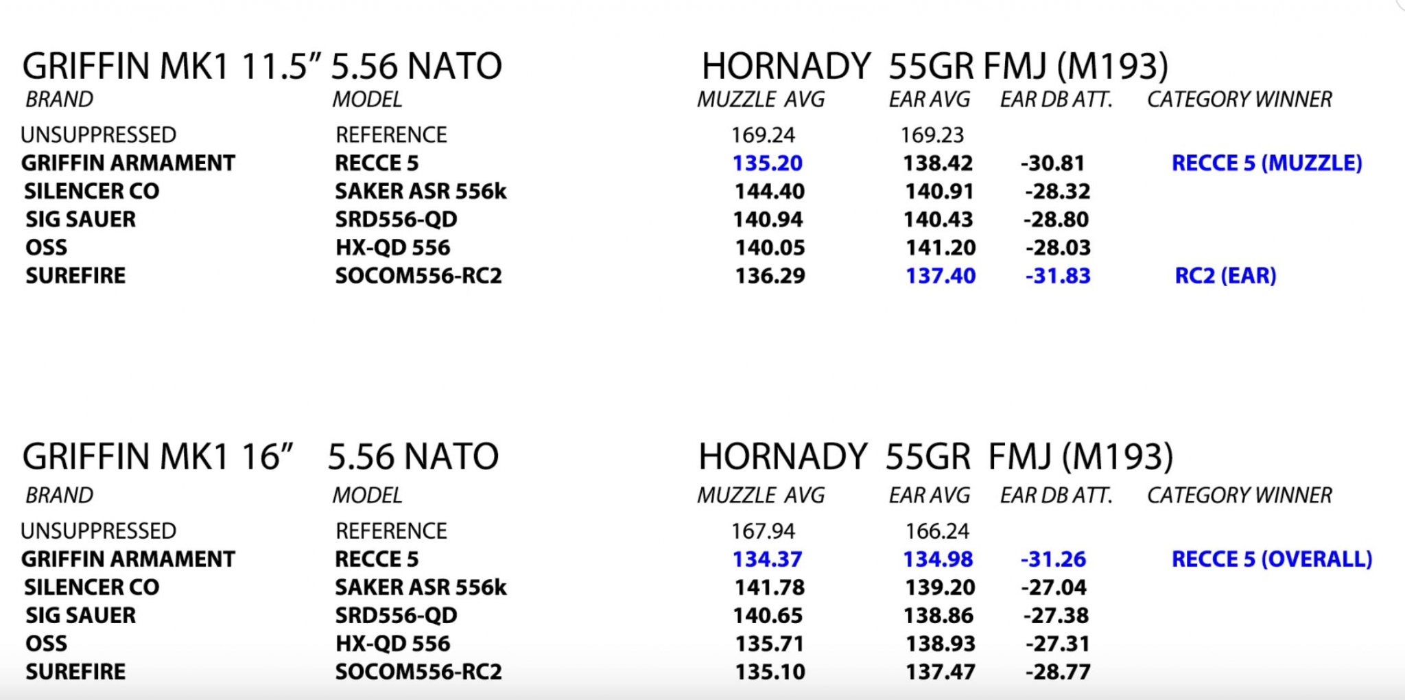

Here is a screen shot of the results of hearing tests Griffin did for an older version of their Recce 5 in a same day comparison test. The newer ECO baffles in the latest upgrade improve their model by a three DB at the ear over what is in this chart.
Regardless this is what a third party got using some expensive ass equipment for the RC2. It's actually really impressive. With a 30 cal can you will get about in the low 140 DB at the ear regardless of manufacturer (there are however exceptions). That is specifically referring to a 30 cal can being used for 5.56 in a 11.5" configuration. I say this because they published repeated comparison tests so that should be at least an indicator.
In short, the RC2 has my vote among the choices you presented. I don't own one but it seems like a really solid choice.
