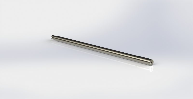

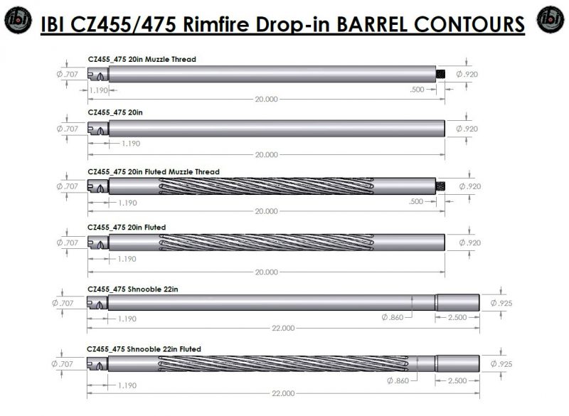

I had an MTR but it had cold bore issues so I sold it. I'm thinking of getting another and putting an IBI
Shnooble barrel on it. The standard is 22" but I would prefer a 24" tube. Straight flutes???? Maybe.
The ot5her MTR with the chassis or poly stock both have visually unbalanced barrel to stock length.

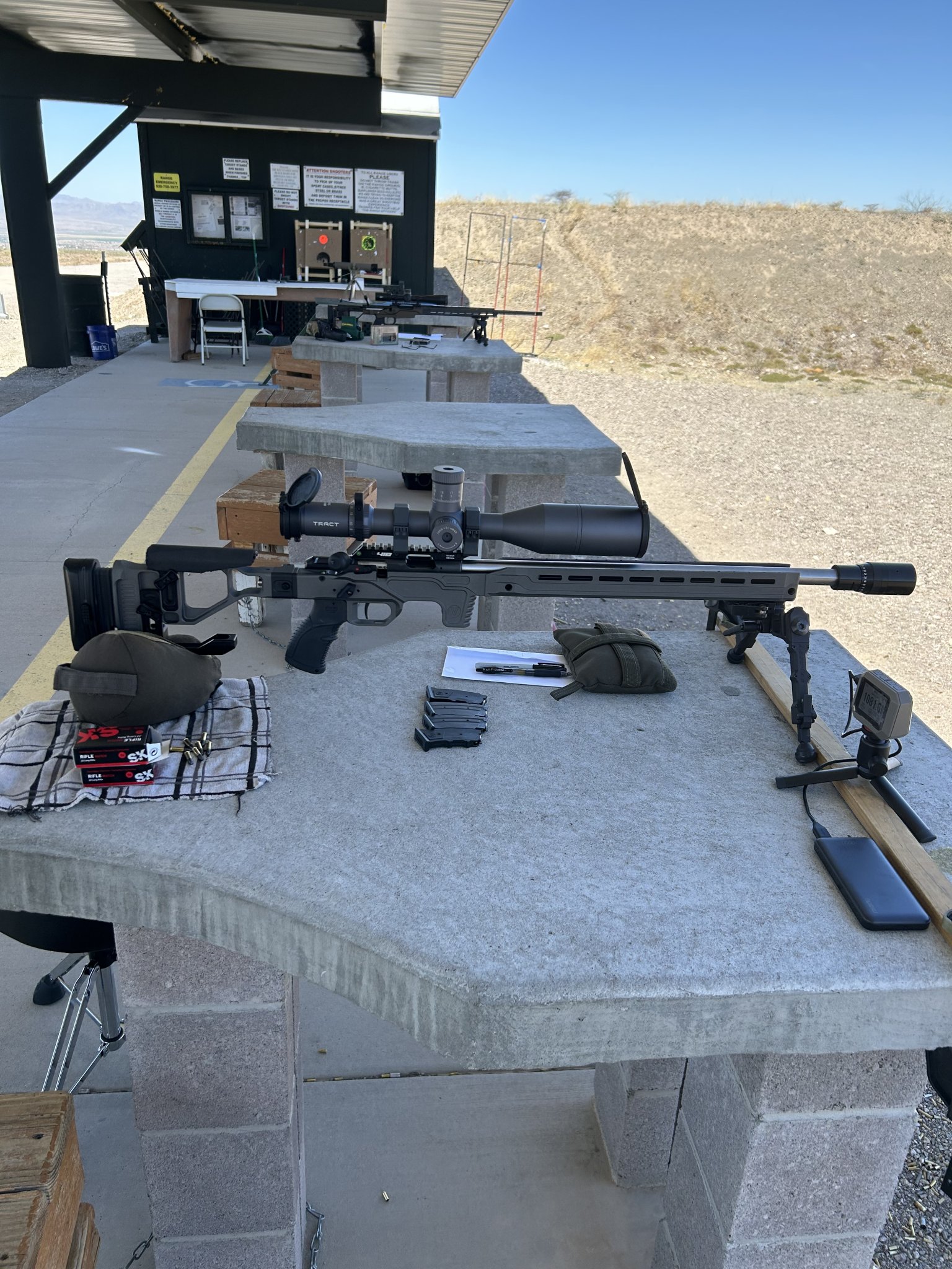

Hey guys! Thanks for all the help. Planning to try out my first NRL 22 match on 08/04 just for fun. Won’t be using the suppressor for a match. Still like to be able to shoot everything I have suppressed when I want, just for fun. Still interested in building a CZ eventually. However, in a grand turn of events I ended up completely going a different route for now. Bought a Bergara B14R 20” heavy barreled action from A&J sporting goods. Planning to put it in a MDT Premier Gen 2 chassis and trigger tech diamond. Thanks for your help!

you will be happy with the B14R. I have 2 factory guns with 18" barrel in factory stock. I also have EC V2 tuners on both.
