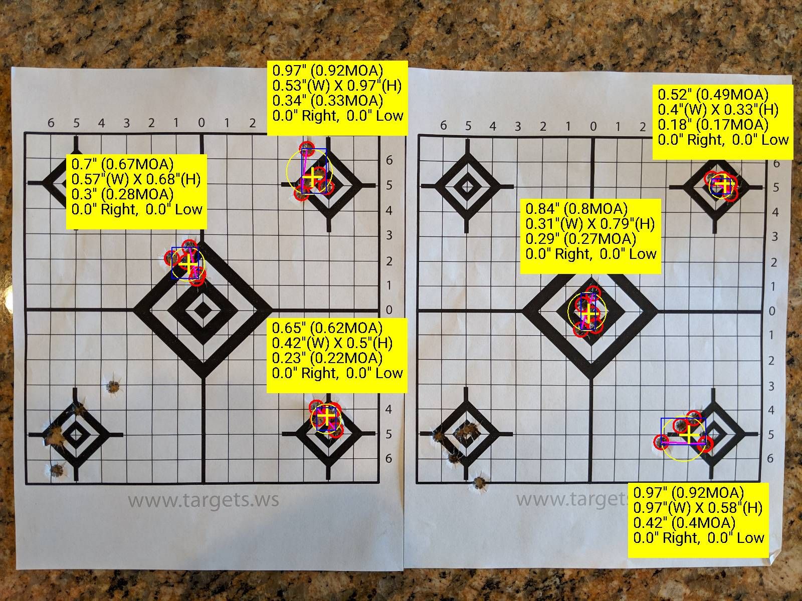

Did a 6x5 today with the 2-stage Timney. To be honest, 2-stage Timney @ 1lb total pull, vs stock trigger @ 1lb total pull, I don't see that much difference. It is nice to have a clean 0.5 lb break on the 2-stage which I could see would make it slightly easier to be precise. First time shooting prone as well so there are some fundamentals I can do better on...
Other groups are my partner shooting

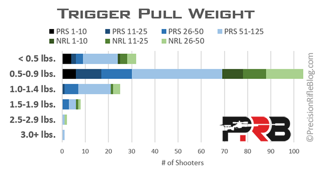

Serious question, because I would like to know if anyone has been successful with this pull-weight and the overtravel, have you done well with this setup in PRS? Most top competitors are running 10oz or less and even some of the better shooters I know running other platforms realized that anything over a pound is hampering. I want to see how well I can do with a 1.0-1.5lb trigger but I don't know anyone that is winning with it.
I would worry more about fundamentals than winning. Shooting with 4-10oz triggers because it's the only way you can hit a target successfully is just poor fundamentals and more about gaming the system. Yes.. 4oz trigger, 30 lb rifle, 6Dasher, don't even get behind the rifle, just tap that trigger and the rifle will fire w/o even moving.
Caylen does plenty well in PRS matches with his 1.5lb trigger.
Alison Zane I believe is one of the top young gun shooters and runs a Huber 1.5lb I think.
Personally I would get good at shooting with a 1.5-2lb trigger. When you mastered that art and fundamentals, then put on a 4-10oz trigger if you're at the top tier of PRS gaming.
OK, got it. Fundamentals, thanks.
I shot with a 2lb trigger for quite a while and really seemed to drop unnecessary shots on targets that were less than 2 MOA and the position had some wobble. I could see the reticle and movement line up but was still applying pressure to the trigger when the conditions changed. Once I moved to a 10oz trigger I could leave a match knowing that I only pulled 2-3 shots out of 100 on a bad day.
It definitely correlates to the target size because I shot all but one of the matches in the 2018 Gas Gun series with a 2.5lb trigger but, with 4 MOA targets, I rarely pulled a shot off target.
I would be curious to know how many shooters in the top 20 of points are shooting a trigger heavier than 1lb. This debate seems to go the same as the rifle accuracy discussion. Some guys will claim that 1 MOA is sufficient to be competitive but I don't know any top level shooters that would settle for that.
Reactions: littlepod
It looks like none to answer. As mentioned, the game is the game. How many people in PRS are running < 18lb rifle, probably very few too.
How many top 10, don't handload, probably none.
But it doesn't mean I need to handload, or run a 25lb rifle, or run an 8oz trigger to be a good shooter.
