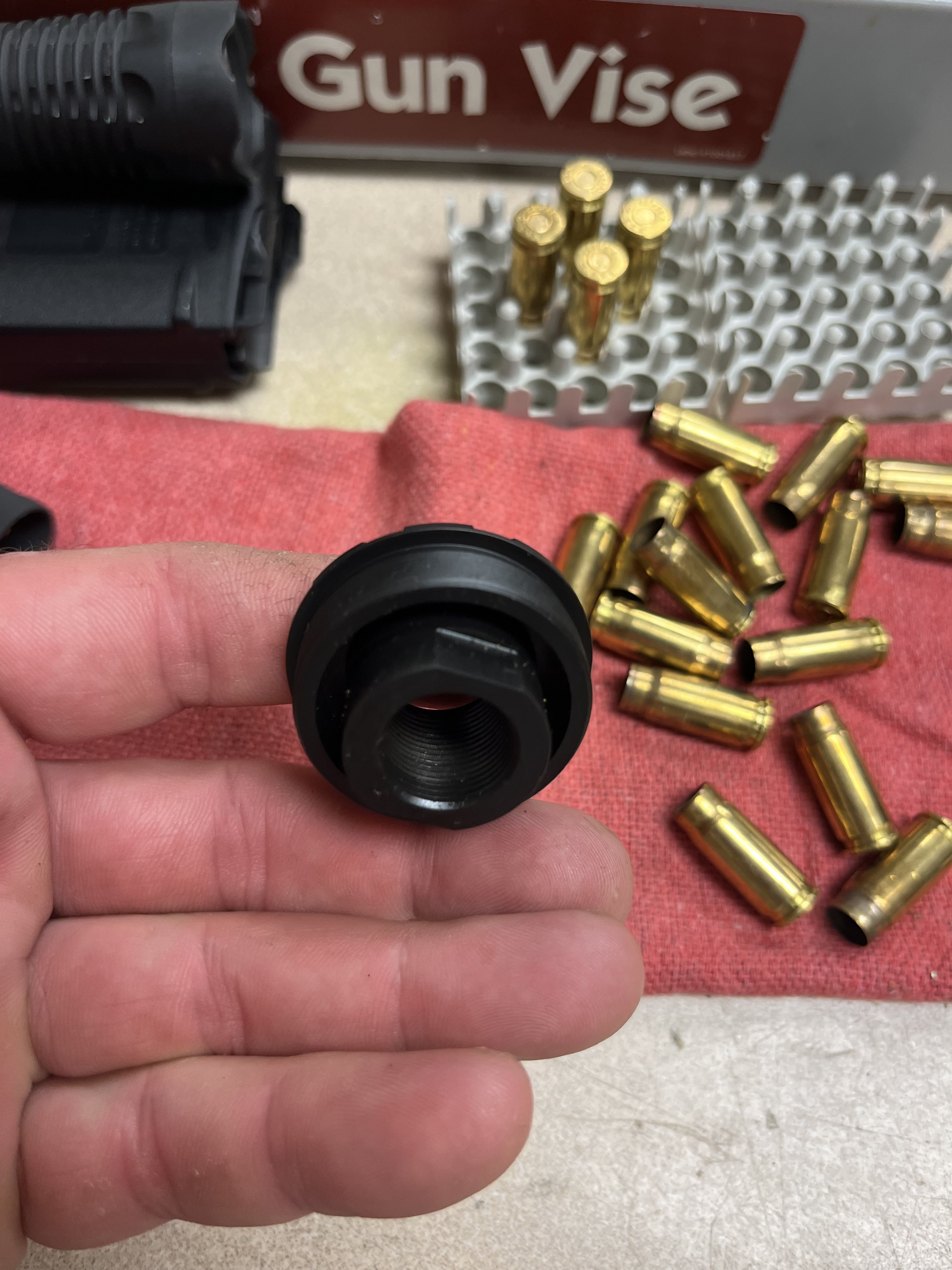

Fella on here is/was selling some that didn’t have that nub on the end. I bought a couple and they are nice. Not a huge difference, but the cap sits flush with the shoulder on the barrel
he never listed a brand, just some contract overruns he procured I think. Maybe he can comment? @BulletScientist

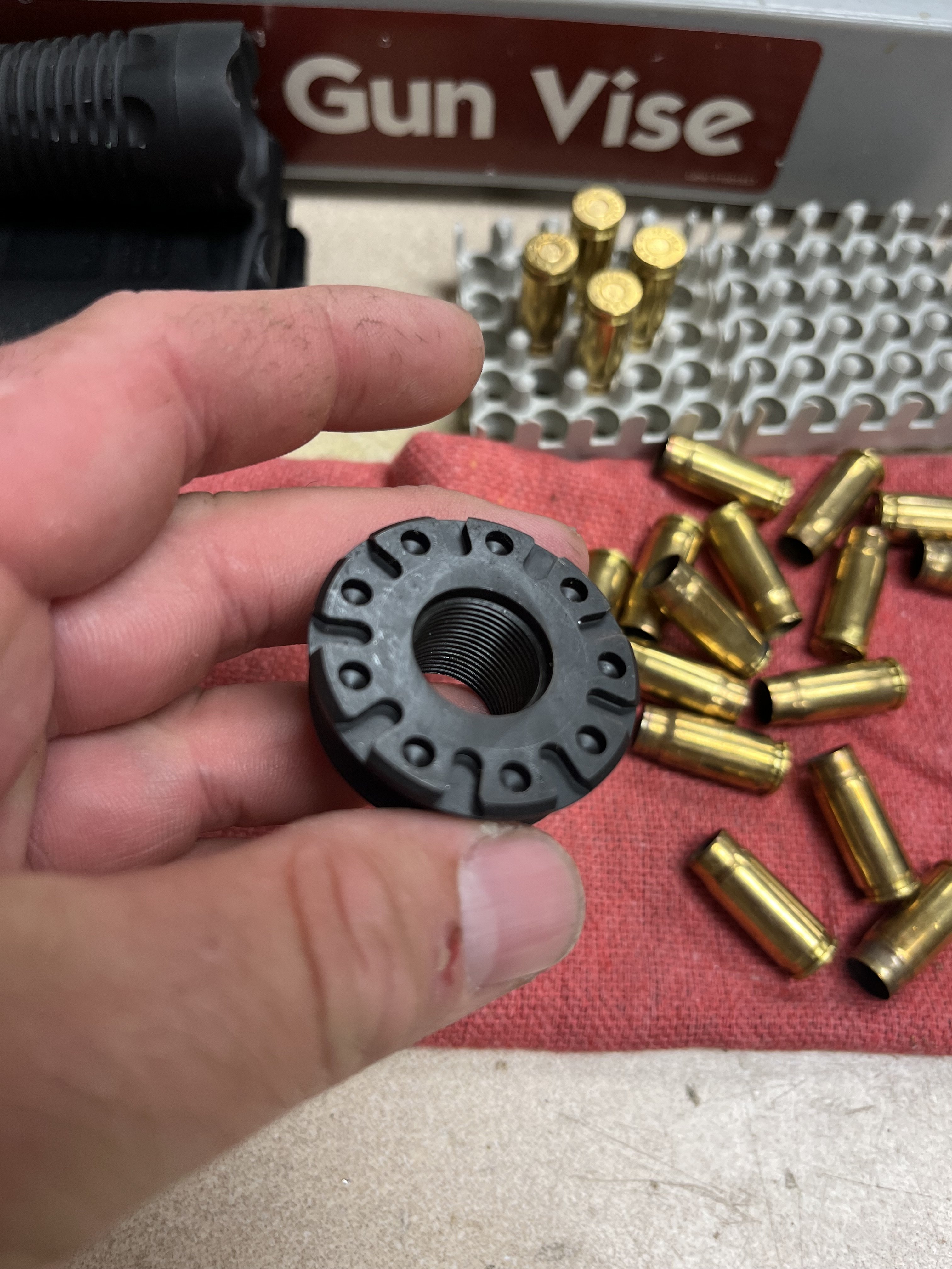

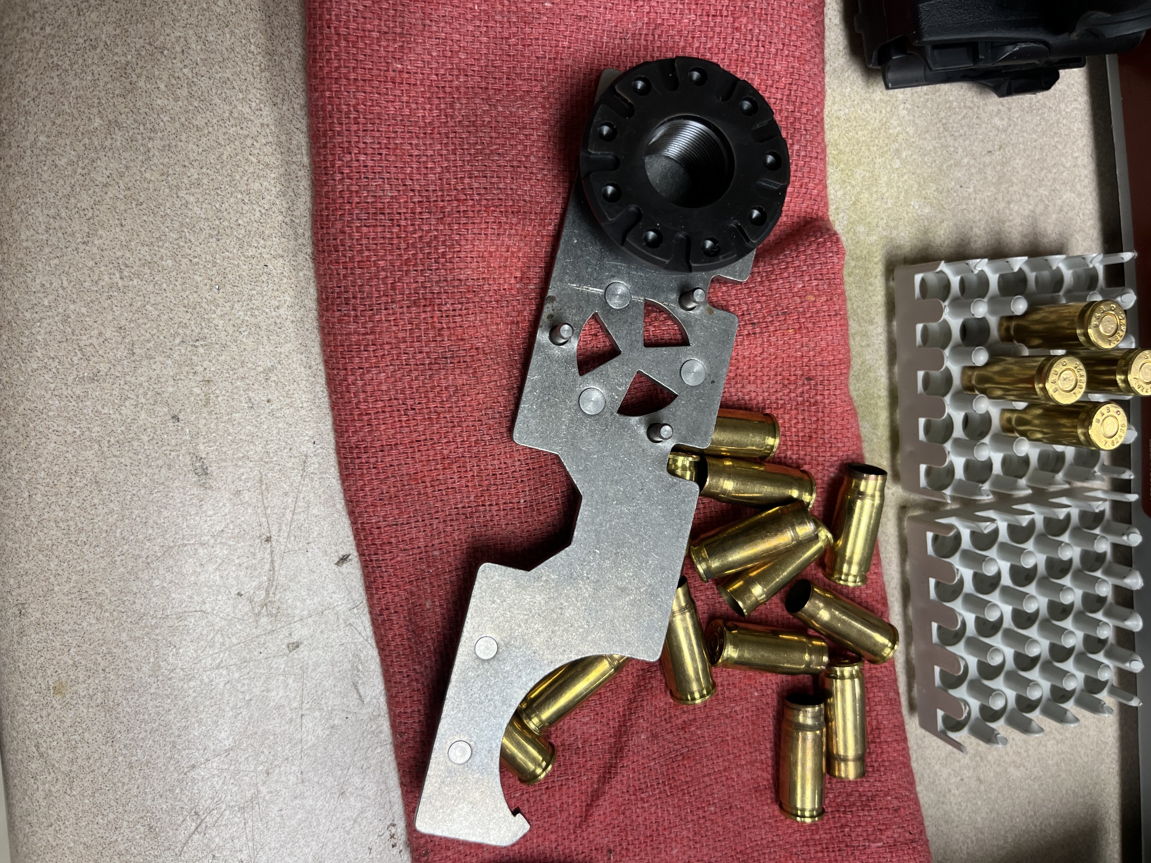

Here are the hub mounts
Reactions: carbonbased
Reactions: roostercogburn98
Those look to be nearly identical to SilenceerCo mounts (I have a couple of those too). They’re nice, but require a compatible tool to remove from the back of a can.
Tool comes with every one right? Did with both I got, sealed in the bag like factory.
