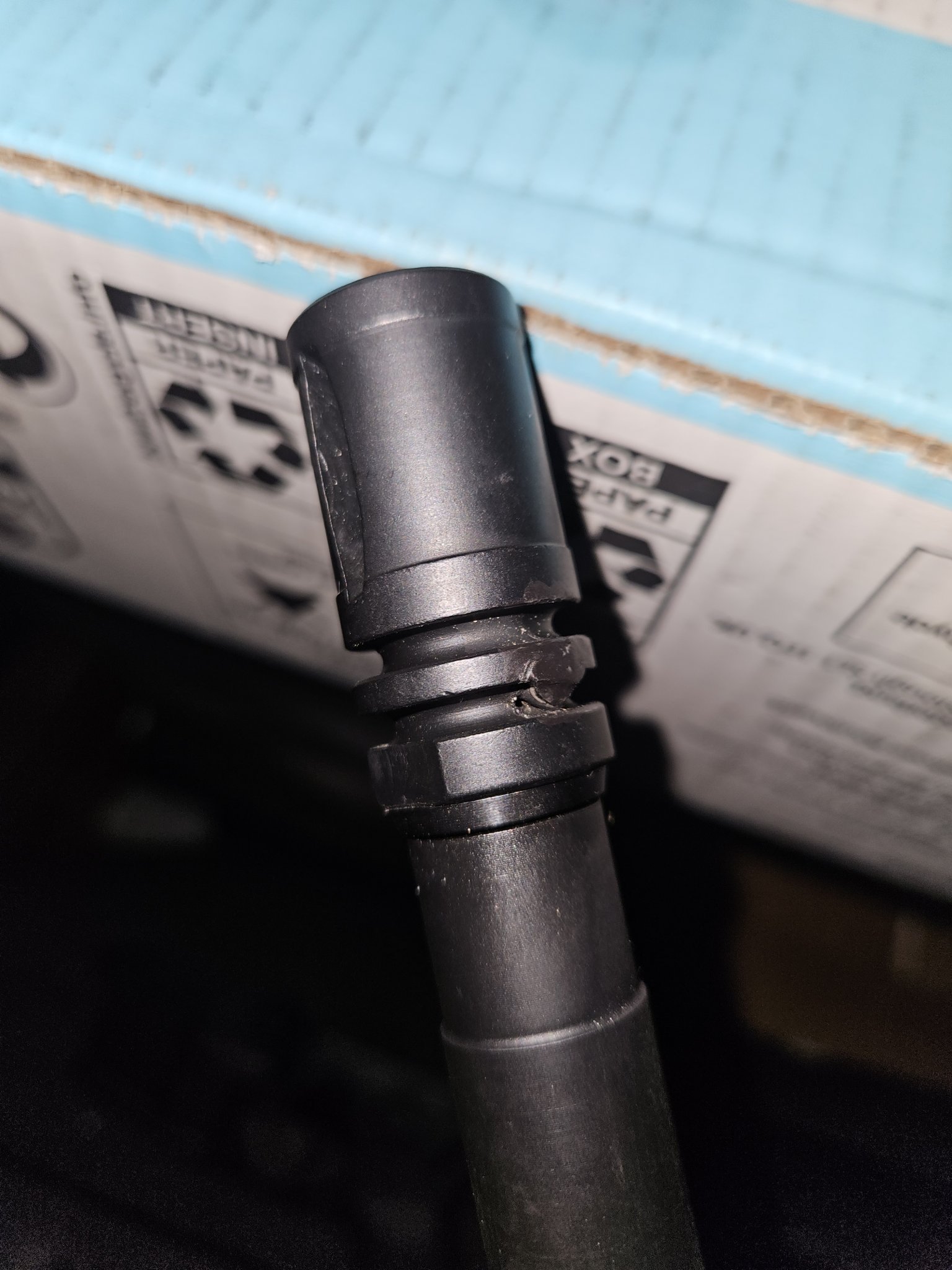

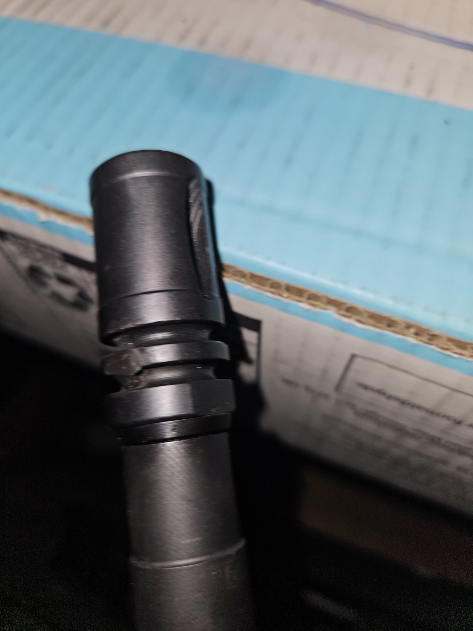

Thoughts on this weld job?
sroc112
Feb 17, 2024
147
55
USA

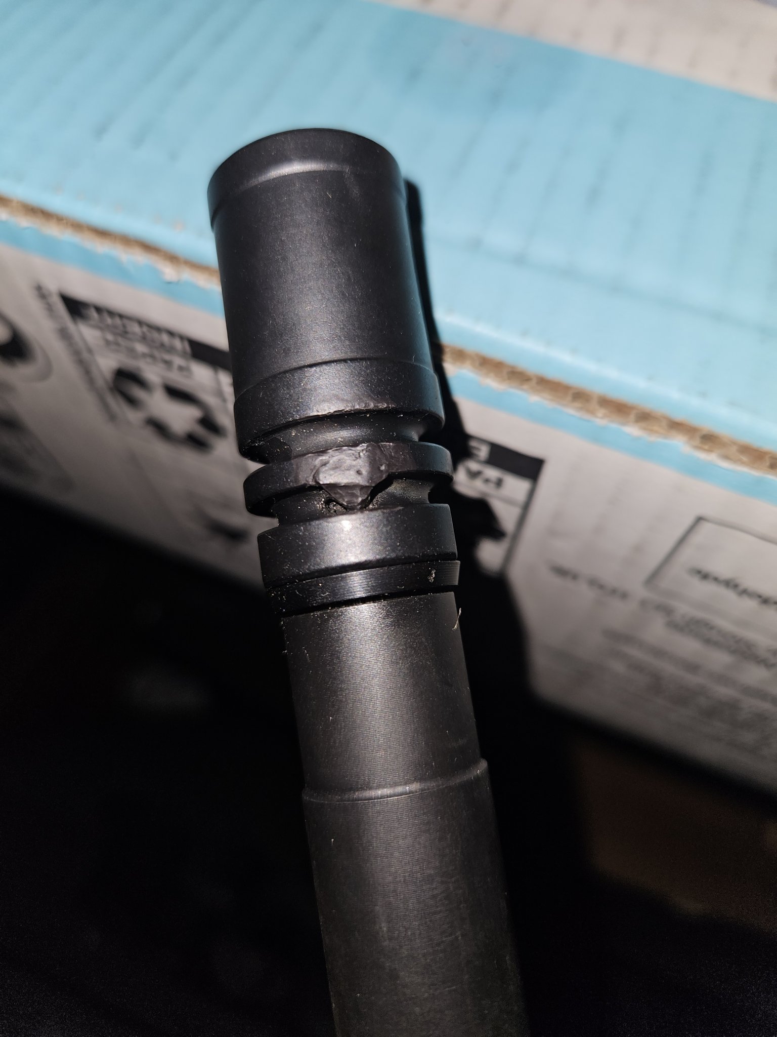

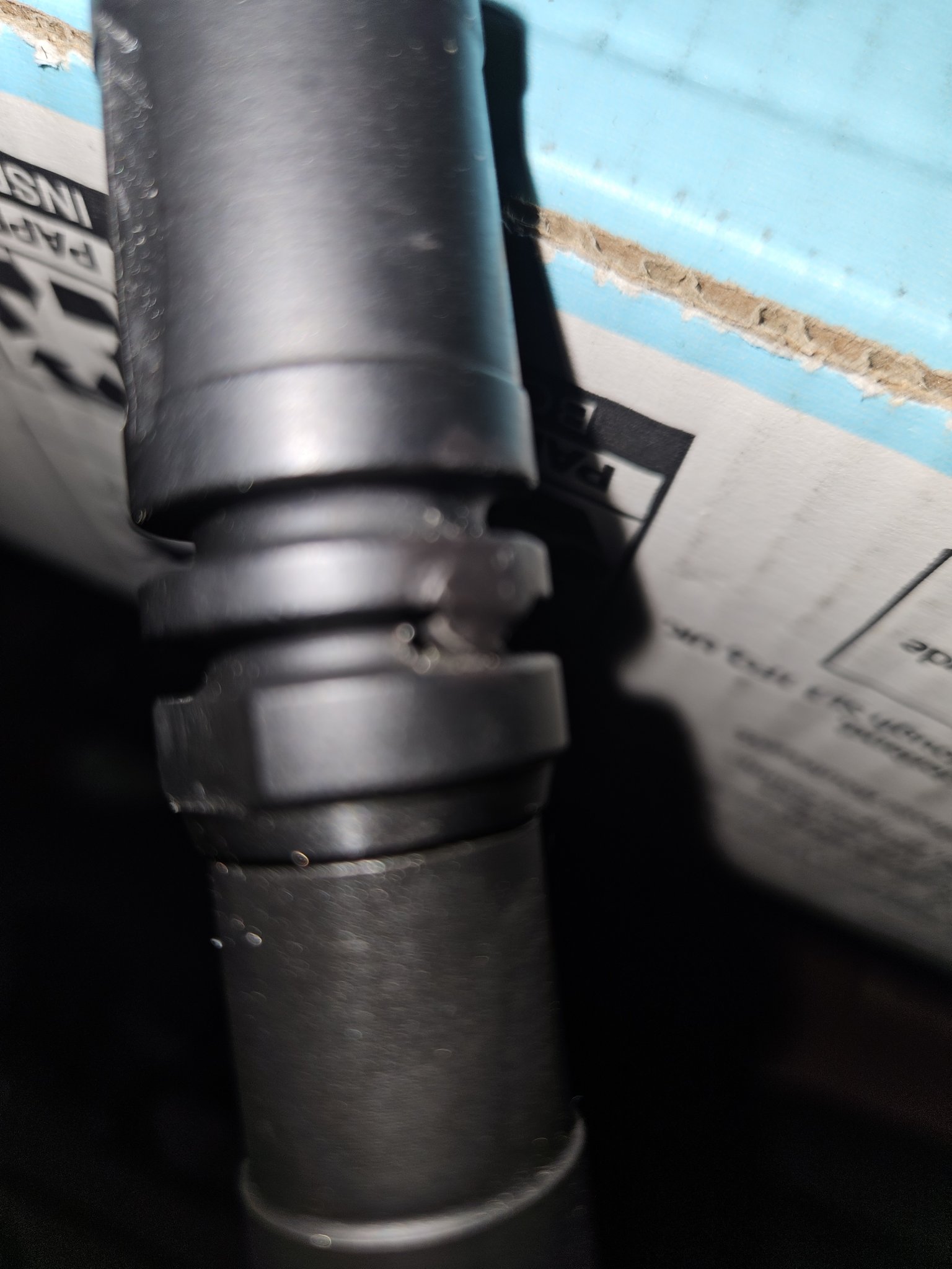

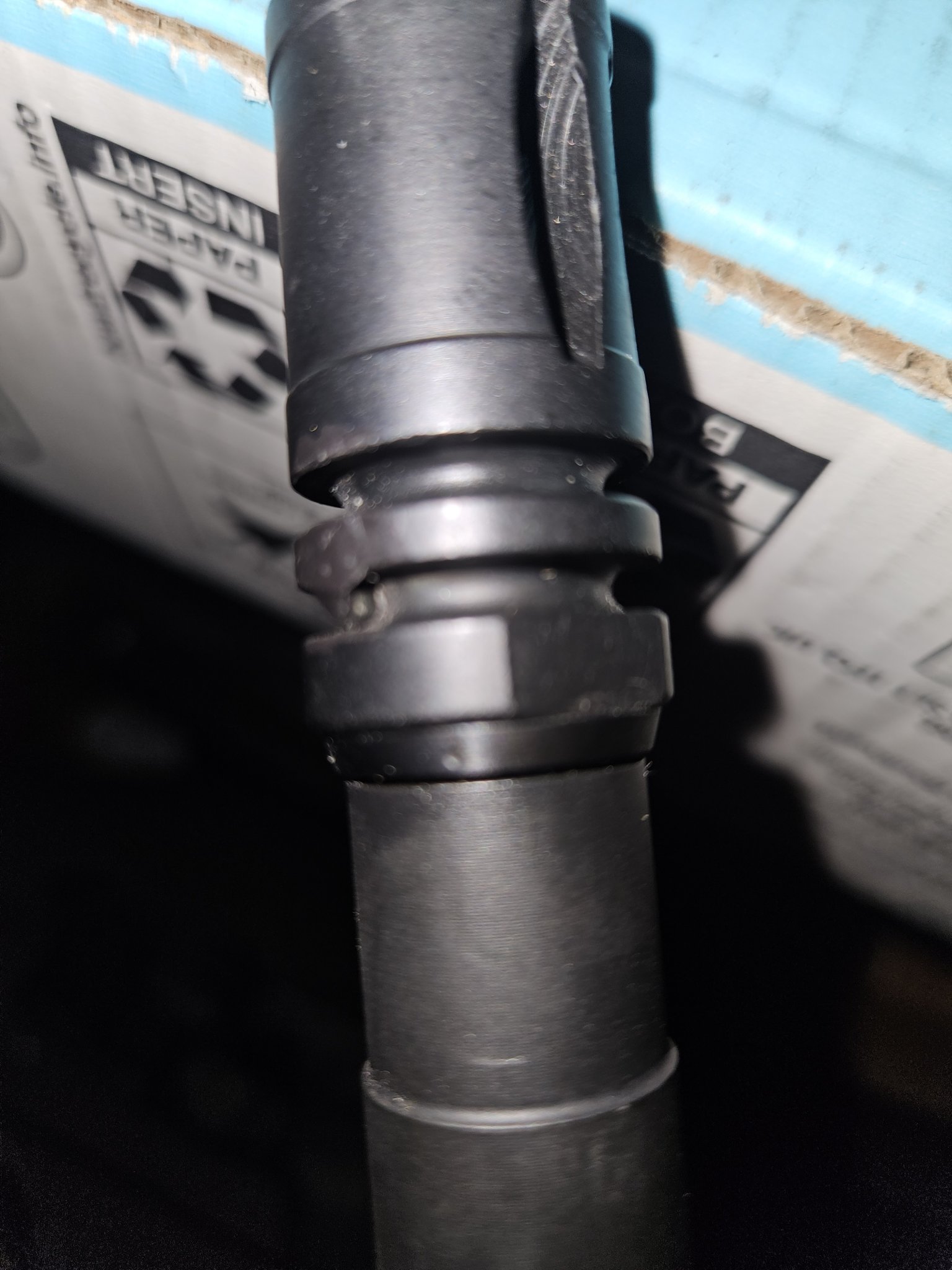

Had a basic muzzle brake oinned/welded on a new upper. Used a new shop, was the most convenient based on location and timing. generally speaking, does this look how it should on this type of brake?
Sorry, not all pics are super clear.

Most gunshops are not pro welders. It's effective, legal and you probally got what you paid for.
To prep, weld, clean/grind and refinish you are talking a couple hundred in labor. I would touch it for less than $250.
I'd consider trying to replace it maybe down the road, but how will I know it its able to be taken off without completely destroying the thread?
That is bizarre. Did the drill the hole down the the "valley", leave the pin long then sorta dun-lap the weld over onto the high spot?
(Do the not own any files?)
I'd honestly wonder if it was really welded and not JB Weld or something.
They did you a favor, seriously.
The more obvious the weld, the less the ATF will probe your rectumus eximus.
They might still try to probe your prison wallet and steal your property, but there won’t be much of a case to take up in court.
It’s why I like my P&W jobs blatantly-obvious. Not all the ATF agents are remotely-competent in this stuff, but someone will eventually see it and say, “Tell him to pull his skinny jeans back up and let him go. Keep the weapon in evidence for the boss to see if he wants it, then if he doesn’t want it, we get it."
Think about how a low-IQ connected family Mafia gang would operate and expect that. You won’t be disappointed.
I’ve seen a lot worse from places. It’s not the cleanest job but I’m sure it’ll hold just fine plus it’s easy to see that it was pin/welded if someone were to check it.

terrible
send to Monmouth arms in NJ. Absolutely the best I've ever seen, can't even see it.
Real bummer, because I was going to use monmouth arms and last minute ended up using this shithole. Steve is a good dude, dealt with him in the past. Hopefully he is able to undo and remove the hack job I have. I'll reach out to him. Was debating shipping out to dwilson but monmouth arms would save me the shipping time/costs.
Because I have to in my state and didn't feel the need to pay to upgrade to a different brake. This shop tried to upsell me on a BCM brake but I'm glad I declined. If they would have done this damage to a brake I actually paid for, I'd be even more upset.
he really is a great guy and does fantastic work. I could upload some pics on the ones he did; you can't even tell!. I'd go Steve only cause I trust him having known and used him for 15yrs. I'm actually dropping something off at his house later on my way to pitching practice with my son:)
you in NJ?
It is what it is. If you don't like it, it's easy to replace. Nothing is ruined, just drill out the weld (best done with a special two flute carbide drill), chase the threads (the old pin hole is not a problem), and pin and weld another brake.

I have 2 quotes from 2 very well reputed shops to remove and install new for less than $100 total. Me supplying the new brake as I have one I'd like to use. One shop I'd have to mail out the upper, the other is in my county. I'll have this fixed up within the next month, once I get time to getting to it. I'll post up the new pics once I have it.

There are a lot of so called "Gun Smiths" out there that do some really shit jobs.
I need to do a bit more research on the ATF guild lines for permanent muzzle devices but one of the ideas I've been kicking around is to mill/drill the Muzzle devices/ barrel the same way you would for a standard P&W job but thread the Muzzle device pin hole and use a threaded set screw like the picture below. Then Cold Spot tig weld the top pin hole on the surface of the Muzzle device.
That way down the road you can have you smith drill out the spot weld and pull and salvage the barrel, Gas Block and Muzzle device for other builds or if you aquire a SBR lower you can free to try other Muzzle devices.
Its fine if it works but its ugly, in the wrong spot and theres a hole.
Its obvious which is good. Doesnt need to be THAT obvious though.
I'll bet the the "smith" drilled that out on a vise with a hand drill, slipped and missed a couple times trying to bore into that smaller shoulder. Now you got the BBC (Black Bubblegum Cover-up)
added: Ive seen worse...

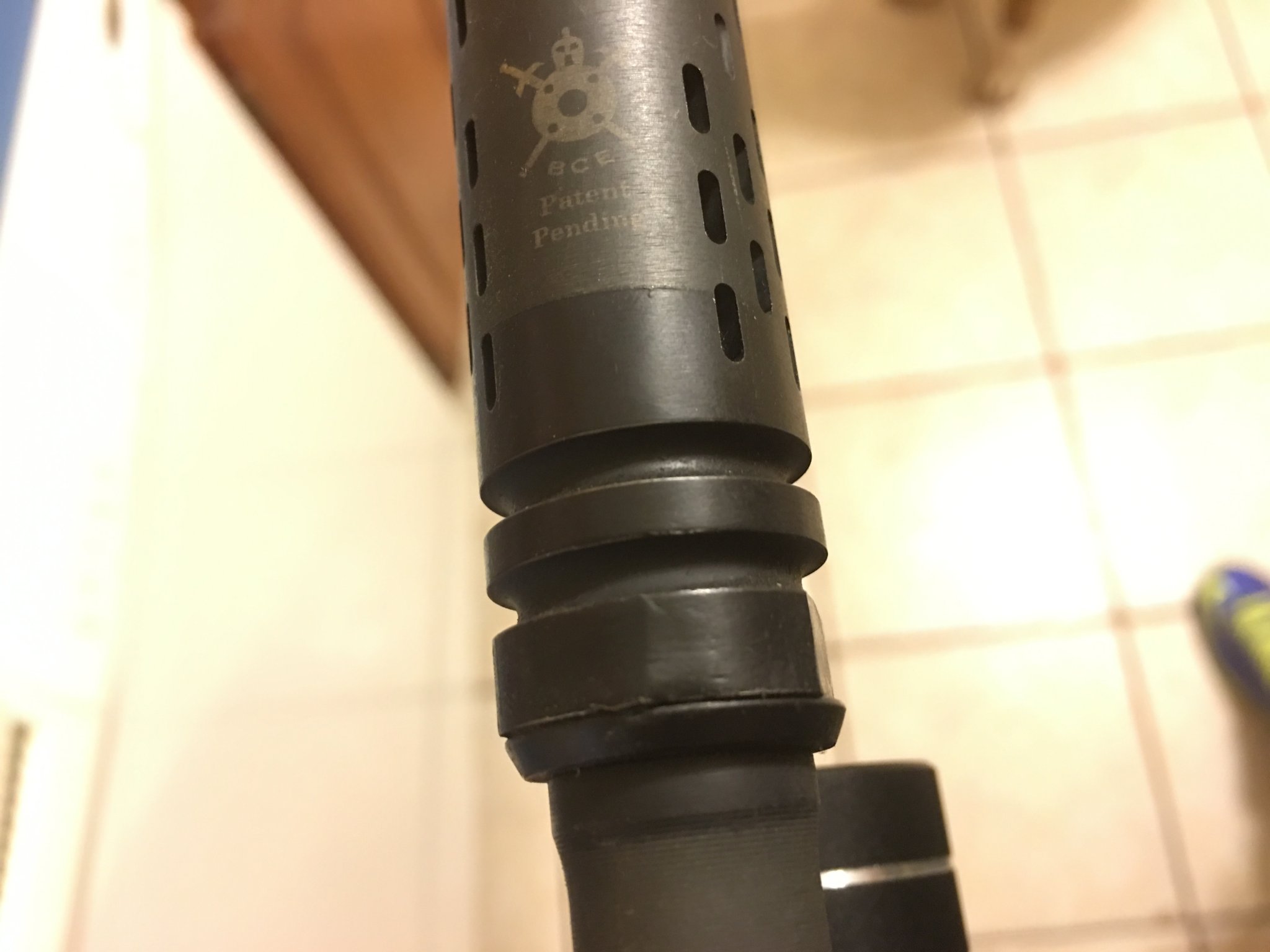

Hell here’s one I did myself. I took a drill bit and marked how deep I wanted to drill into the barrel. Cut the drill bit off and stick it in the hole into the barrel through the brake. Then welded the drill bit in place so it’s capturing the brake and the hole in the barrel. Grinder it down with a sander and painted with hi temp paint.
Have shot the hell out of the 14.5” without any issues. Coming up on changing it to a 13’7” and will be doing the same set up with a different brake to accept my suppressors.

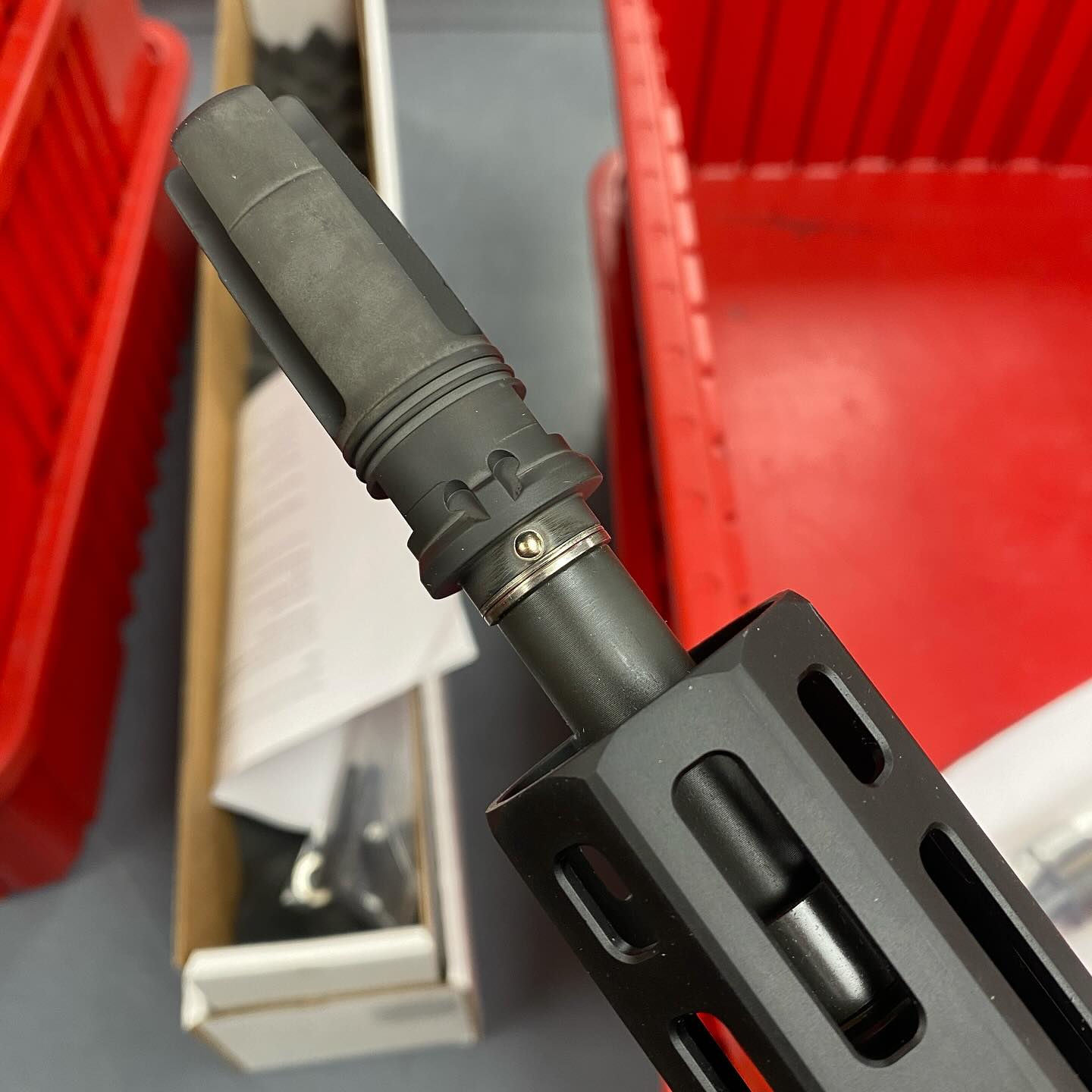

I did one for someone, generally im pretty precise and detail oriented TIG welding, in a previous life I had every weld cert except underwater. ... but he put in a broken drill bit in as a pin and wanted me to put a small tack weld on top. 1. The pin being a different hardness or material is a pain in the azz., wont flow the same or melt evenly. 2. The ridge that its on, same as yours, concentrates all the heat..... pain in the azz. It turned out about the same as yours.. couldnt get 100% of the coating removed, that makes it worse. I was going to sand and finish it more but then he said if you hide and smooth the weld it might not look welded, and the entire idea is to make it look welded to be legal... so I guess having it look like its welded is ok.
Best place to drill the hole to pin it would be on the flat for a wrench, not near an edge. This would create a better area for a weld. Then us a pin made of the same material and leave it out 1/16 of an inch.. all you'd need to do it touch it with a tig welder and it would be perfect.
