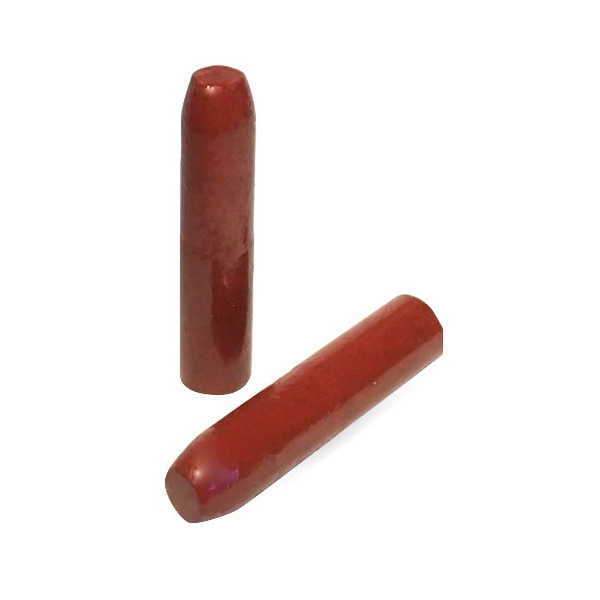

What about ACME 30cal.309 265gr 300 BLKOUT BULLET COATED $.30 each with Trail Boss powder? Is Trail Boss the right choice for the limited case capacity?
Can anyone calculate a load for this at 1050fps? Or is it simply not practical or possible?
