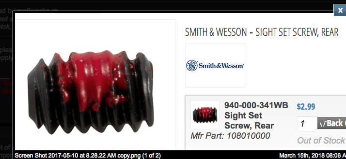

An example of Nylok, note the application is not circumferential on the fastener threads rather it acts like a soft hydraulic compression (spring-like as LongRifles discussed); Vibra-tite is best applied in a similar fashion.

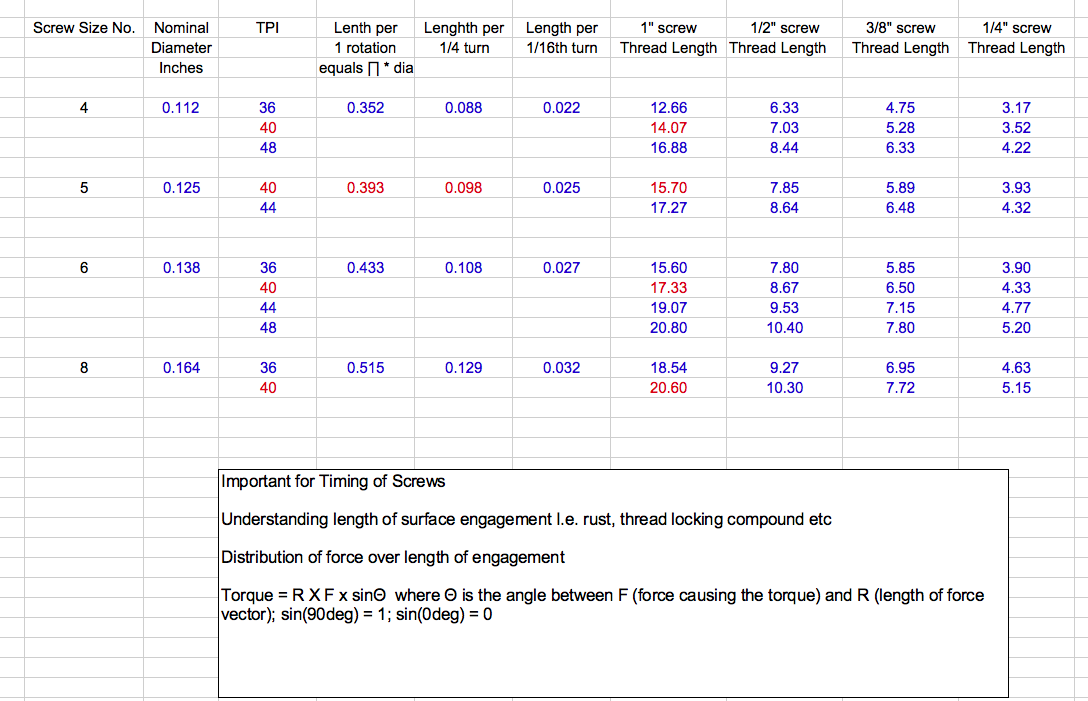

A few years ago, I made this chart as a self-reminder and interesting to choose fasteners based on length and TPI when an option as you can see length of fastener thread engagement changes quite dramatically, usually for the better, as TPI increases.
