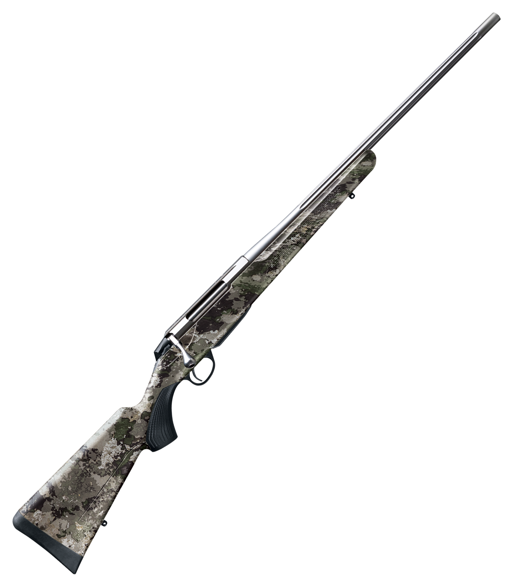

Random superlite for comparison. Note where the flutes start and end.
Wall thickness on a 1/2-28 for a 243 looks right at 0.107".
