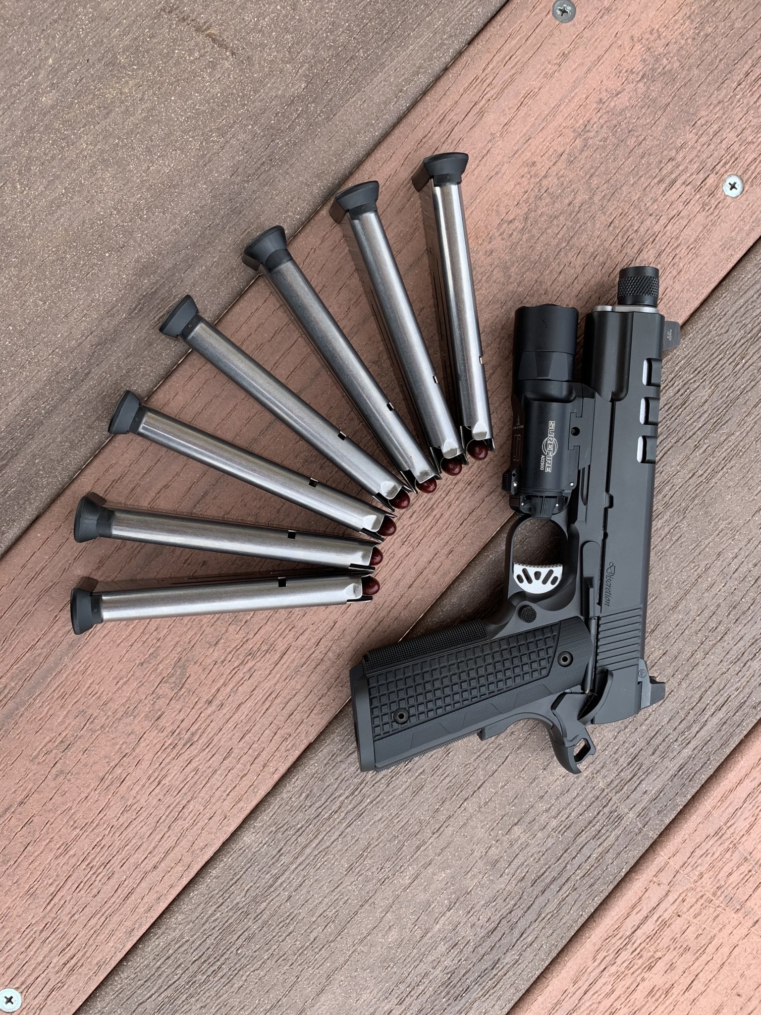

I hate it when threads end with no conclusion, so here goes:
I bought the Nighthawk Custom drop-in barrel. It was not exactly "drop-in". I probably should have taken it to a smith, but I'm a stubborn DIY guy. I read a lot about it, used a small diamond file and went very slow, with many test fittings. I had to do some fitting of the hood and both top and bottom lugs. I believe I have it just right. Everything fits and functions very well, and it shoots great.
