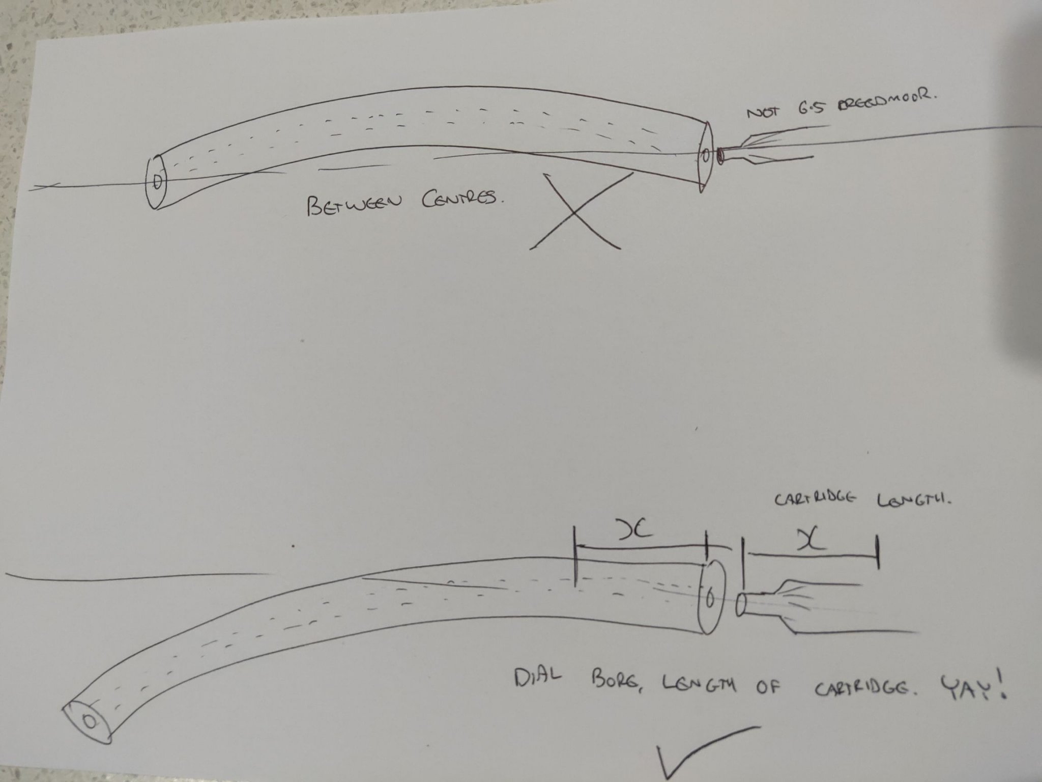

    Pro tip. You only want the chamber concentric. You don't want the muzzle and chamber to be "concentric" in the way you think.
    Get an old barrel, put 2 bricks on the ground, and place the barrel on it so one brick is under the muzzle, and one under the chamber. The barrel should be supported at each end.
    Hit the middle of the barrel with a big hammer, or stand on it so you can put a bend in the barrel. If you were to lay the barrel on a flat surface and roll it, it should have a noticeable wobble or "lump" in it.
    Now dial that up. 2 methods exist.
    The first being dialling between centres. It may look ok at the chamber and muzzle, however because the barrel is bent, the reamer will go in as a cork screw.
    Another method is to dial in the chamber end, and about 4" Infront of the chamber. This is the path the reamer will follow. The reamer will be concentric to the bore. This is desirable.
    Here, have a shitty drawing.
    Maybe I’m expecting too much. After dialing in a couple of places on the grizzly rod maybe I shouldn’t remove it and then replace it to make certain the previous readings were correct. It’s always a slightly different reading when I do that. I’m not a machinist or gunsmith so I always measure at least twice.
    I’m pretty certain the reamer is gonna follow the bore unless it’s an extremely rigid reamer holding setup. However all bores are slightly banana shaped and slightly off center. The initial clean up turning between centers should cause the OD to be concentric to the bore/id.
    Like I mentioned before I’m not an experienced Smitty so I’m asking for clarification more than making statements of fact.
    You should just dump the grizzly rods. Even Gordy Gritters who popularized the grizzly/range rod says that they're good for rough dialing a bore in, not for final dial which should be done with a long reach indicator.
    It appears you haven't read the 130 page PDF with a bunch of high profile gunsmiths saying how and why they do their process, its worth the time to read it all - a bunch of your questions are answered in there multiple times (and with different solutions).

    Pro tip. Many people are probably bending barrels when working between spiders to try to get a "straight section" of bore for the chamber. A relatively small diameter bar being jacked around between two points about 20" apart is a recipe for a false sense of security.
    Wonder if anyone has gone back to check their "straight bore/straight chamber" when the barrel is free hanging from the threaded tenon? Wonder if anyone has even gone back and verified their "timed muzzle end" is still at TDC when free hanging from the threaded tenon?

    All good points that experienced Smith's know about. There's loads of "secret" techniques they use, you just have to find a way to give you consistent repeatable results for the job at hand.
