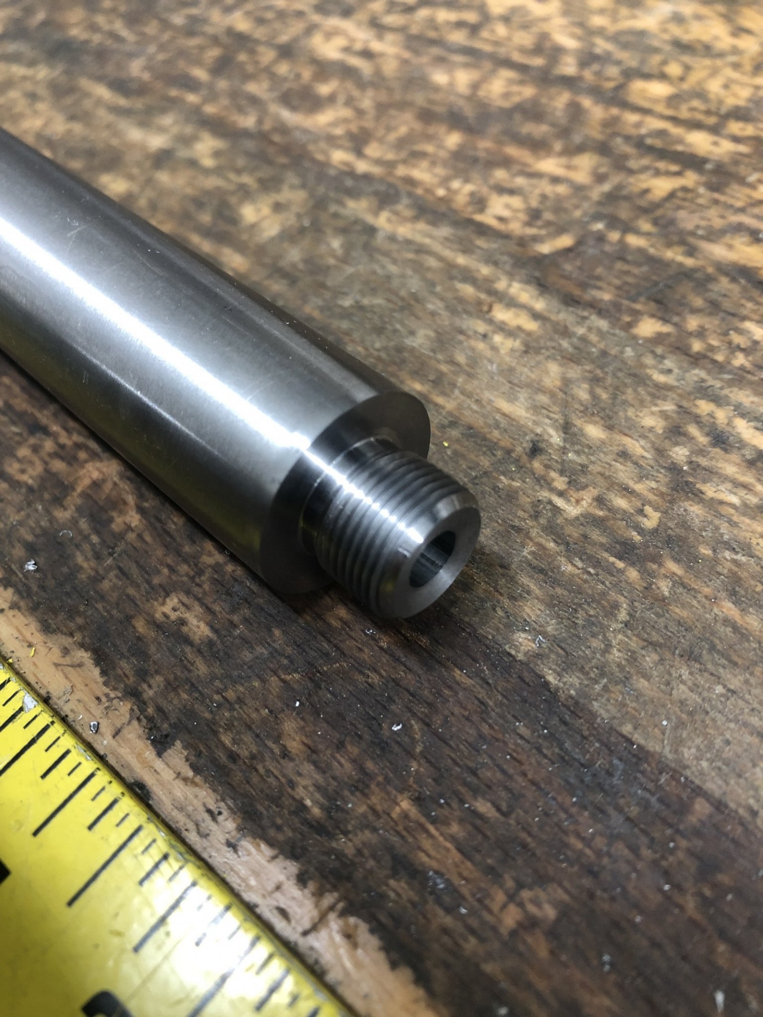

Here is what I've learned after doing this over and over and over for almost 3 decades.
Short answer: Yes, you can ruin a barrel or greatly accelerate its expiration date by threading the muzzle.
Here is why: (last few paragraphs of the LRI muzzle threading listing on our website)
Last, the caliber and cartridge for a particular setup must be considered. As a rule, LRI requires a minimum of .100" of wall thickness between the groove diameter of the barrel and the root diameter of the thread being machined to the muzzle. This value is a judgment based policy as well. A 300-378 Weatherby Magnum is a powerful cartridge with muzzle pressures significantly higher than a 308 Winchester at a given barrel length. Wall thickness should be increased accordingly.
Our experience has shown that a thin wall muzzle has the potential to "bell mouth" over time. When a crown bell mouths, the accuracy of the rifle suffers. You as the user may be compelled to think the barrel "let go" due to throat erosion when it's actually because the muzzle was threaded with too thin of a wall thickness.
When I worked for Dakota Arms/Nesika this was a thing on some of the "boomer" calibers we'd chamber for on the 76 actions. Nitros, Rigby stuff, big WBY's, Lapua, etc. . . When using "spaghetti contour" barrels it was not uncommon for the gun to come back after a few miles for an accuracy issue when it had been fitted with a brake or whatever. It can be one of the most frustrating things on a rifle to try and diagnose. Thankfully we got in front of it shortly after I arrived there in the fall of 2003.
Hope this helps.
