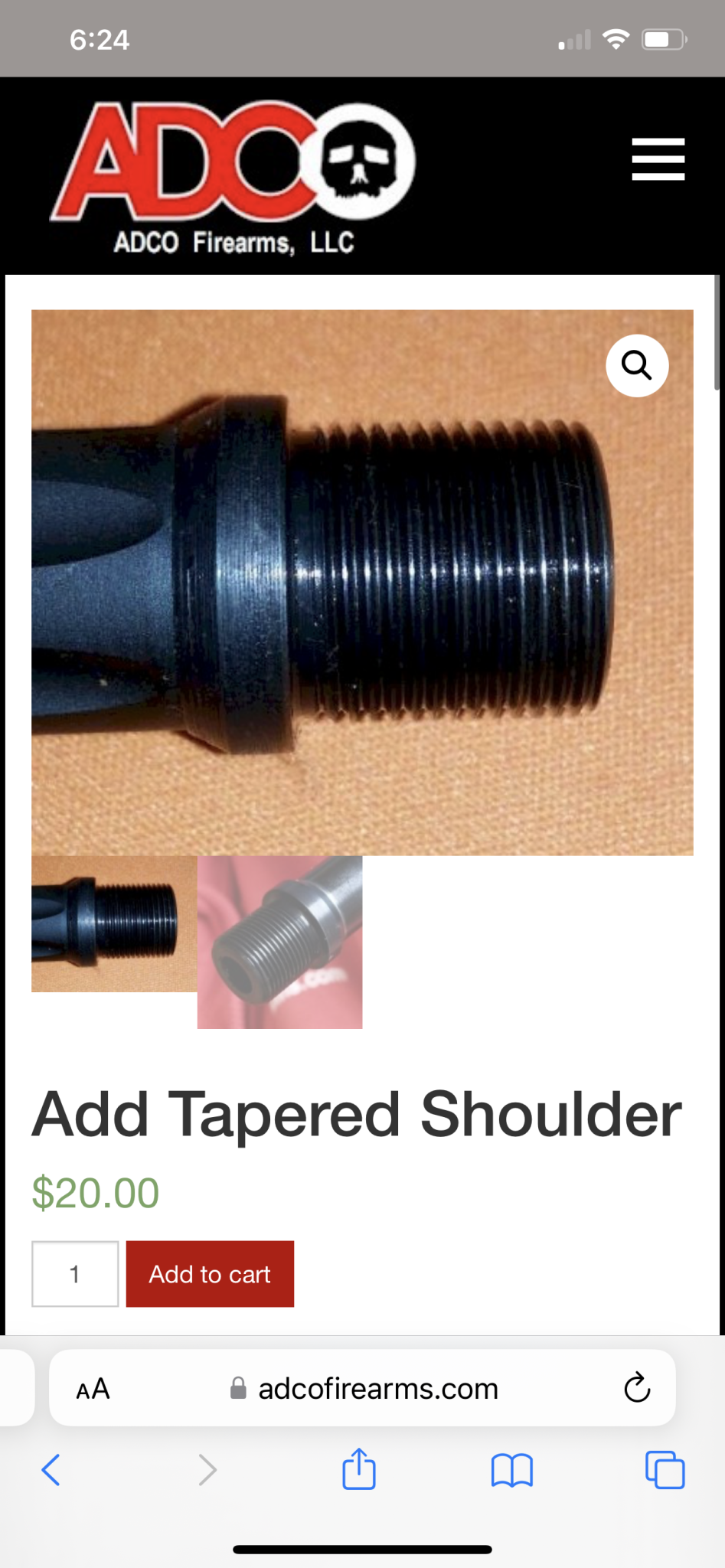

I’d thread it 5/8x24 and have a shoulder added.

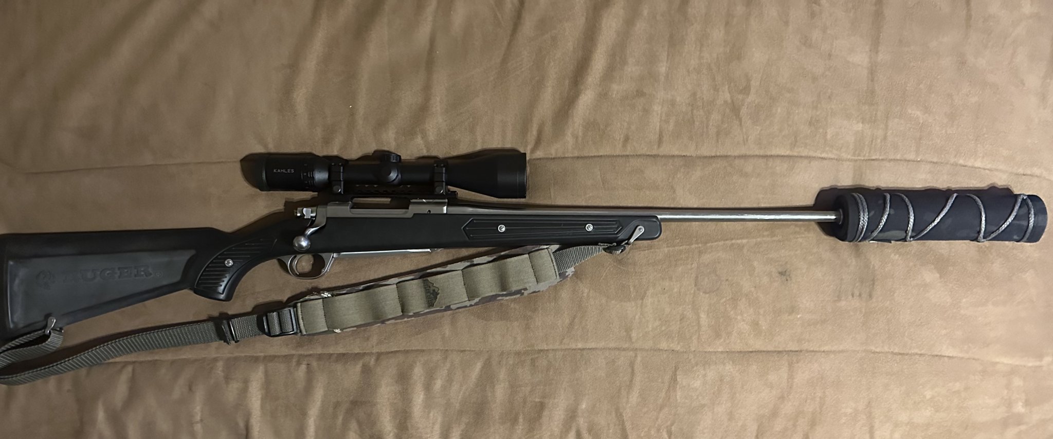

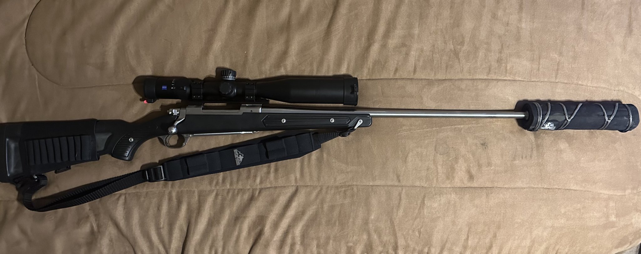

I had this done early last year for 2 old sporter barreled Ruger M77 MKII rifles so I could run suppressors. I had my smith thread them small, then custom make two 416r thread adapters from an old barrel he had laying around, that he permanently attached to the barrels (I think he brazed or fluxed them on the barrel threads). Then once cured, he threaded the adapters 5/8-24 bore-centric, and recut the crowns. Turned out great!
That tapered shoulder is interesting 🤔. Gonna have to look into that.
It is the answer to lightweight barrels if a guy wants larger than 5/8 threads!

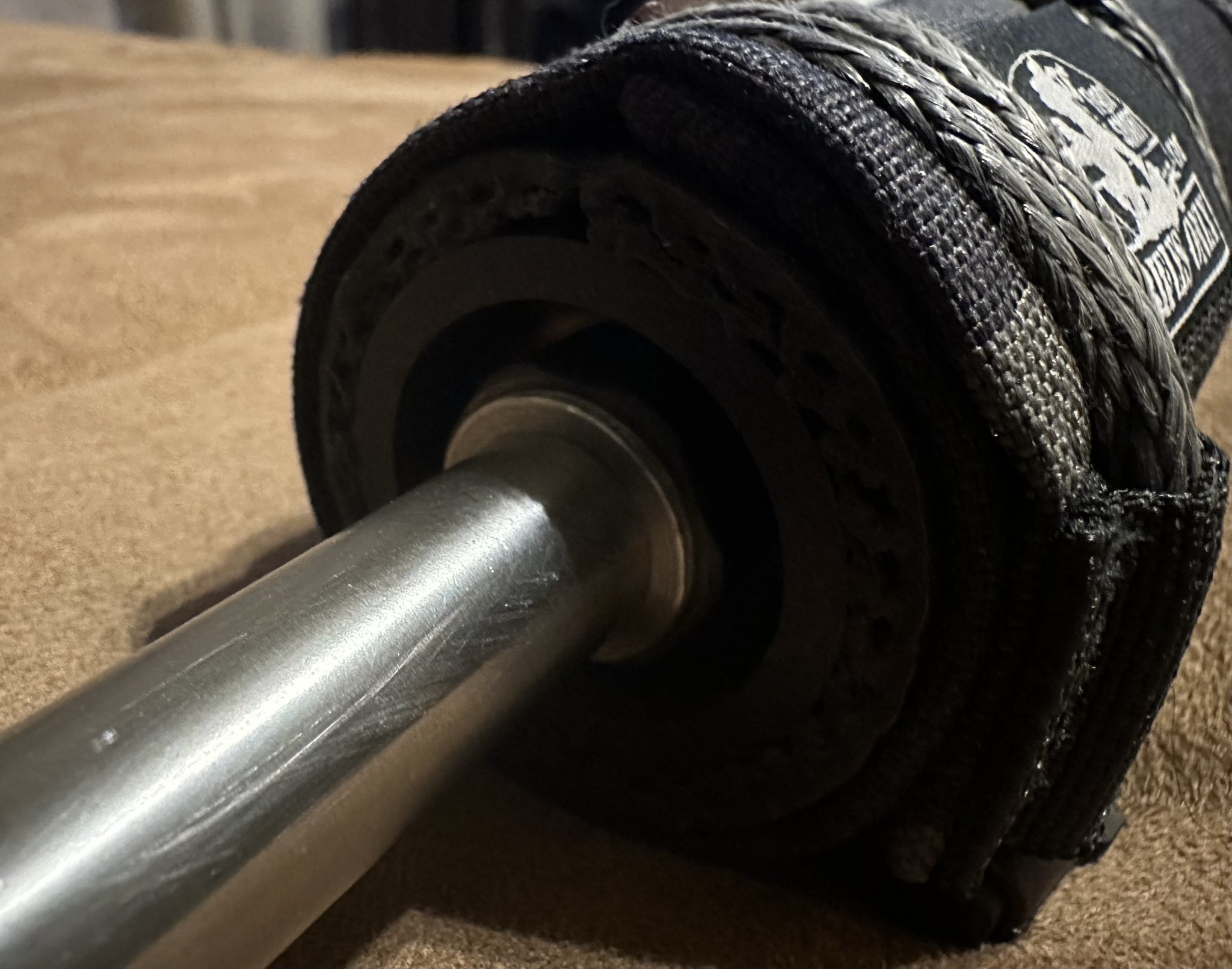

Little too small. Measured my t3x lite.
Legend: .dia {distance from muzzle} (barrel length)
.616 {0} (24.33)
.620 {1.358} (23)
.630 {2.57} (21.75)
.640 {3.81} (20.5)
.650 {5.05} (19.25)
.660 {6.27} (18.06)
Recommended od for 9/16 shoulder .662 {6.625} (17.7)
0.673 {8.08} (16.25)Beyond this point has to be registered as an SBR
At front of tupperware 0.711 {13.33} (11)
Recommended od for 5/8 0.725 {15} (9.33)

Can you elaborate? Too small to go without adding a shoulder yes but that's why i said i'd have a shoulder added. 0.630" is slightly larger than 5/8 major thread diameter. The picture in my post you quoted seems to have a barrel diameter very close to thread major diameter.
What stops the shoulder of the added shoulder?
Measuring the picture and doing some quick scaling, the diameter behind the added shoulder is at least 0.640". That means chopping at least 4" of barrel off.
The t3x superlite in 300 win mag, JRAXSL31R10, is a 24.3" fluted barrel. Chopping 4" off gets it into the fluted section for sure.

Missed this reply. I'm not sure how the various added shoulders are held in place/indexed against. I've asked before and was told at least in one case the muzzle is threaded a little deeper where the additional shoulder is put and it they are rokset (or similar) in place in addition to being indexed against a small shoulder.

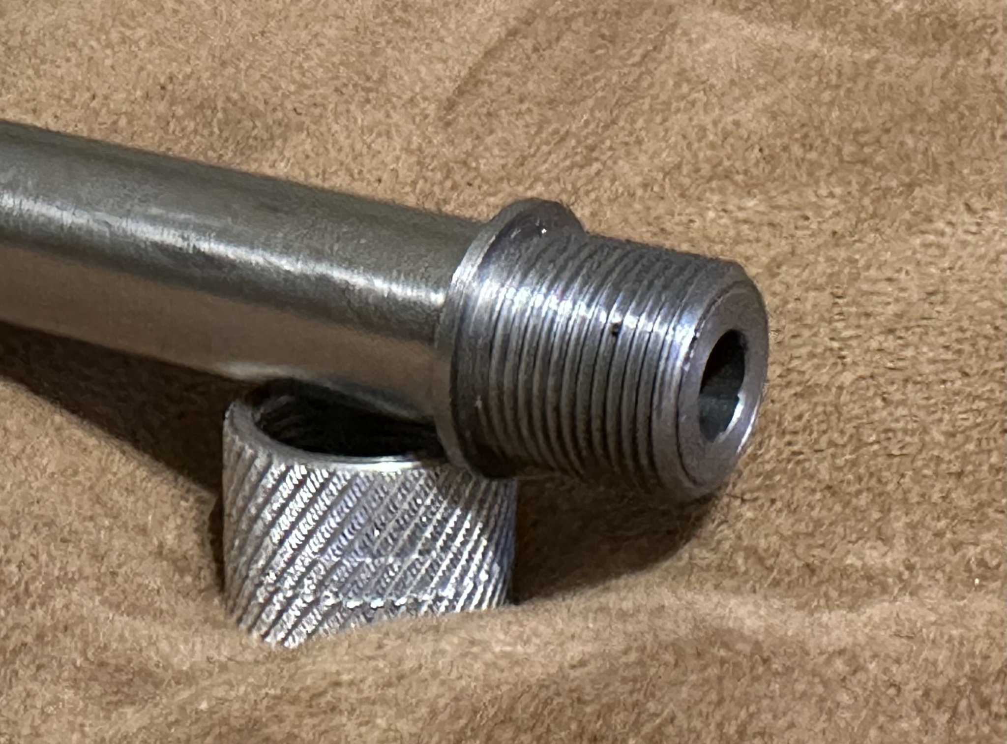

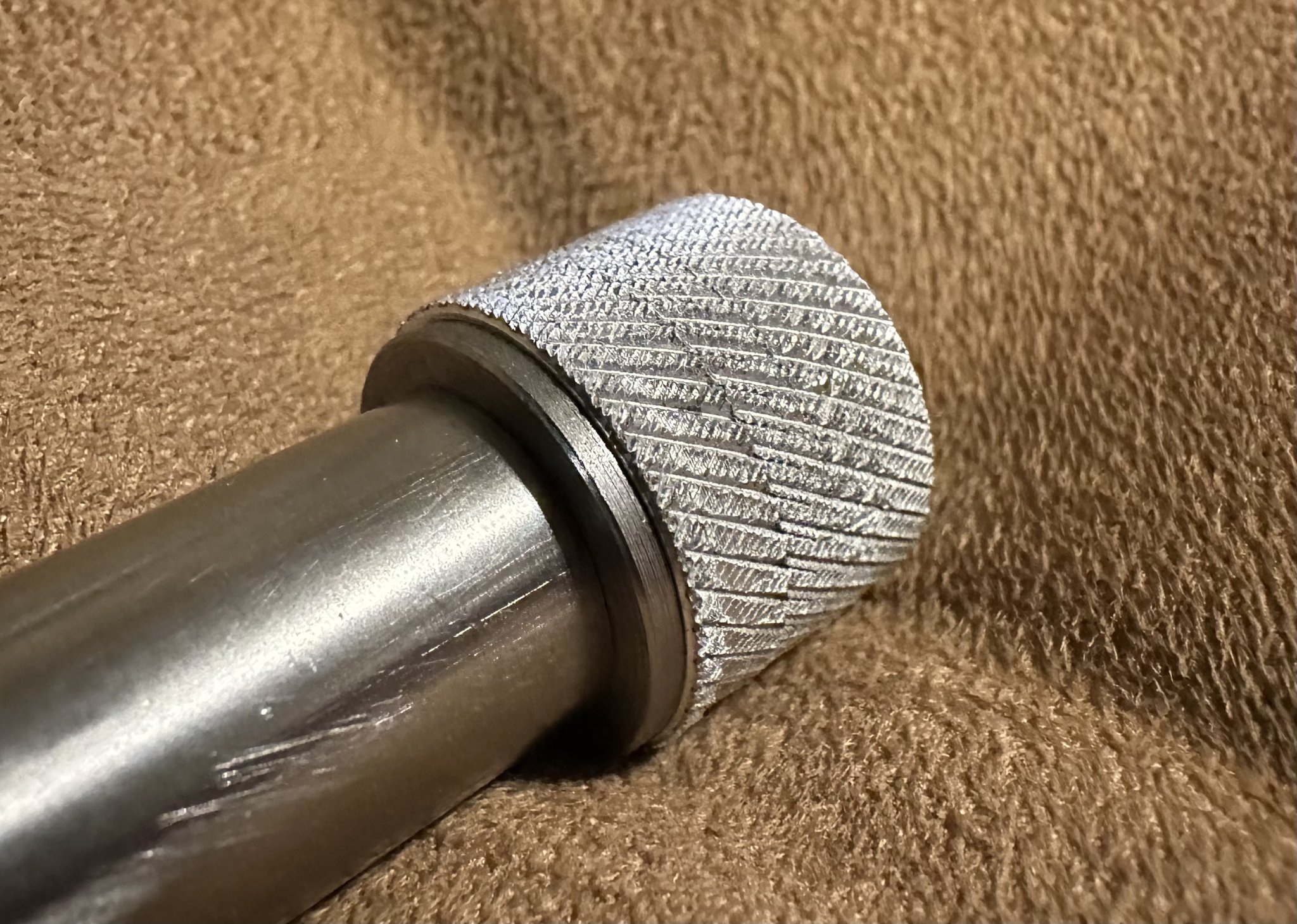

No need to over-complicate it.
.630 muzzle diameter > .625, so as long as the barrel OD is concentric "enough" to the bore it will work.
Cut the 5/8" threads to the tenon length needed for the muzzle device + additional for a thread protector.
Screw on the thread protector, red loctite or Rocksett in place. Turn it down/contour/blend and face the end so you have a perfectly square shoulder.
